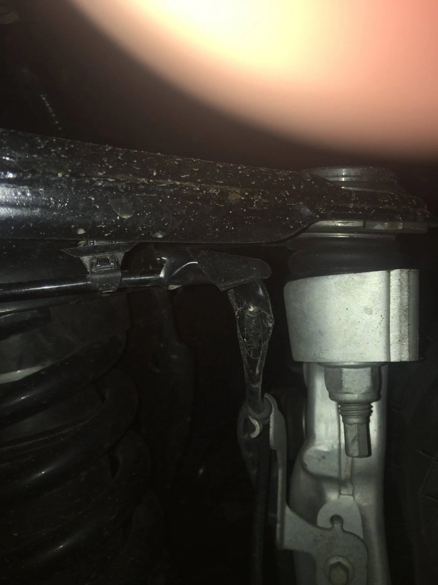

Well, I started wondering today. Seemed like it happened every time I backed up and turned my wheels left. Got under the truck and found this! Electrical tape and broke wires on the sensor! Wonder if warranty will cover that? I sure didn’t do it, and have no idea who did it. I just bought it 3 weeks ago.

Great find man! That is something you could probably fix also if warranty doesn't cover.

Good find. Now all they have to do is fix it.

figured I could splice it and use tubes. But, where it’s at it bends there where turning. I may be able to loosen the clip and make it work. I’ll see what they say at dealer.

Good find! I like the idea of them replacing the harness entirely. See what Ford says. I'm assuming it's under warranty. I wouldn't want some half ass repair either. The correct repair or harness replacement could last the truck for it's lifetime. A shadetree bubble gum and popsicle stick repair could haunt that truck for a long time. Who knows why the truck was sold after 2k miles in the first place.

Good work to diagnosis the issue. Thanks for the pictures. A bit of peace of mind

Yea, I wouldn’t splice it and leave it. Only if they say the part is not available, just a temp fix. I have heard parts are hard to get at the moment. Hopefully they will have it and warranty covers it.
