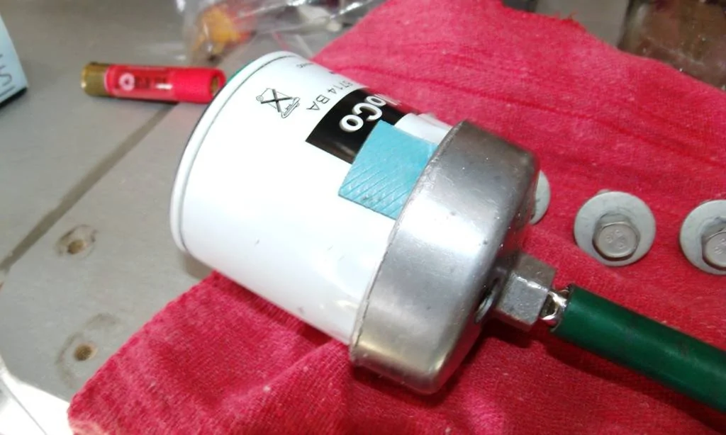

76MM 14 Flutes is the exact cap that fits the 910S. Mine is a Steelman cap.
It removed the factory one, and one was not needed to reinstall it by hand.

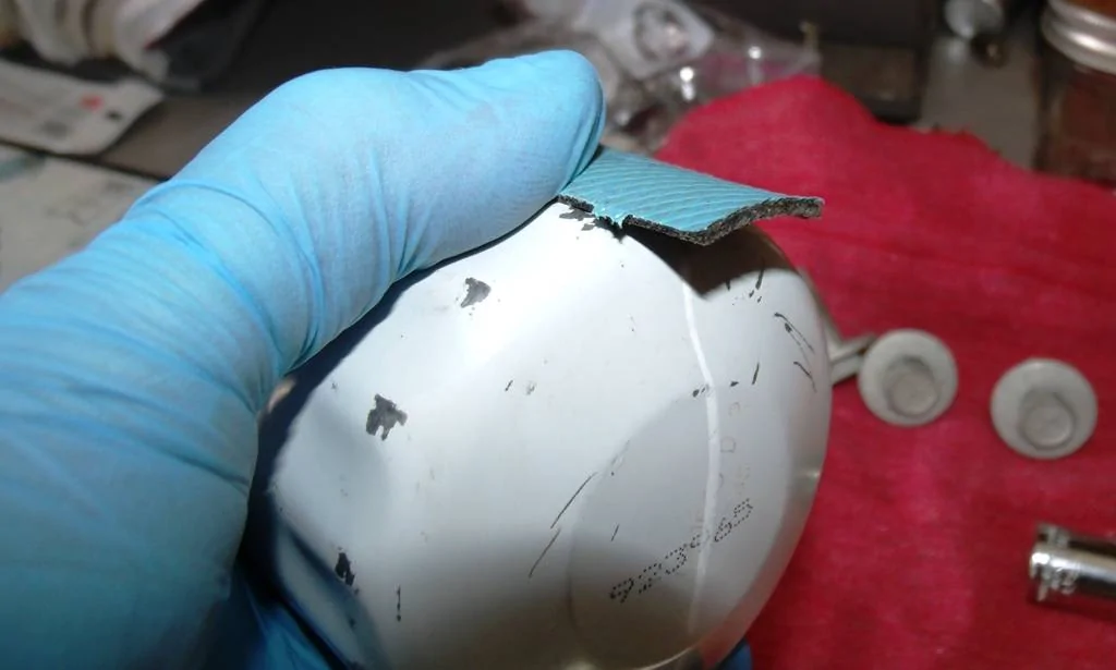

The factory filter is slightly smaller. My filter socket spun until I put a piece of thick rubber tape between the filter and the socket.
Probably has to do with the tolerances of the filter socket.... but, again, the factory filter is slightly smaller.
