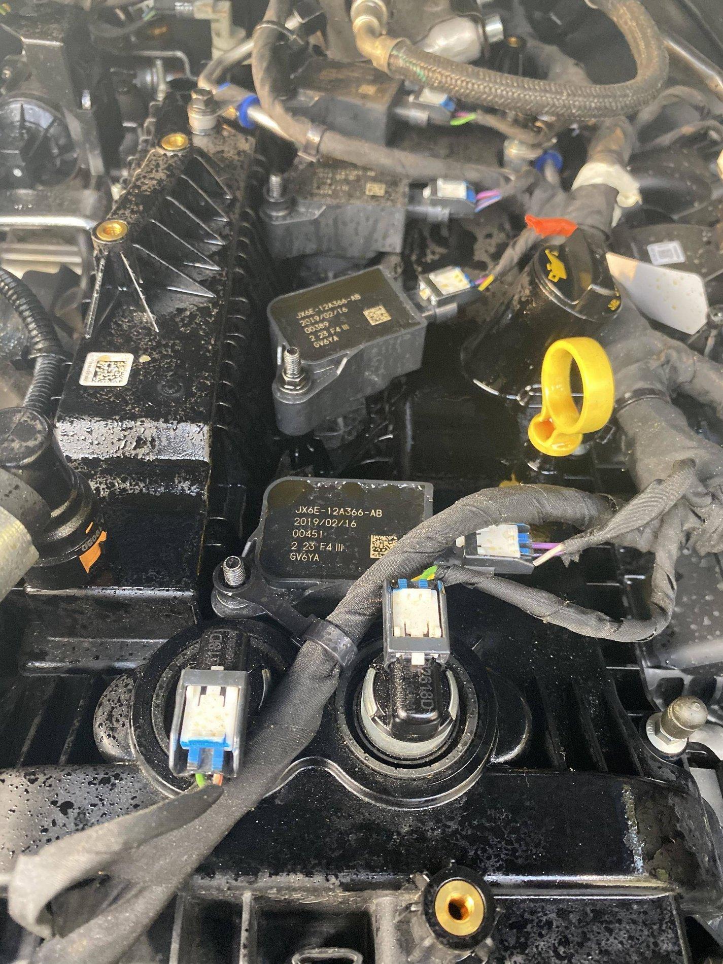

I took my truck in for my complementary 1st maintenance yesterday. Long story short, I popped the hood this morning and the dipstick was unseated from the manifold, and oil has sprayed everywhere.
I called the dealer, and am bringing it back in Monday morning.
any advice on what I should ask for? I know motor oil is extremely corrosive. Should I be worries about gaskets, coil boots, hoses, belts etc?

It will be fine. Oil is not corrosive. If left a long time it could affect rubber parts I suppose. Why not use a little simple green at the car wash.

Have the dealer pressure wash the engine compartment...you should be fine

Engine oil isn't particularly corrosive, but I'd definitely make the dealer clean the engine bay.

i would avoid the pressure wash. dont want to push any water past the seals, or the connectors. Good soap spray down and a low pressure rinse would be smarter
lord knows we already have enough wonky connector issues going around.

You dont know......oil is not corrosive.
If anything, wherever the oil is, thats where the rust wont be in 5 years.
Nothing is hurt by oil spray.

Just have the dealership steam clean the motor. Years ago I took my Dodge Ram in to the Dodge dealer to have the transmission flushed. To do the flush they disconnected the lines going to the transmission cooler. They didnā€™t properly seat one of the lines and it popped off. There was transmission fluid everywhere under the hood. After they steam cleaned it, you would not have known that a drop of ATF spilled. In my case I got lucky that the computer shut the transmission down before it was damaged.

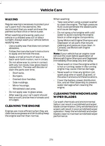

I never said it was corrosive. You act as if everything under the hood is just metal. Get under the hood with a power washer and you can bet there will be even more issues related to water intrusion / penetration into electrical connections. They even make note of that in the owners manual, see below.

Actually the Owners Manual warns about pressure washing the motor and the possible damages that can occur, how you have to cover the battery, power distribution box, air filter, coils, spark plug wires and spark plug well, etc.
And I would be surprised if the dealership does any of that. They'll have the new guy that works at the wash rack pressure wash the motor, and won't cover up anything.
