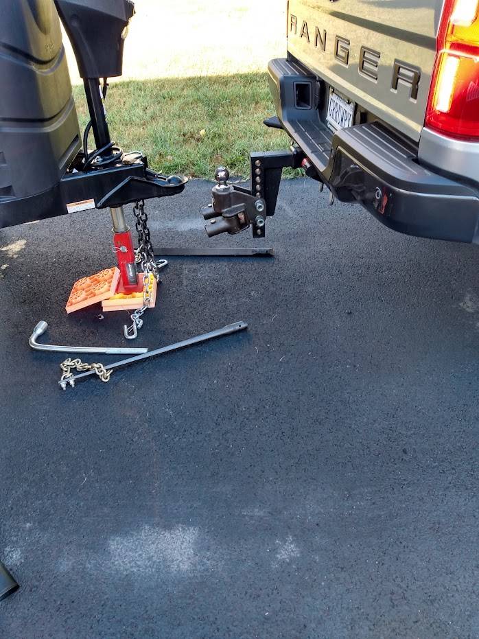

Your WD and Sway control of choice?

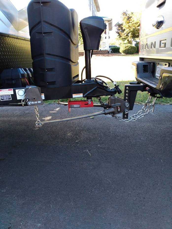

Thank you for your reply, you've confirmed my choice of the Andersen!
I just received my Andersen hitch today! Unfortunately I won't have time to install it until the middle of next week.

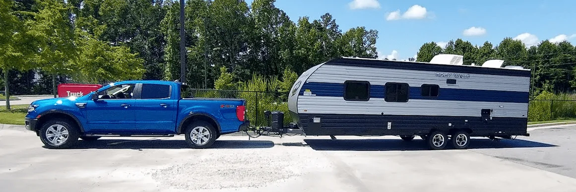

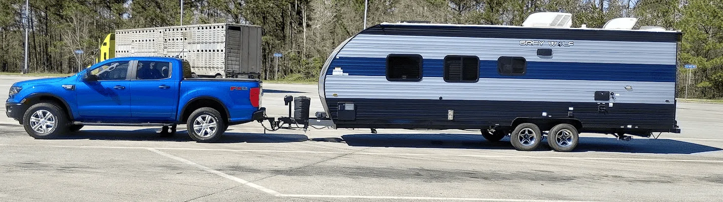

Our Rangers sit quite high in the rear end, so you've usually got to get the ball down level with the travel trailers hitch and there's not enough adjustment in most all of the standard shanks to get that done.
Standard Shank / Extended Shank
Standard shank on lowest setting, trailer is still nose up:
Extended shank, trailer sitting level:

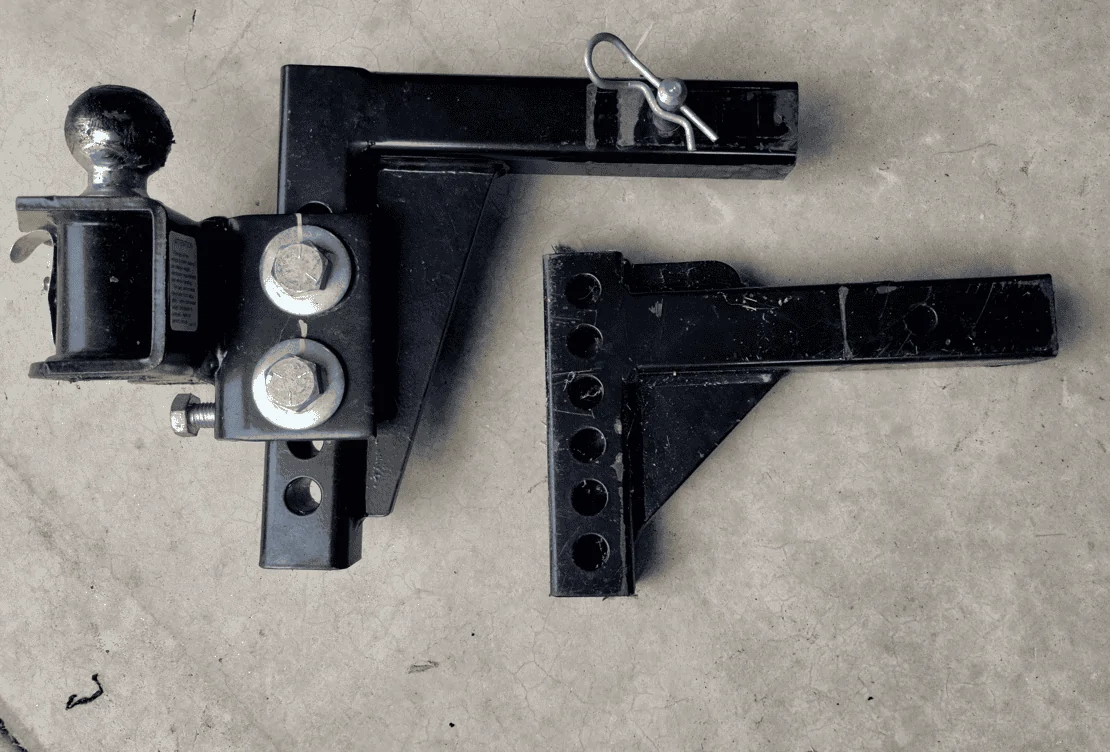

Shank pics, how masculine to compare, here is mine and it may be longer than yours . When I towed my TT with just a standard u haul shank the ride height was a pretty good match as the nose was slightly downward, the NOBO 19.5 has higher clearance and the hitch height is ~ 19" so lined up nicely with the Ranger's , with the E2 7 hole shank I should have even more height options.

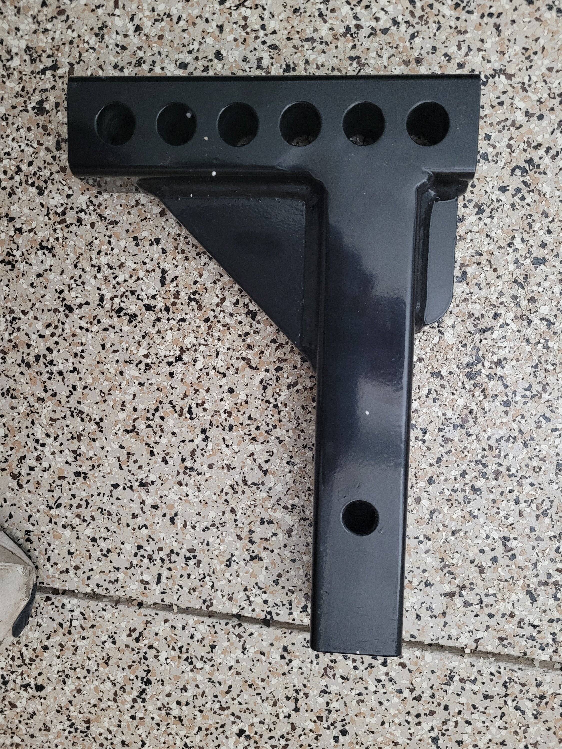

You both are lucky...I had to get a 10 hole shank to get the hitch head low enough. 2 wheel drive, but have a Roadmaster Active Suspension System on the back which raised the rear 1/2 inch, and slightly larger tires, another 3/4 inch.
Pulling out in the morning...will take a pic of my setup.
5,892
29,368
Here's pic of my LOOOOOONG shank compared to your "Short Shanks" :crackup:

Nice setup Steve! WOW that is a long shank. Have a great safe trip.
