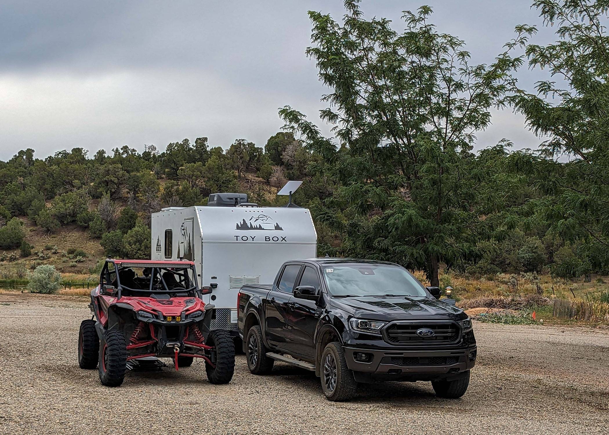

I researched anti-sway weight distributin hitches extensively when I wanted to get one. I opted for the Andersen. It has worked out amazing well and no need to disconnect anything when backing up. Keep in mind, it is counterproductive and a PITA if you have to disconnect to back up.
btw, I am approaching 6k lbs. fully loaded with sxs, water and supplies along with a fully loaded bed.

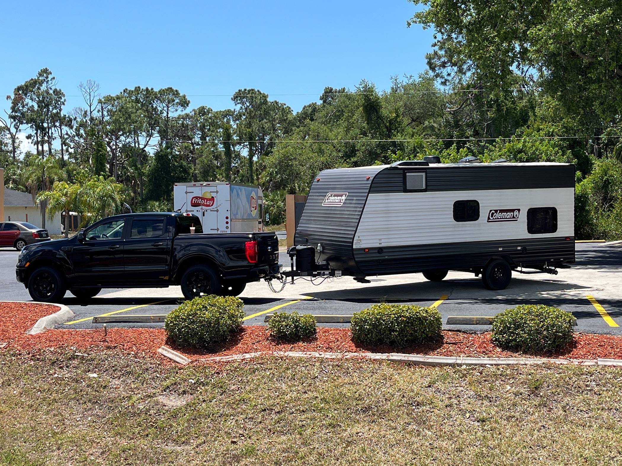

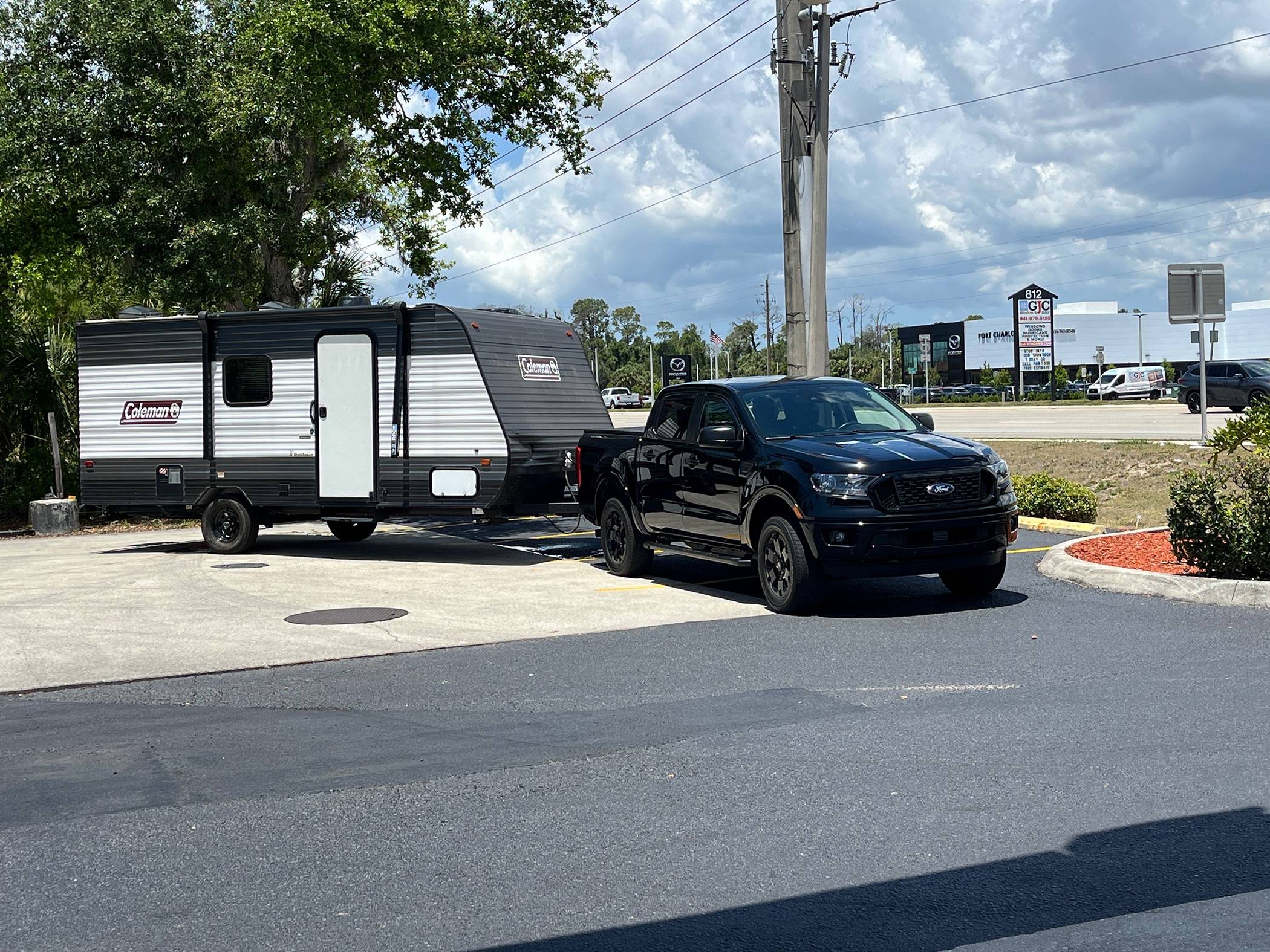

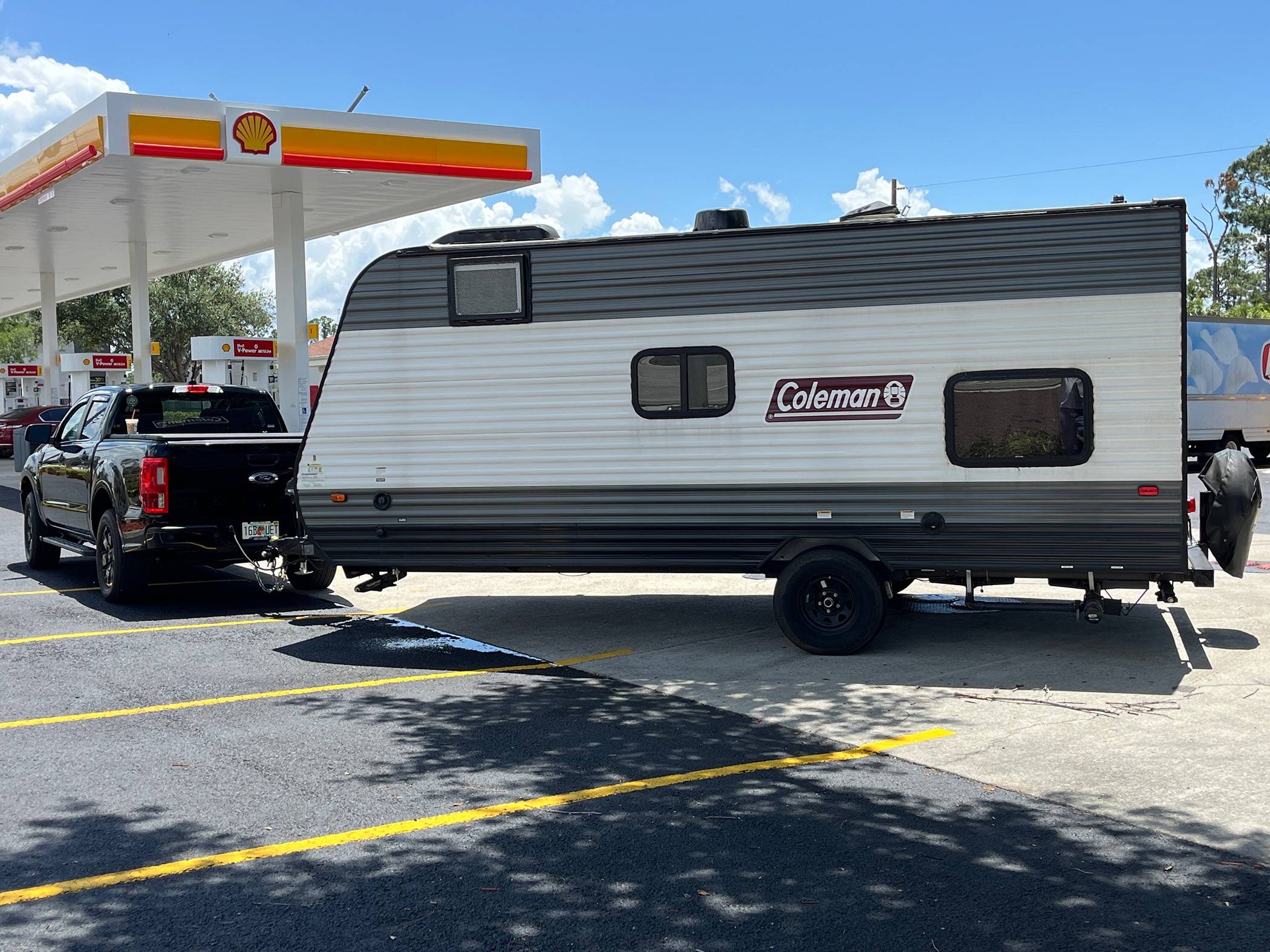

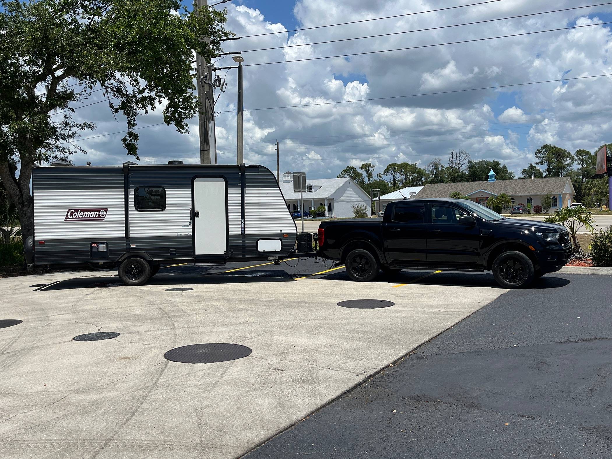

Just for reference the E2's do not need to be unhitched to back the trailer. Unfamiliar with other setups.
Big Blue
Lee
May 5, 2020
3,942
9,420
Retired mechanical designer
It is usually the friction sway bar used with hitches that do not have built-in sway control that need to the disconnected when backing.
My Husky Centerline TS does not need to disconnected either.
