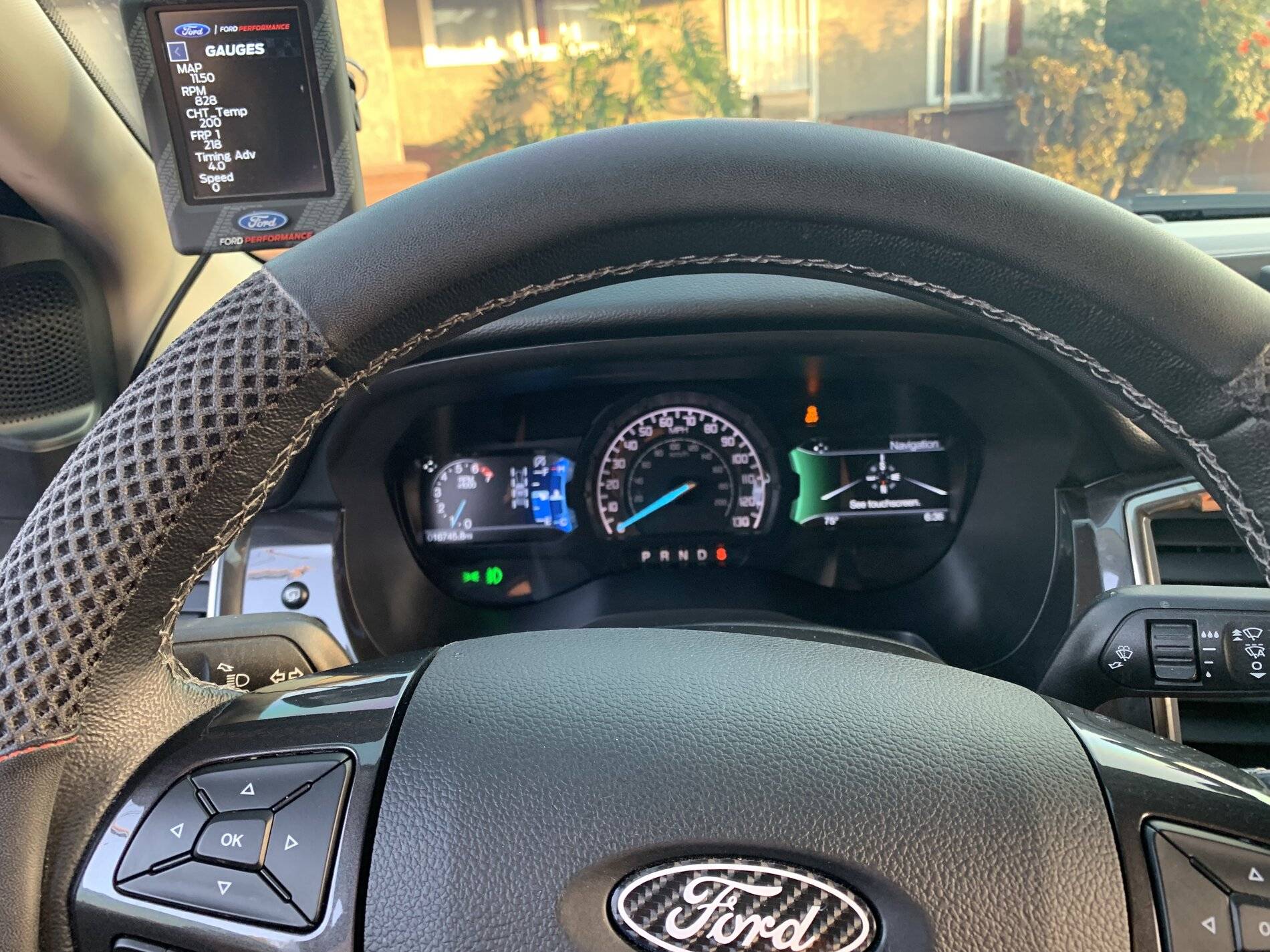

Thinking about doing the same, where did you order your XLT cluster from?
@Bludrok solution makes complete sense but here’s another solution or thought process… can see everything you want and more. Get benefit of added power unless you really don’t want a tune for whatever reason.. even though Livernois offers very safe tunes with lower octane too.
Ive actually got my Livernois tuner mounted in the same place and on the gauges page as well, thanks for the suggestion though! Just more of a fan of the XLT cluster than the Lariat.

Can you elaborate on your tach solution? What does it look like?
What functionality of the Lariat cluster do you not want to lose?
I have the Bullydog tuner and it shows me a 4-digit tach. Literally just shows the numbers "2200" on the screen.
Just like this

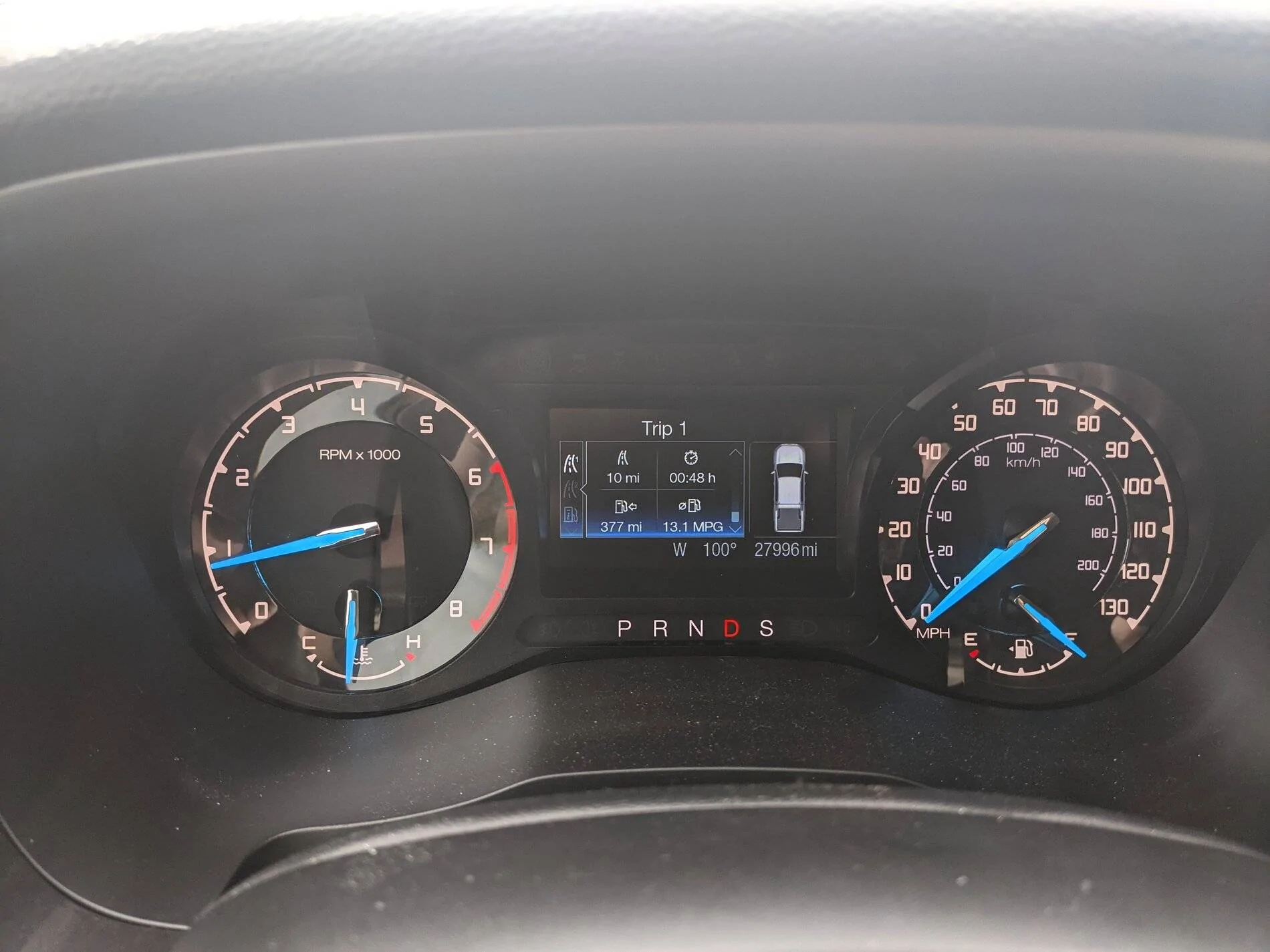

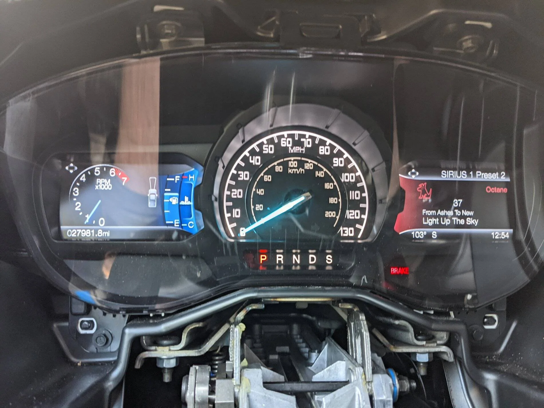

Wanted to follow up on this, ended up trying to send the replacement XLT cluster off to have the odometer corrected and brought up to my truck's mileage, however, the service I chose said they didn't have the ability to change mileage on our clusters after receiving it. So for the hell of it, since it's a simple swap, I swapped the XLT cluster in again once it got back and hooked up Forscan and went to change the mileage and received the same error while failing at 2%. At this point I assumed it just wasn't going to work but still wanted to change a couple other things in Forscan before shutting everything off so I wrote those changes and then the cluster rebooted itself (may not be the correct description) and lo and behold once the cluster was back up it had my matching mileage with the truck. Not 100% sure what I did specifically to get it to work, maybe attempting to write the mileage was actually successful and then writing the other changes in Forscan made it stick after rebooting? My backup plan was to buy a higher mileage cluster and just drive till I met the mileage. Here's the before and after and I'm pumped to have a full tach and speedo now as well as easier to read temp and fuel gauges.
That's awesome! Can you tell us what happens with the right side steering wheel controls? Are they just dead now?
