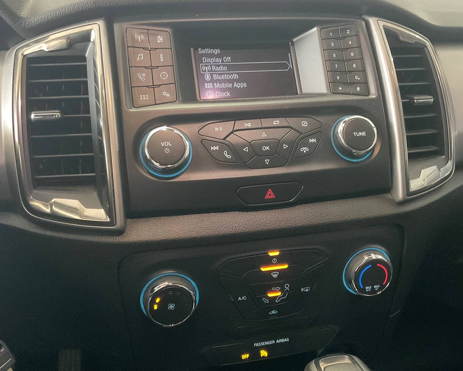

So my ranger currently has the basic gauge cluster. With the small pixelated screen, the only problem is that when the weather gets either too hot or too cold, the screen glitches and doesn't work right. The pixels die and appear black or the screen displays the wrong info. I was wondering if I could just take a gauge cluster from a higher trim level ranger and swap it in. To try and kill two birds with one stone so to say. Fix a problem and upgrade at the same time.
Are you referring to the infotainment screen (above the radio and heater controls) ……
or the small screen on the instrument cluster?
* XLT version shown - your XL might be different.
The small screen on the instrument. Thats the cluster i want to upgrade to if that helps.
