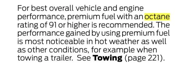

I’m currently running 91 because of the hot summer months here. The manual recommends 91 during hot temperatures use. As soon as it cools off I’m switching to 87. 91 prices has been killing me.
I get better performance and milage on my Suzuki V Strom (V-twin 650cc) with 91 oct than with 87 oct. The main reason I do is because 91-oct is the only no-ethanol fuel in my area, and my Butt-O-Meter detects an improvement in performance, real or imagined. Besides, I get 60+mpg so the extra ~70¢/gal. doesn't amount to much. In my Ranger, I fill with premium if I will be towing, and/or driving 75-80 in hot weather or hilly terrain.
91 octane: 32.8mpg X 18 gallon fill= 590.4 mile range vs 87 octane: 32.5 mpg X 18 gallon fill= 585.0 mile range so it's not worth it to me to run premium all the time in the Ranger.
