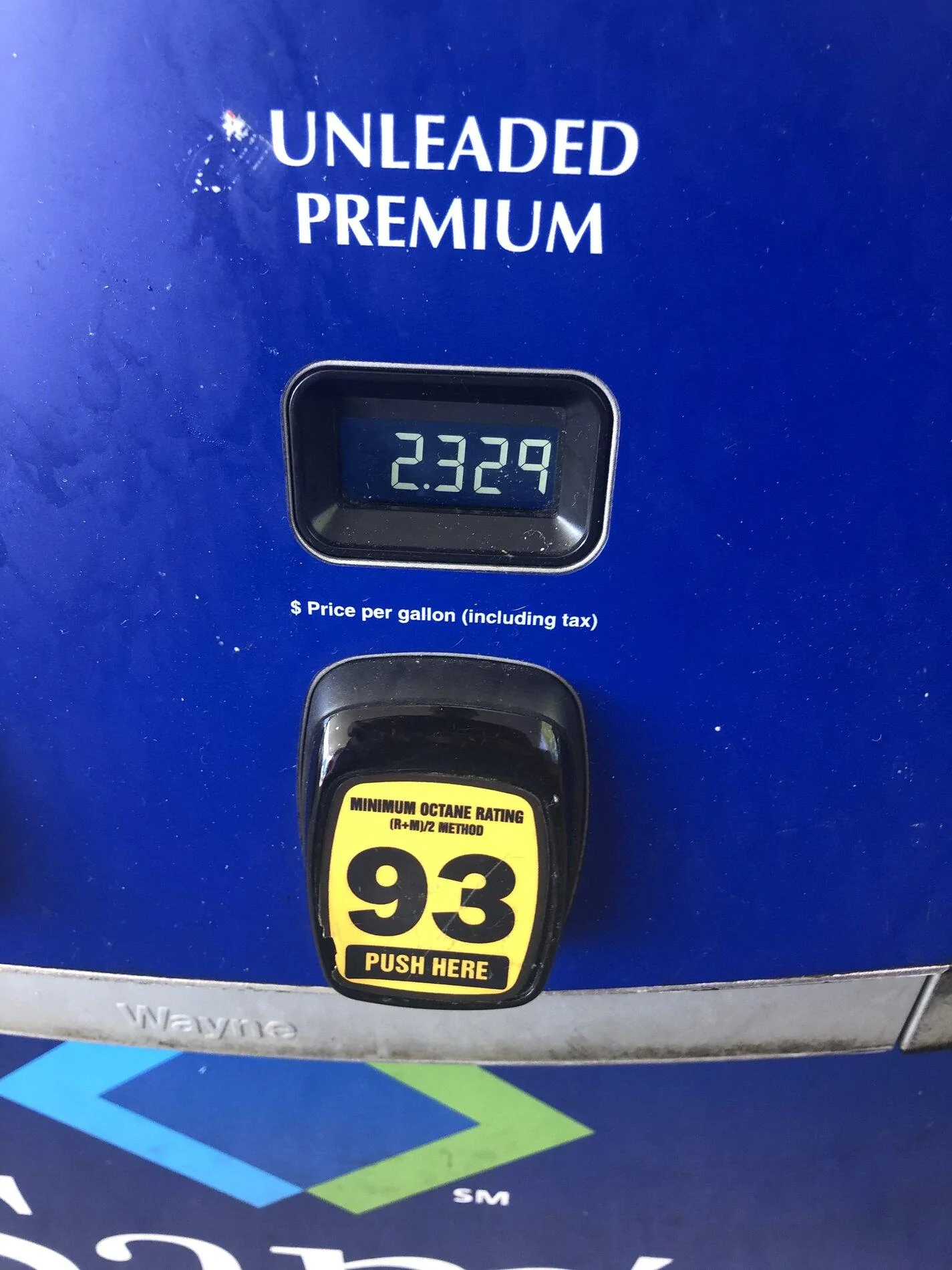

Good Morning All,
So this is the first vehicle I have ever had that I have actually read the owners manual cover to cover. In the manual it states to run 87 octane fuel in the truck. Easy enough to do for the lower elevation folks as that is your regular fuel. For us here in the mountains, our regular octane fuel is 85. Just wanted everyones thoughts on the 85 octane vs 87 octane? Here, 87 is obviously the "plus" gas, so it's 10 or 15 cents more per gallon. Not a big deal if that saves the turbo, which is my concern. I had a 2014 Escape before I bought the Ranger. I had it at sea level for two years, then moved out here. I was told by numerous places that I took it for oil changes that the turbo was leaking. Always just used 85 octane in it....now I am wondering if using 85 had something to do with the turbo issues.
Sorry for the rambling, probably could have shortened that post.....
I get/use 93 from Costco 20 miles across the river in Iowa for $2.05/gal last fillup, Sam's is 1/2 mile away from Costco and it has 91 for the same price as 93 at Costco. In the wonderful state of IL where I live 87 is $2.59/gal.
