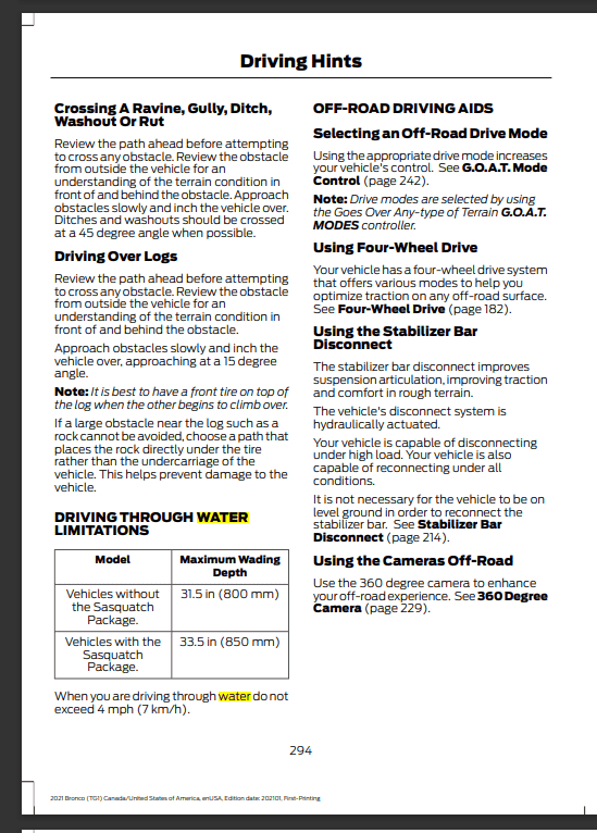

So wait, how is the Bronco sold as having 33" of water fording ability if it has the same stupid alternator placement?
Ford states in the Bronco owner's manual that with the sasquatch package (lift and 35 inch tires) you can go up to 33.5 inches of water fording capability and that anything else is 31.5 inches.
It's really weird to me that we get very different rating for the same engine and tire height. There has to be something else going on here.
Having checked out both a Sasquatch and non-Sasquatch, the tires on the Sasquatch Broncos are huge compared to the lesser Broncos. I can see it creating the difference in the fording abilities.
What
Absolutely! 35 vs 31 is massive and justify the upgrades. What I don't get, is the rating for the bronco's that come with 31, 32 or 33 inch tires compare to our ranger's that come with the same size tire. The alternator placement is the same, roughly equal to the top of the tire on both machine but the bronco get's 31 inches and we get bottom of the hub.
Ahhhh. I gotcha!
I was really hoping the Bronco 2.3 came with a better alternator than ours. I don't know squat about sealed units and plumbing them for cooling so I'm doubtful I will be messing with that. Ughhhh. Damn you Ford!

I suspect the difference may be due to the front transmission vent hose placement or the transfer case vent hose placement. I've tried to find the transfer case one multiple times (supposed to be visible in the engine bay) but couldnt track it down.
Otherwise, it's probably an oversight. Ford manuals generally state no water fording above the hub cap on trucks, and only up to the hub cap on cars. (Ranger manual states the latter IIRC, which is lower than an FX4's ground clearance)
