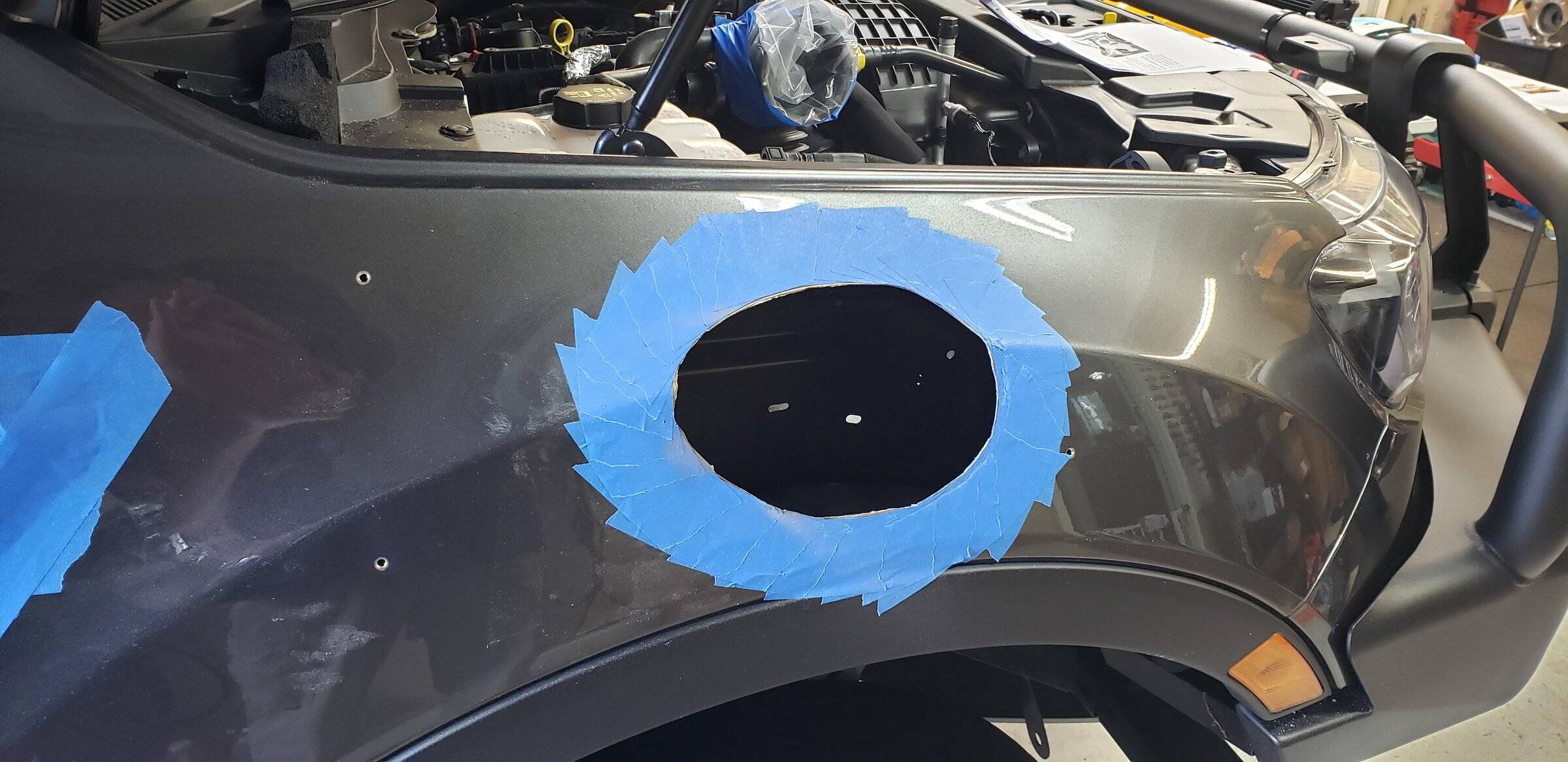

Yep, you have to cut a nice sized hole, as well as drill several smaller holes, including two in the A-pillar, for the Safari Snorkel install. But it was worth it!
