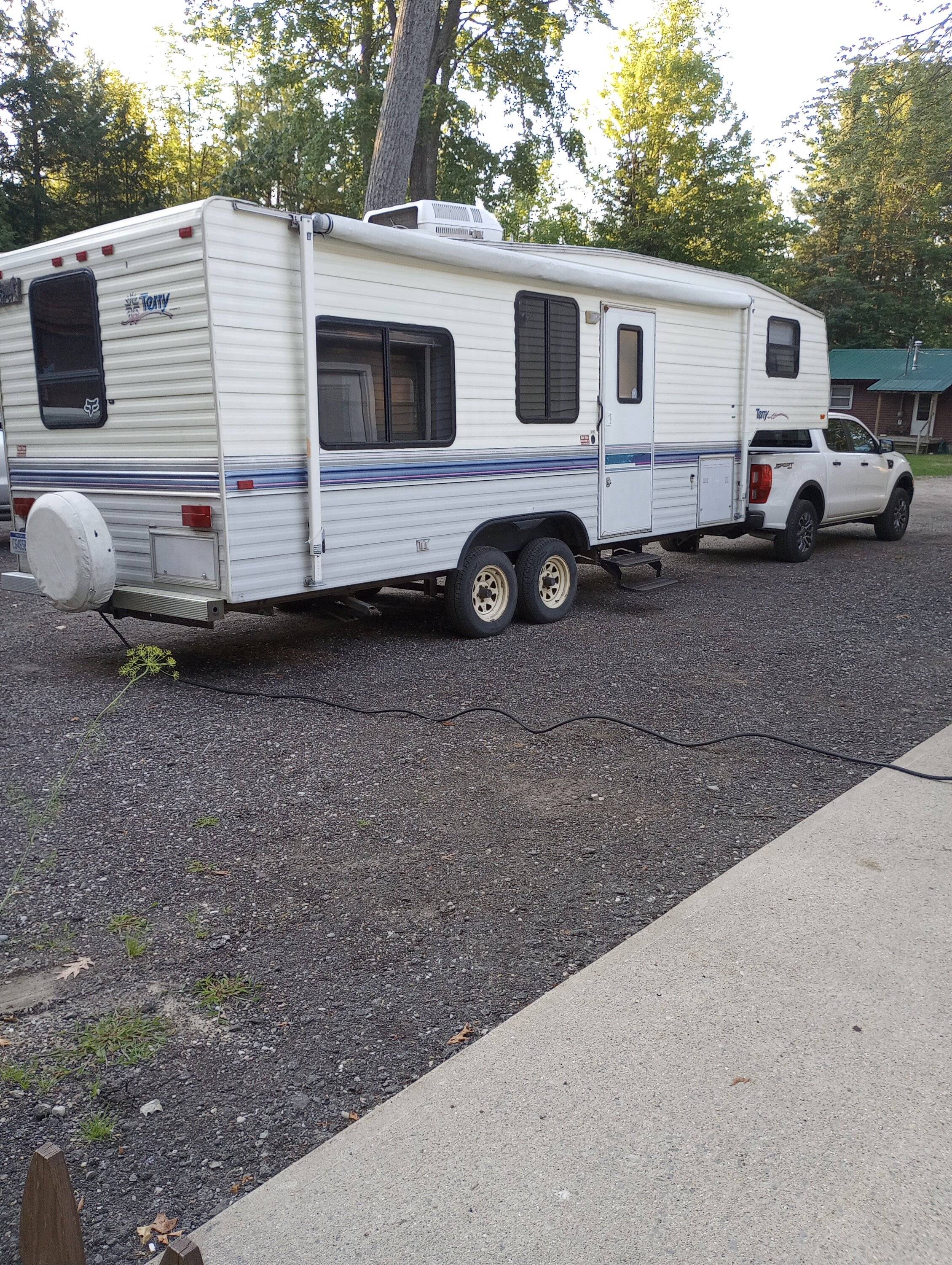

So what about a 5th wheel that has a dry weight of 5,900 lbs and pin weight of 800 lbs. Hitch can be right over axle.
If the hitch, hitch attachment, trailer design, bed rail height, and turning radius work with the truck and trailer combination, then the weight limits should be fine for most Ranger configurations. There are lots of measurements to make a 5th wheel work well with any given truck and hitch combination. What works with one hitch setup in a specific truck may not with a different hitch or truck.
Ford does not address 5th wheel towing in their Ranger towing guide. I just know there are some towing 5th wheels. You will be over the 55 sq ft frontal area measurement, but many towing combinations are. Trailer brakes will be a must, and towing mirrors will likely be needed.
It also matters how much and where you will tow. Weekend trips to the local lake put far different conditions on the truck than cross country trips through the mountains.
Personally, for my less than 5000lbs trailer and 1600lbs of payload with tongue weight, I wanted a minimum of 7K towing, and 1800lbs payload. 8000 of the 11,000 miles on my Ranger are towing. For most, that’s not the case, and pushing the trailer weight up a bit will still be fine. It really also depends a lot on the driver.
Can what you propose be done, likely, but as I said do your homework to make sure your combination works for you.
I don’t have a 5th wheel or gooseneck, but have been around, and used both much of my life. Hope that helps.
They are capable trucks, but are not SuperDuty.

Thanks brroberts for the reply. Back in the late 80s and 90s I owned an RV dealership. Set up a lot of 5th wheel systems on 1/2 ton ,3/4 ton, and one ton trucks. I know what my Ranger is capable of towing weight wise and how I need to do the hitch on it. I was just looking to hear from anyone that was hauling one close to the load limits and if the had any concerns with towing it. Thanks again for the reply.

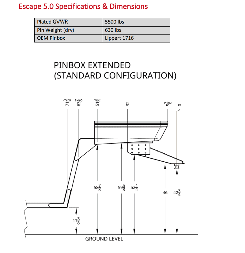

this might work. 5500 GVWR and 630 lbs pin weight.
Escape 5.0 - Escape Trailer
I seriously thought about that particular camper when I ordered my camper. I ran the calculations using an Anderson hitch in the bed, and it would have worked, but my turn angle would have been limited to about 67 degrees if I recall based on their configurator.
I ended up sticking with a pull behind since I also tow with my SUV.

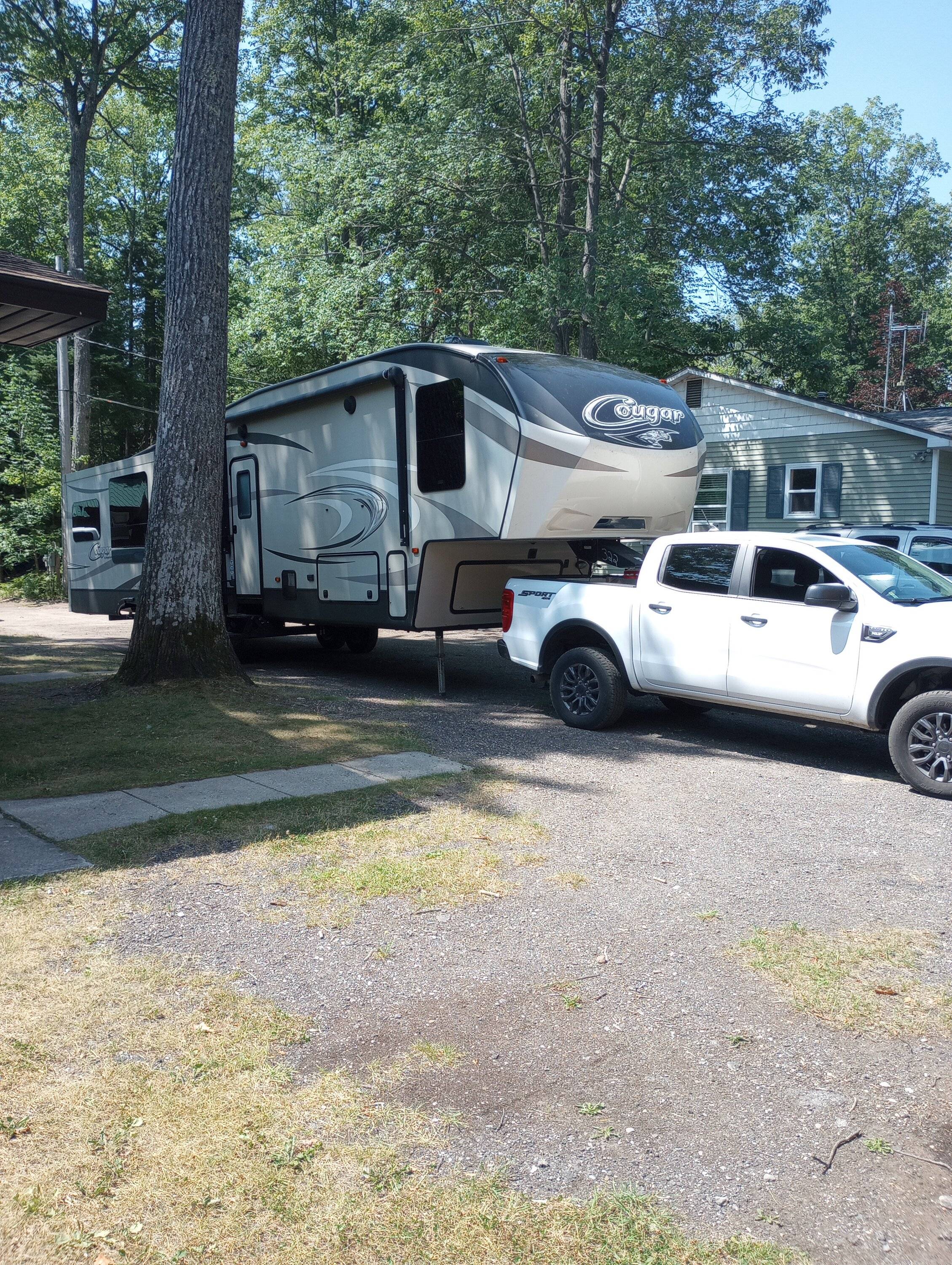

The second pic of the Cougar was just a joke not hooked up.
