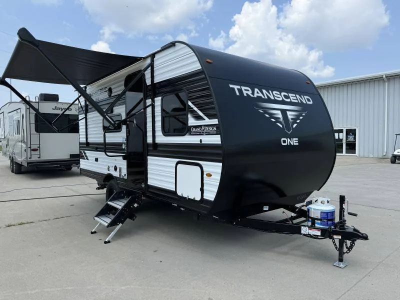

I figured I wouldn't de-rail the forum with all of my trailer specific questions...But sense a few of you are bringing up batteries/solar/boondocking etc... Here is what mine comes with (pretty basic):
12V Interstate 24M marine deep cell battery (1)
185W solar panel (1)
My thought is to add a second battery or tell the dealer to not even bother with putting that one on and putting 2 LifePO4s on. Secondly, I am going to have them add a second 185W panel to get close to 400W.
I'm a beginner with this part so I appreciate the input from those of you who are experienced!
We do plan to do some boondocking from time to time. Our summer camping will mostly be with hookups but our winter use case is unique. Our local ski resort has RV parking, 30 sites with power and a bunch of spots for boondocking. I'll try and get the power sites but I'm sure there will be a few weekends of boondocking. I'm not planning to use water (lodge has 24/7 bathrooms and showers). But obviously we will be chewing up some power and gas to stay warm and keep a couple of lights on. This would typically be from Friday evening to Monday morning at the longest.
Our set up is an old '88 Prowler Lynx 18 ft travel trailer (4100 GVWR). Haven't hooked the Ranger up to it yet since I bought the Ranger last August after camping season for us. I bought a 2000w Champion generator several years ago to charge batteries back up and phones since we camp off grid on USFS land here in north Idaho. Works well. Yes, it makes a little noise but run it sometime during the day and the batteries are good all night for the furnace. Our fridge runs on propane when we don't have power. The solar option would be nice for the batteries but this works for us pretty well. Old school and simple.

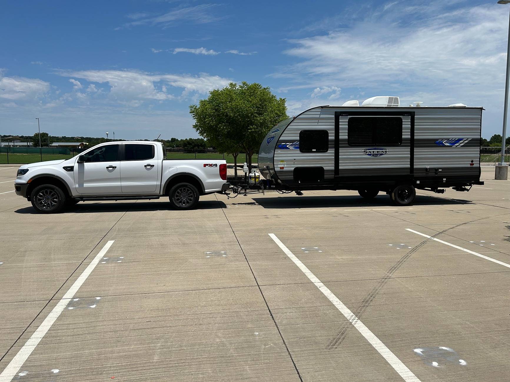

Checking back in - Brought the trailer home this weekend and did a few test drives to make sure everything felt dialed and comfortable. From rural backroads, highways, to some interstate driving. Have to say...I am impressed all over again with the truck. Plenty of power. The WDH and sway control I can tell makes a big difference. I have not been using WDH or sway on my boat which is about 1K lbs lighter than this yet the TT tows much smoother.
Thanks to all on the thread for the advice! First trip will be about 90 miles from essentially sea level up to about 5K feet in the Cascade mountains. Will be a good test!

Just remember, by the letter of the owner's manual, at 5k ft the GCWR of the Ranger is only 10,625lbs (loss of nearly 1,900lbs from sea-level). So, as you get higher up, take it easier on the truck and run +91 octane.
Doing some quick math based on the mentioned camper GVWR (4,420) and the truck's GVWR (6,050), you should be just under the GCWR limit at that altitude at 10,470lbs, if you were to be fully loaded in the trailer and truck.
