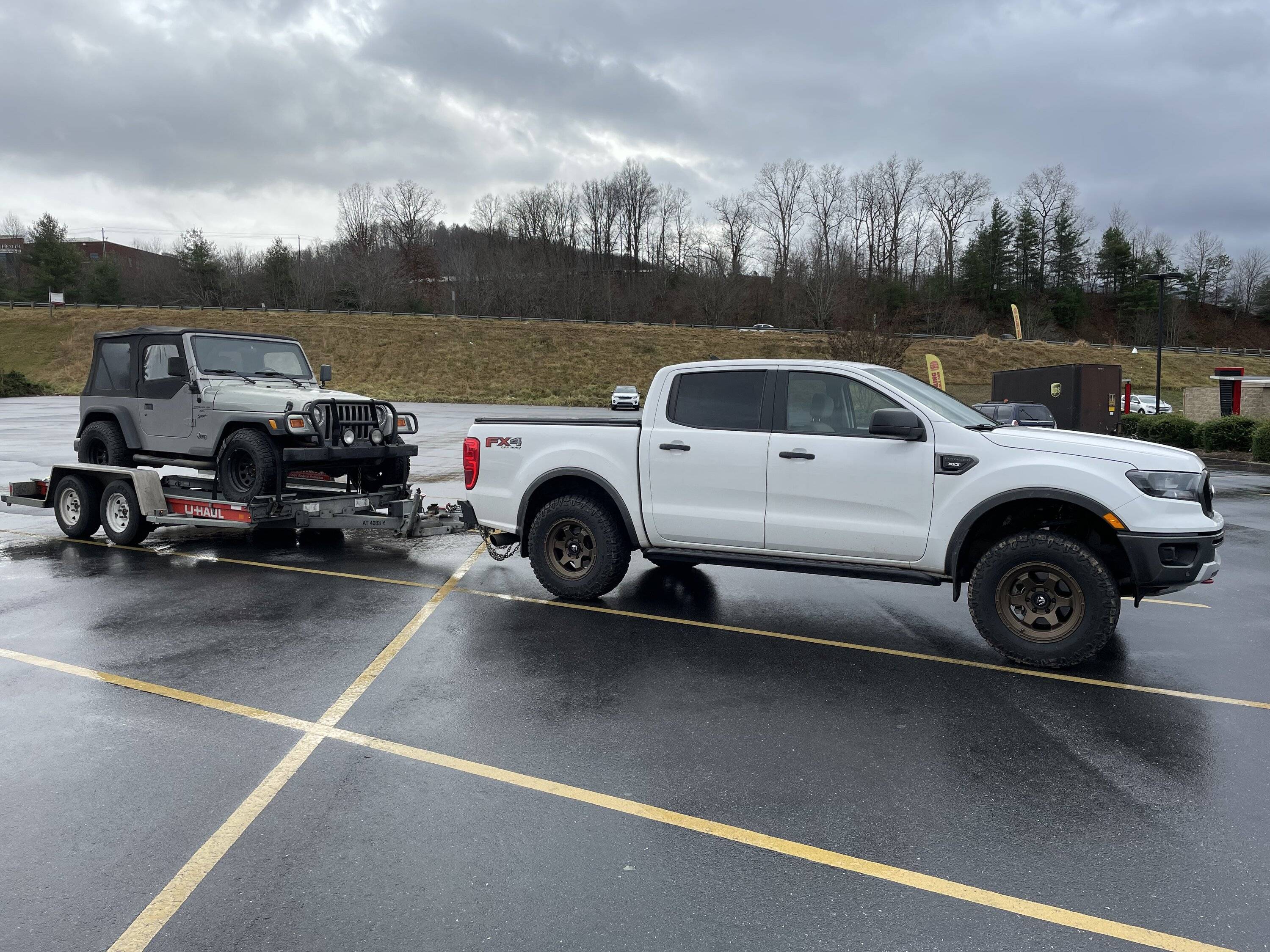

I recently bought a Jeep and hauled it through the mountains of North Carolina on a U-Haul trailer.
The Ranger pulled it effortlessly.

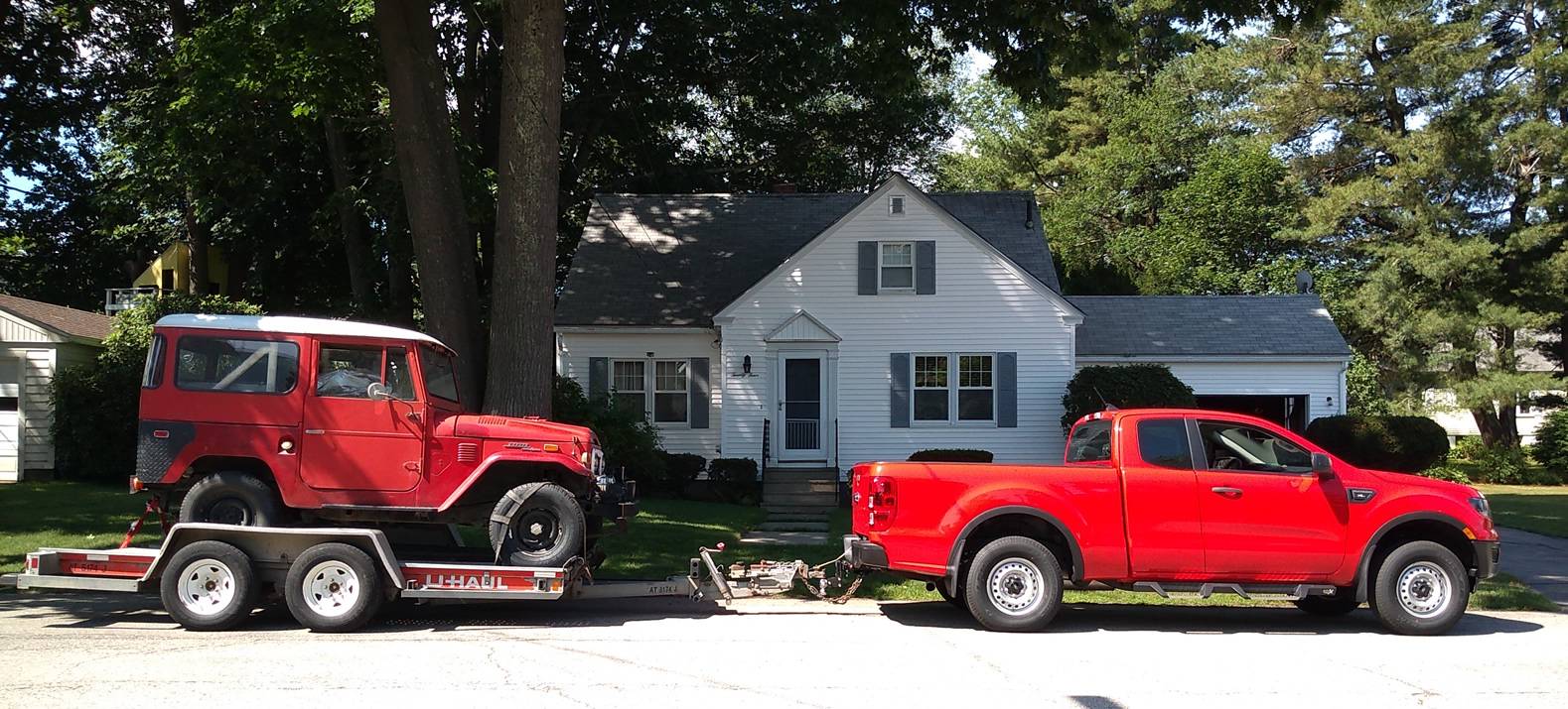

I towed my FJ40 on the Uhaul transport with no issues for a total weight, with trailer, of about 6,000 to 6,600 pounds. The FJ is about 4,000 pounds of that.
It was way too tongue heavy though because the Land Cruiser is so short BUT It hauled fine at 60 MPH, the Ranger had no hesitation at all.
If you can. try to keep the tongue weight appropriate (but the transport I had didn't have a way to push the FJ farther back). I also should have raised the ball mount more, but that was after the fact and there was no way the transport's tongue jack could have lifted it enough to make that change.
