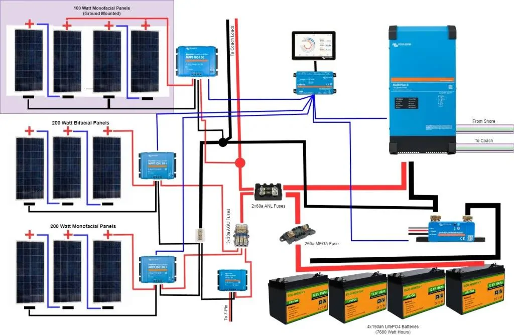

Well, I fell victim to MASSIVE scope creep when I set up the system.
My original intent was to run the fridge when preparing to leave or between trips. About 400w worth of panels and a single big AGM will cover that pretty nicely.
I basically ended up with all the panels that would fit reasonably (Although I do have room for 2 more 200w panels, I don't know if I'll do that or not.) So 1200 watts worth of panels on top and the 400w on the ground....)
Here's where I ended.
3000va worth of inverter (Think 3000 watts give or take). The Victron will power up everything in the coach with ease. It is a beast of a unit and anyone thinking of doing a 'big' solar project or really anything where you remotely think you'll want to run ac or microwave, the Victron is the only way to fly. Expensive, yes, but it has some features that are extremely hard to find (Power assist being the #1 feature. It is out there, but you're going to pay big for it)
Enough battery/inverter that I can power the AC for around 3 hours with no sun and no truck charging. Meaning for our short weekend trips, in the summer, in GA, I can turn the AC on when we leave and when we get to our campsite it will have cooled the thing down some. First world problems, I know. With some solar input and truck charging that run time will be extended of course.
Not to mention, all of the Victron stuff works together sooooo very well.
If anyone wants to poke around my solar data, feel free:
https://vrm.victronenergy.com/installation/488934/share/26ec45af

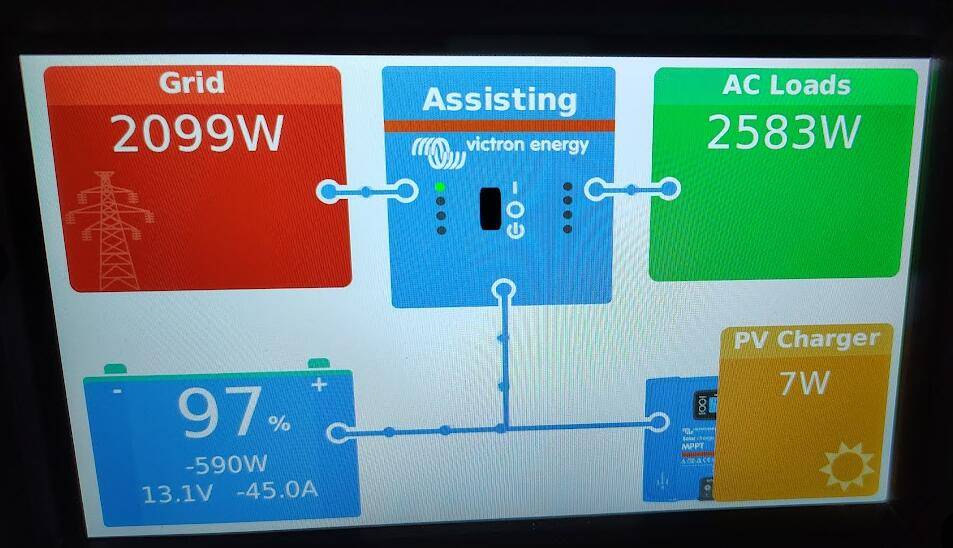

I will never ever again melt a 30 amp connector on a parks crappy connection. I limit my AC input to 24 amps and the Victron will kick in the rest when needed. I can actually power everything in the camper off of a 15 amp circuit if I want so long as the loads are semi-intermittent.
Here's an example. AC and Electric water heat are on, and I've limited the AC input to (something, I don't remember exactly, maybe 20 amps?). It is pulling the make-up current from the battery bank. As soon as the water heater is finished, it will switch over and charge the batts. Totally automatic, no input from me needed.

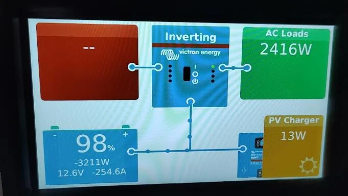

Random additional picture. Here we are doing a bit of a load test. I don't do this very often because I used leftover car audio wiring I had from back in the day and only had enough for a single 1/0AWG run to the Inverter. Plans are afoot to double that, I've actually already got the cable, I just have to find the time.

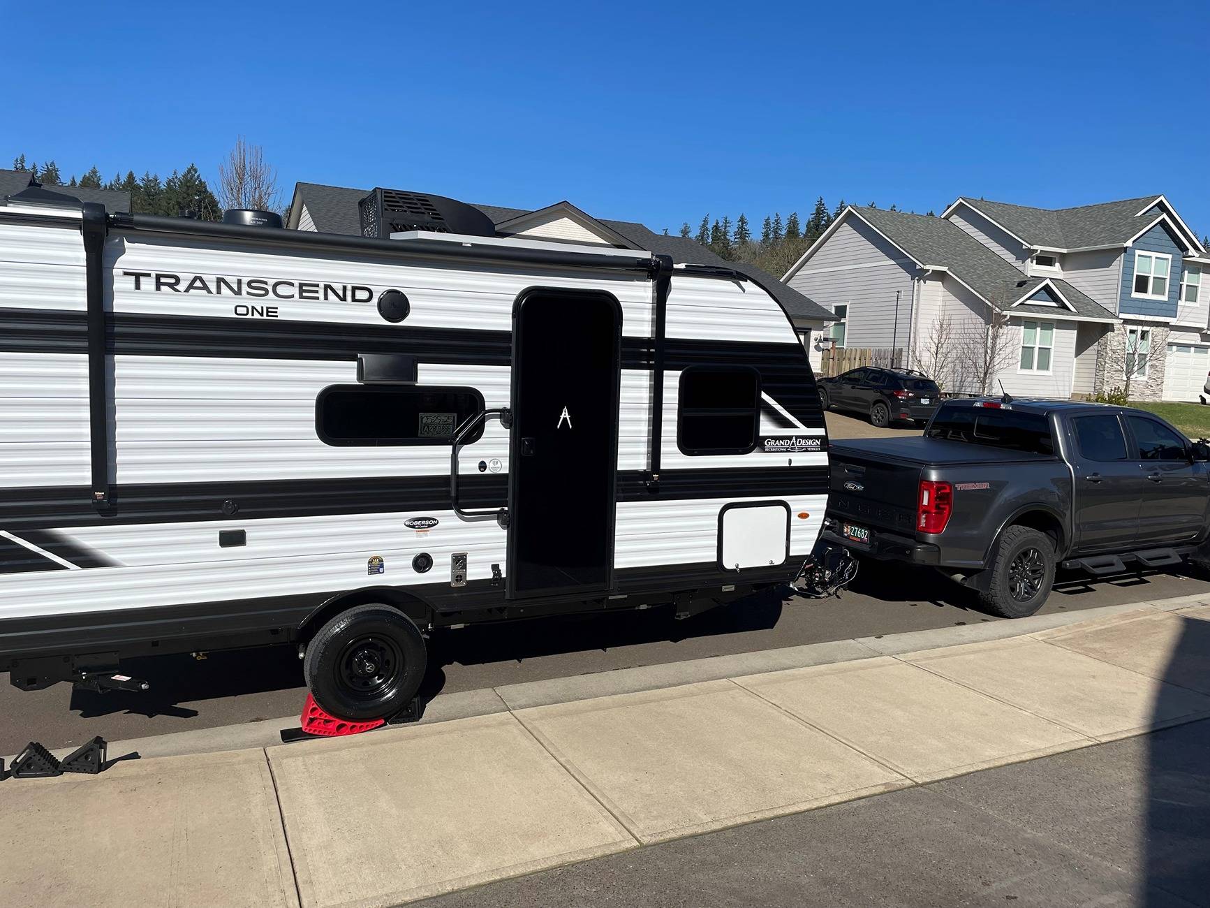

Checking back in - Brought the trailer home this weekend and did a few test drives to make sure everything felt dialed and comfortable. From rural backroads, highways, to some interstate driving. Have to say...I am impressed all over again with the truck. Plenty of power. The WDH and sway control I can tell makes a big difference. I have not been using WDH or sway on my boat which is about 1K lbs lighter than this yet the TT tows much smoother.
Thanks to all on the thread for the advice! First trip will be about 90 miles from essentially sea level up to about 5K feet in the Cascade mountains. Will be a good test!
