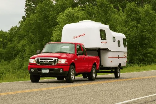

There are Scamp and Escape 5.0SA, and 5.0TA 5th wheels towed by Ranger owners. My Escape is a travel trailer, but my payload for that rear axle is much higher than most of the F150’s Escape 5th wheel owners talk about. The Escape trailers are nice with a high cost and long wait to get, but mine has been worth it to me. They are different from the Scamp and Casita in construction.

the scamp 19' deluxe is under 3000lbs why wouldn't it work? now I want it
It would work, and the Ranger should tow it with no problem.

Doubt the Escape would work...maybe on a SuperCab, but not a SuperCrew. Not saying it won't...depends on how the trailers hitch is set up and how far forward it protrudes.
The 5th wheel hitch needs to be mounted directly over or just in front of the rear axle. Placement of the hitch is critical...you just can't move it "back" to where you want it.
The Scamp would work with both models as the hitch is angled forward and the mounting point is in front of the front edge of the camper. With the Escape, the hitch mounting point is under the front area of the rv...means just about any time you have to make a sharp turn, the front of the rv is going to hit the back of the cab.
If your thinking about something like these for your Ranger to tow, do your diligence in measuring, both the placement of the hitch and the front overhang of any trailer your looking at. With rv trailers and 5th wheels, there aren't any "test drives"...you need to have your ducks in a row when looking/buying.

I know there are Ranger owners towing the Escape on the Escape forum. The Scamp is not a true 5th wheel hitch, but is similar in towing. Some of the MicroMinies are smaller than some of the Escapes. There are smaller non fiberglass 5th wheels as well. They are typically marketed for 1/2 ton trucks. We have some friends that recently bought a 23’ 5.0, but I haven’t seen it yet. There are trailer and hitch combinations for short beds. It can work safely, but you have to do your homework.
