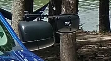

Tow mirrors are not needed. Just get the small mirrors you attach to OEM mirrors. I tow my car trailer with these and have no problem. I think its an 18-20 foot trailer
Ehh, depends on where you drive and what you're willing to put up with.
I had these
They worked great, could see just fine. I got tired of the mirrors blowing into their folded position every time I was on the highway or on a 2 lane and passed a truck.
IMO The Clearviews are worth the money if you're going to tow often. Yea, its an expensive pill to swallow and I'm the worlds biggest cheapskate, but I ponied up for them and couldn't be happier.

I've not read all of the replies, if you plan on towing a brick of a trailer on the highway for extended periods, consider making sure your transmission has the right amount of fluid, some were found to be shorted from the factory. Also, I think manual even mentions swapping the rear end fluid to a synthetic. I've done both of these with my Ranger and have no problems so far towing a >6,000 lb enclosed trailer for a few hours at a time.
Also, Clearview tow mirrors are great if you plan to tow regularly.

Wishing I'd purchased towing mirrors. My clamp ons are ok but the glass quality is poor and they are dirtier more often. Drivers side is useable, passenger side is so far out that I need to cram neck to see.

I've had crummy extended mirrors and now have a camera on the RV with a wireless monitor on my dash. It's a much better view than the mirrors and the camera seems to stay pretty clean, maybe because it is high up above the spray. I'll echo the comment above about always using the tow mode. We went on a 4000+ mile trip in September and on day two the transmission went into safe mode(rpm limited so barely would pull). I pulled over and let it idle for five minutes then turned it off for ten minutes. Meantime I realized I had not been in tow mode. After the 15 minute break we headed out in tow mode and did the rest of the trip with no recurrence. Tow mode gives you a little step up in rpms, just enough, and the engine braking works well. I tow a 20 foot TT with a total of 4500 lbs usually. The other thing that will be new compared to pulling a pontoon is the windage, front and side, on a travel trailer. Sounds like you are good to go with the WDH and sway control. Also I second staying at 62mph. If feels safer, is safer, and definitely makes a mileage difference with the windage of a TT. Have fun!
