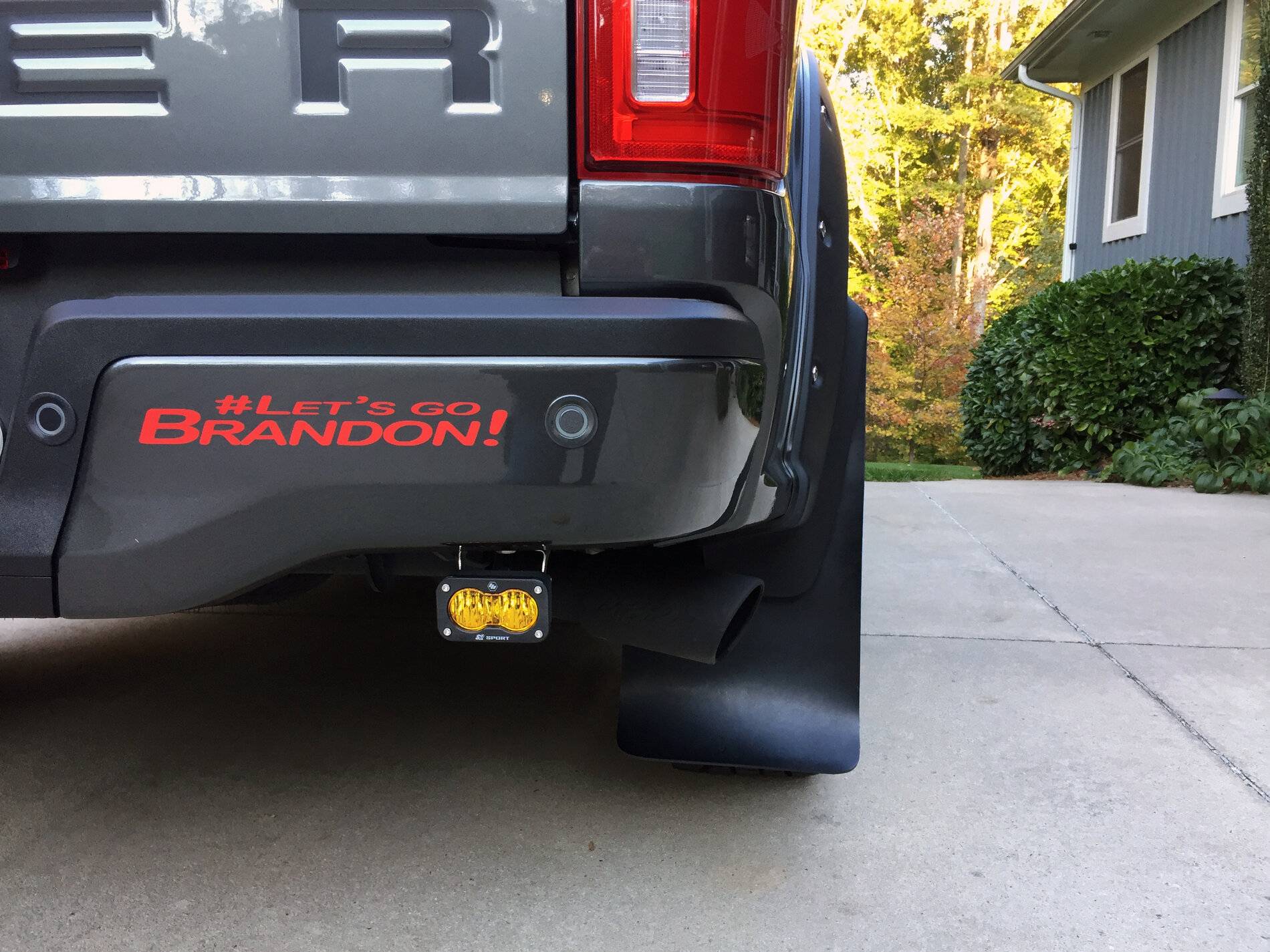

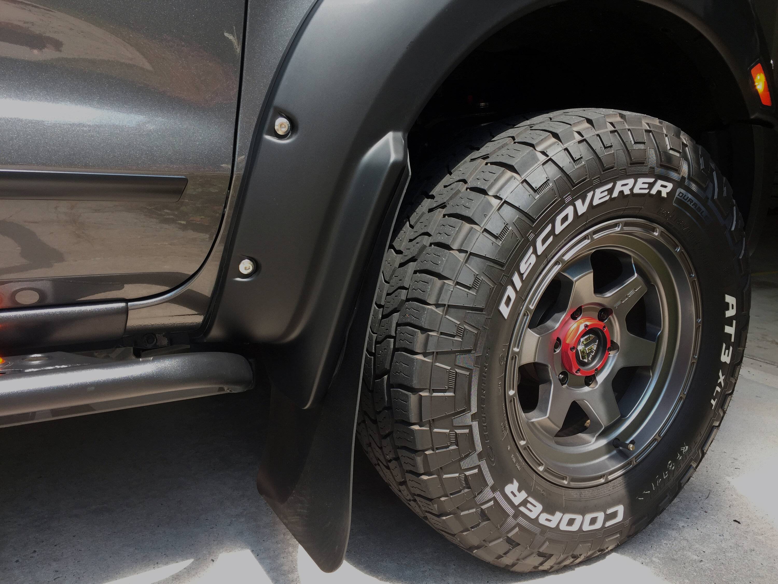

Guess I shoulda got it in white...
I don't see a real solution for this outside of a expensive and ugly line-x coating or maybe I will try doing a strip of plasti-dip. Chips through the 3M strip and even if I got it repainted under warranty it would just chip again with this thin eco-paint.
You need a set of DIY sheel rubber Flaperons...

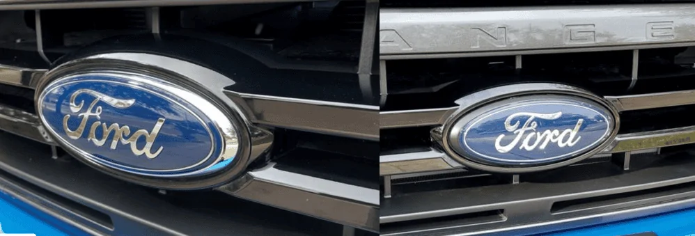

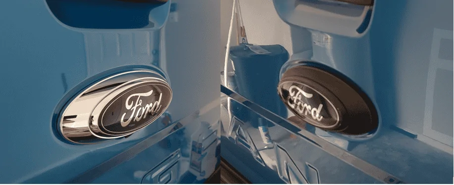

That's way to long to pull tape. I needs to be moist. The 1st coat has to be very very light. Clumpy looking dipped sections are mostly from applying too much. Less is more here. Bad edges are from pulling after it's fully dry.
My emblems before (left) and after (right):
