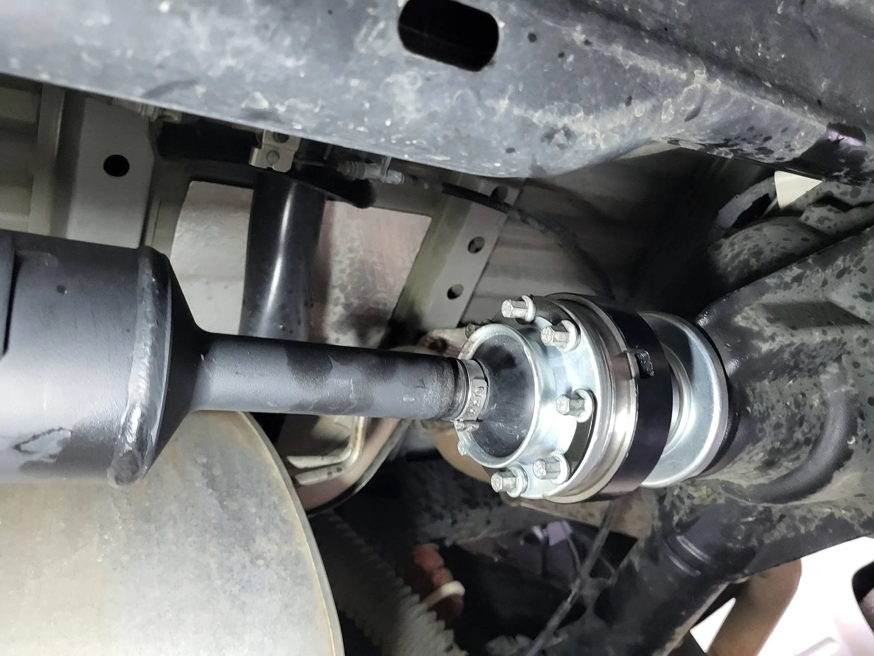

update: wasn't supposed to get a new shaft till end of july but one showed up friday and was installed monday. vibe is 90% gone but i still feel a very slight vibe which seems to come from the front- which is weird. Maybe that is something else. It's almost unnoticeable. The other issue, thump when coming to a stop and then again moving from a stop is mostly gone too. it did it once or twice but it wasn't nearly as bad. If it stays this way, i am good.
the shaft looks different to me, as i recall, where it mounts to the rear diff. I think i had u joints back there but now there is a drumlike thing. Also and exposed part of the shaft. See pic.

That’s the driveshaft thats in the Tremors. That joint is called a Rzeppa joint ( like a cv joint).
ahhhhh, gotcha. thank you!
