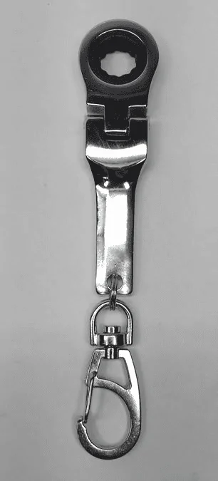

Yes on the no-wrench-needed talk, no one needs to have one of these useless wrenches ... (I'm hoarding 10mm wrenches like silver and gold for the apocalypse!). =D
But seriously, having had this issue once, I greatly appreciate your research and sharing what this is. I certainly will remain much calmer if it ever happens again.
I may, or may not, have a 4th 10mm on my Soupie Keychain...
