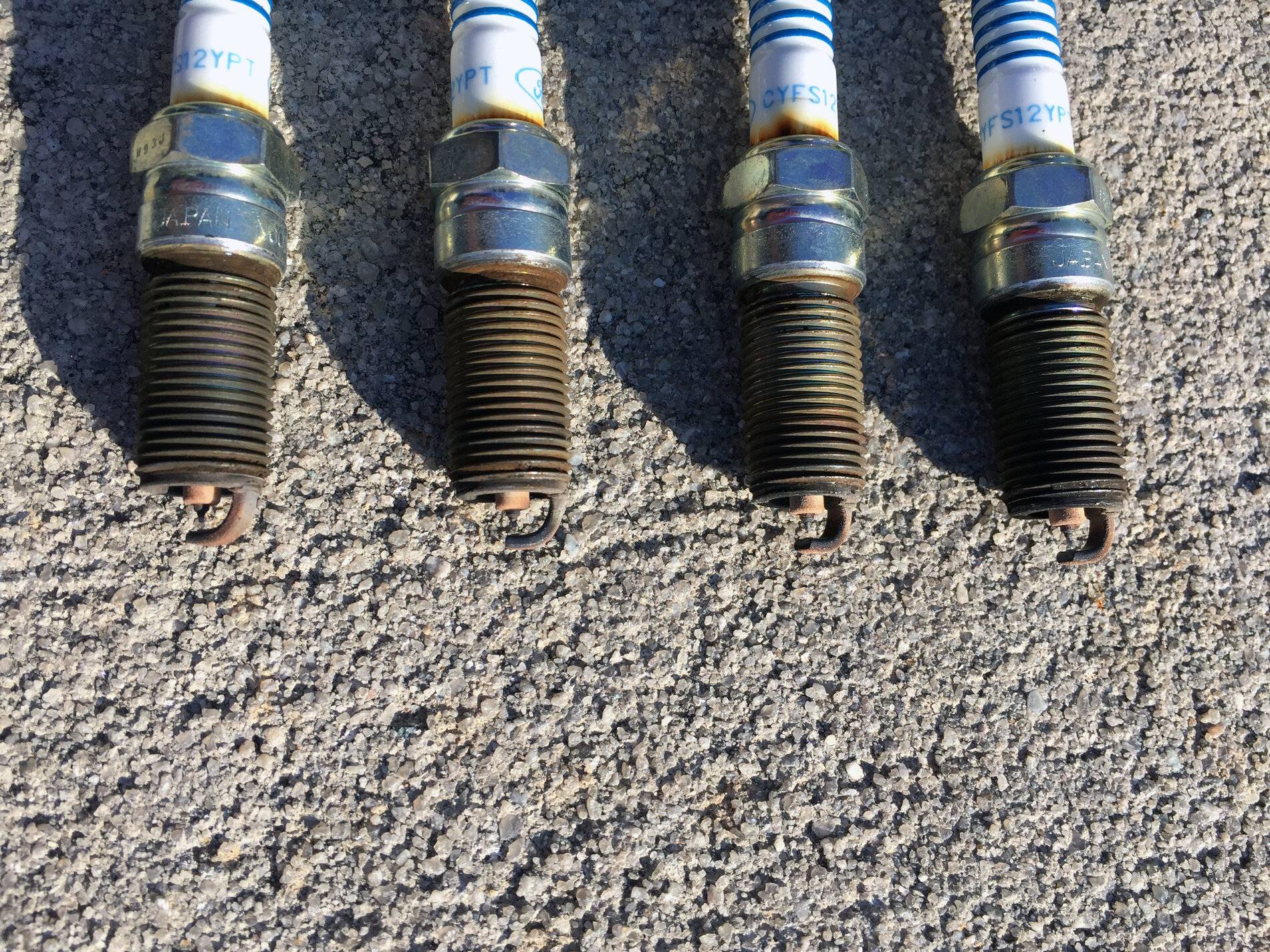

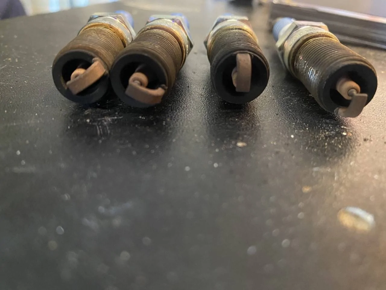

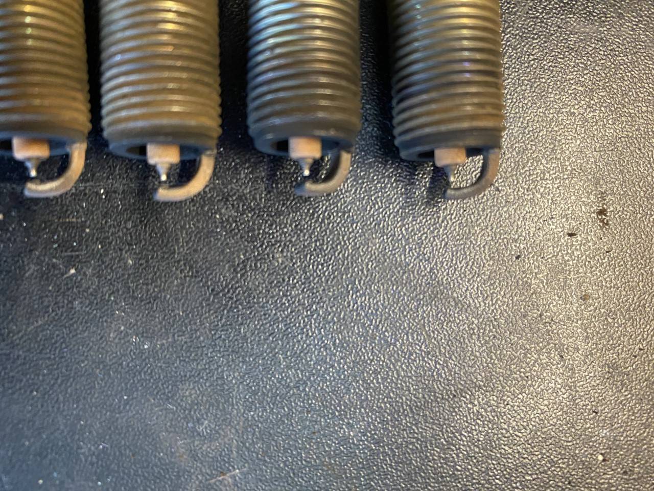

Well, maybe not pristine or like new lol... but looks normal to me...
Do they have a spot like mine in the red circle?

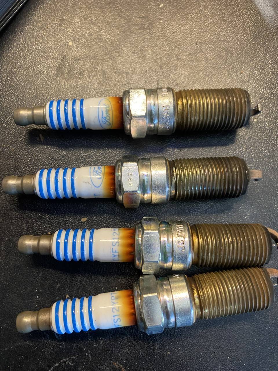

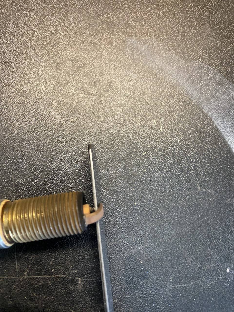

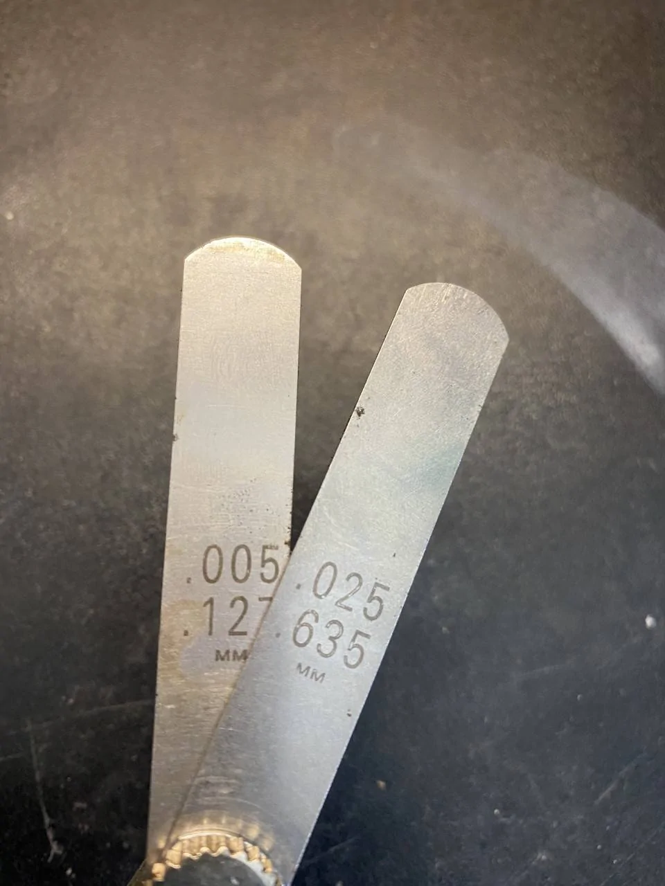

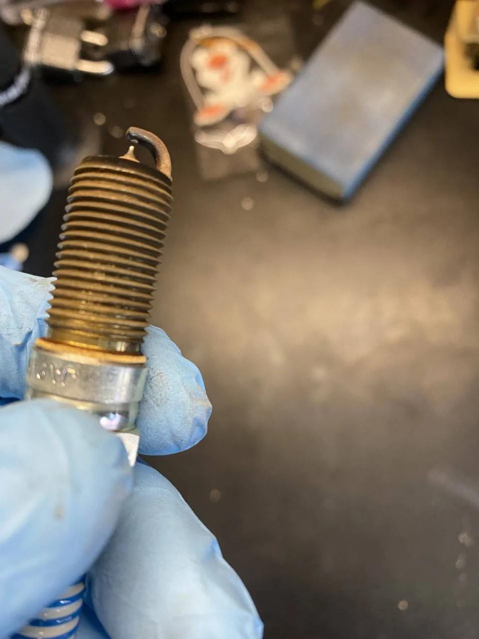

This is why I am changing them and viewers like you are why I have to be so precise about what I am looking for. Trying to keep the thread on topic based on what I have read and gleaned from this forum and the status of my current plugs.
The gaps are .030 and the pics of the plugs speak for themselves.
I don't see anything wrong with your plugs. The side electrode has a nice tan color, the center electrode is clean with no errosion and the insulator is clean. Not sure why all your pictures are of the side of the plug, it is the tip that is important.
I would just clean them up, regap them to .028" and put them back in.

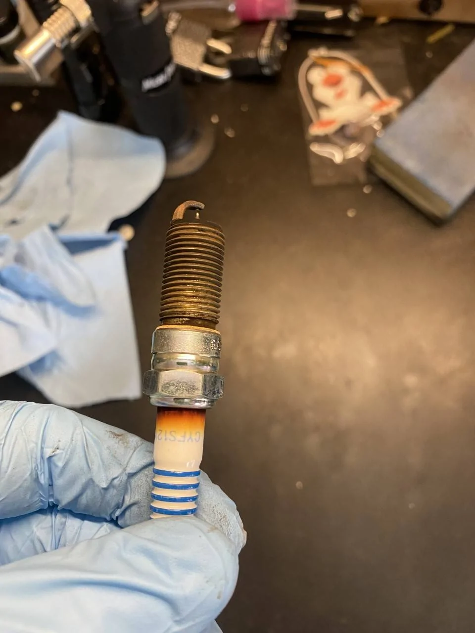

What's done is done. It can also be undone in about 20 minutes or less. That was the easiest plug swap I have ever done except maybe a lawnmower.
