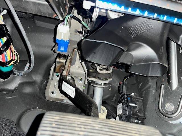

See the black piece of plastic in the top right of the pic with 2 holes facing down. My shoe constantly hits it & it's really annoying. Wondering what it is & if I can remove it with no issues to any other components down there.
If it's related to the AC/ heat & blowing air down there, I never use the foot air, only face level & defroster. I'd love to remove it if it's safe to do for anything else in the truck.
I drive the same way. Never found much heat from the floor vents. The dash vents are far more effective, just the reverse of the 4G rangers

I contacted the NTSB because my foot is always hitting that plastic and even getting stuck on the plastic on the right side of the floor when moving it from gas to brake. It’s a bad design that could cause an accident. I only have a size 9.5 shoe

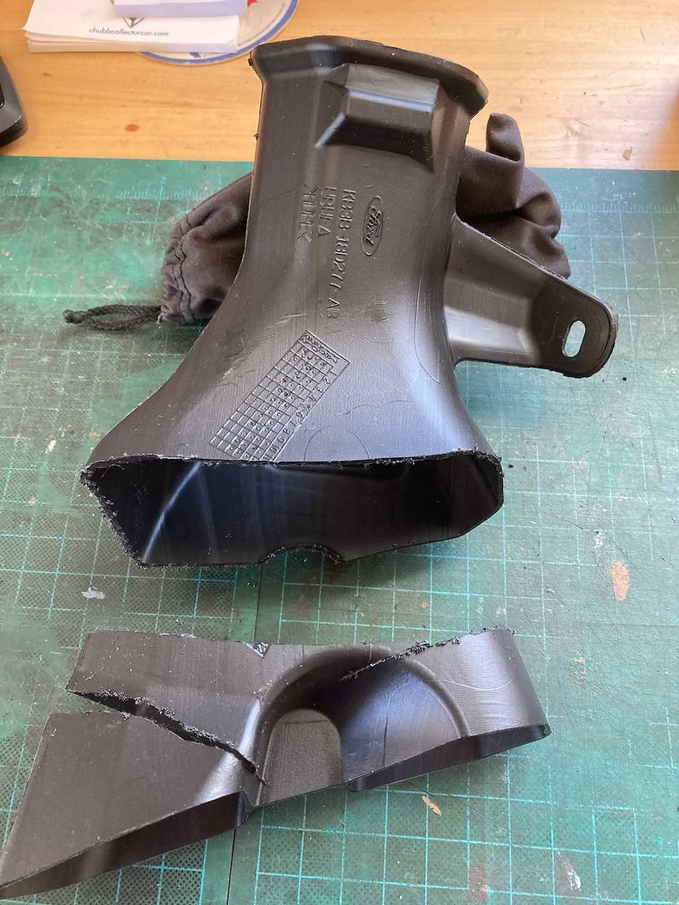

It's worth a try, but I highly doubt it will go anywhere and even if it did, the resolution would be to shorten the duct, I have found that seat position angle changes the angle (height) your foot hits the brake pedal as well - sometimes lowering placement of where you naturally hit the pedal.
The simplest fix is to trim it down as this maintains (airflow) for the Temp Humidity Sensor - at the inlet vent by your right knee and it keeps the (Air Discharge) sensor intact
This is a 2-piece duct that comes from the HVAC box assembly (this section) of the duct also includes the driver's footwell discharge temp sensor (not shown) - so this section cannot simply be removed due to that sensor, and the only solution is to trim it down - like this owner did and in the end if this generated any kind of recall - this would be the solution anyway only a professional designed (molded) look.
This design is in addition to the (poorly designed) placement of the gas pedal and brake pedal proximity to each other as well as the factory issue of air in the brake system that allows for owners to be pressing the brake pedal and gas pedal at the same time.
Combination of 2 designs of which a proper brake system bleed resolves the brake pedal height issue - so you can be holding the brake, and you are above the gas pedal.
The mushy brake pedal issue is well documented on here and there are a few that have the issues with the duct (toes hitting it)
