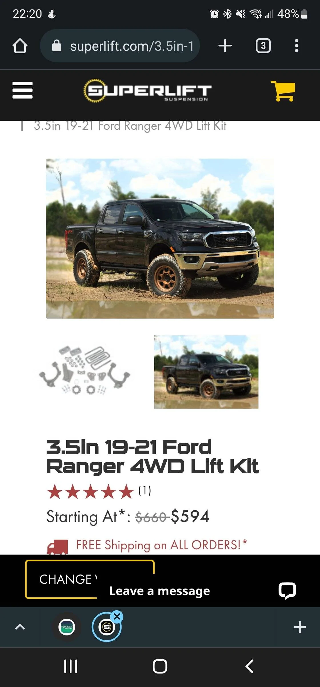

I'm using the UCA that came with the lift from Superlift Suspension. I had it for over a year now, just happen to investigate some noise on my front end when I apply brake and saw that UCA was resting on the flange.

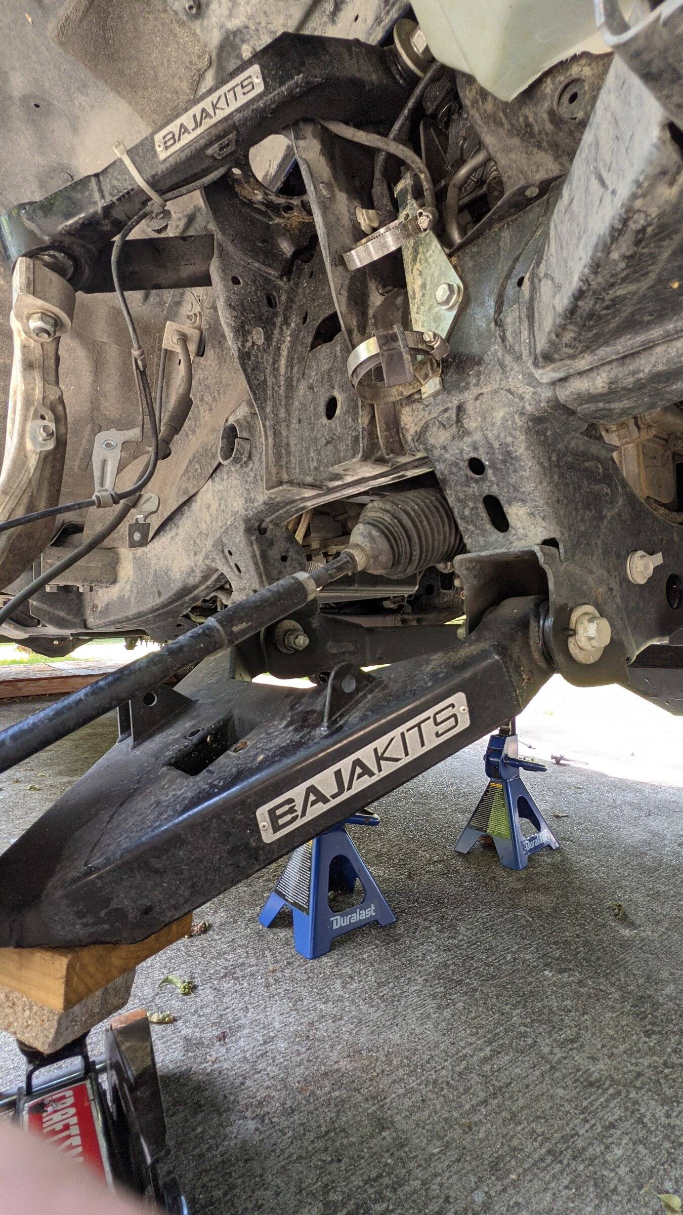

Here is mine with just that corner in the air.
At full, full droop the tubes would clear the flange.

this kit is way too cheap both price and quality. Sorry op.
A good UCA alone runs for $800-1500.
3.5” lift is going to bind CV joints. Did you drop differential? And ya, for something like this the price says not something I would want to do
Looks like I'll be changing the UCA soon. Thanks for the info. I needed the 3.5 inch lift to clear 295 70R17 tires.

It came with a diff drop, thought superlift is been around for a long time and know thier stuff well. So far had it for a year but just never notice till this past weekend.
No offense but it's a super basic spacer lift.
3.5" is extreme for a topper spacer. They have to supply that UCA just so the truck will align.
Look into a coilover lift instead.

I'm using Fox 2.0 coilover with the superlift. The installer had to do some adjustments, and had to preset the Fox 2 inch or 2.25. Eibach came out with coilover months after I had this done. I'm considering Eibach now and Icon UCA.

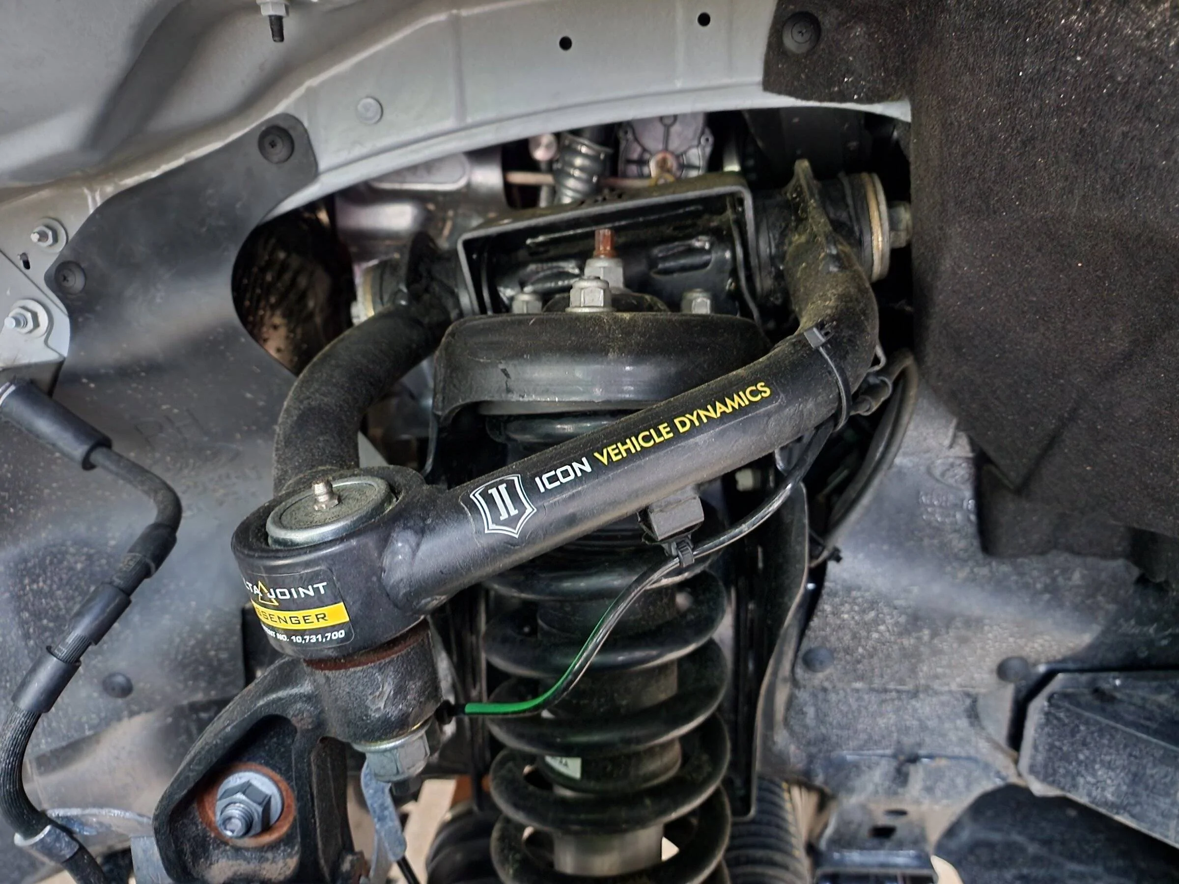

Happens to mine too but it's a good thing for me because it's pretty much at the limit of my travel. It stops me at 11 inches of travel. But I noticed at full droop with the UCA sitting on that flange, my tie rods are about maxed out as well as the upper uniball to the knuckle. And also, at full compression my UCA slightly hits the engine bay sheet metal (fender liners are removed). The only reason I would cut the flange would be to cut the whole coil bucket off and put taller ones with a shorty hydro bump stop attached with an engine brace connecting both sides. In other words, I would leave it alone. Haha cheers.

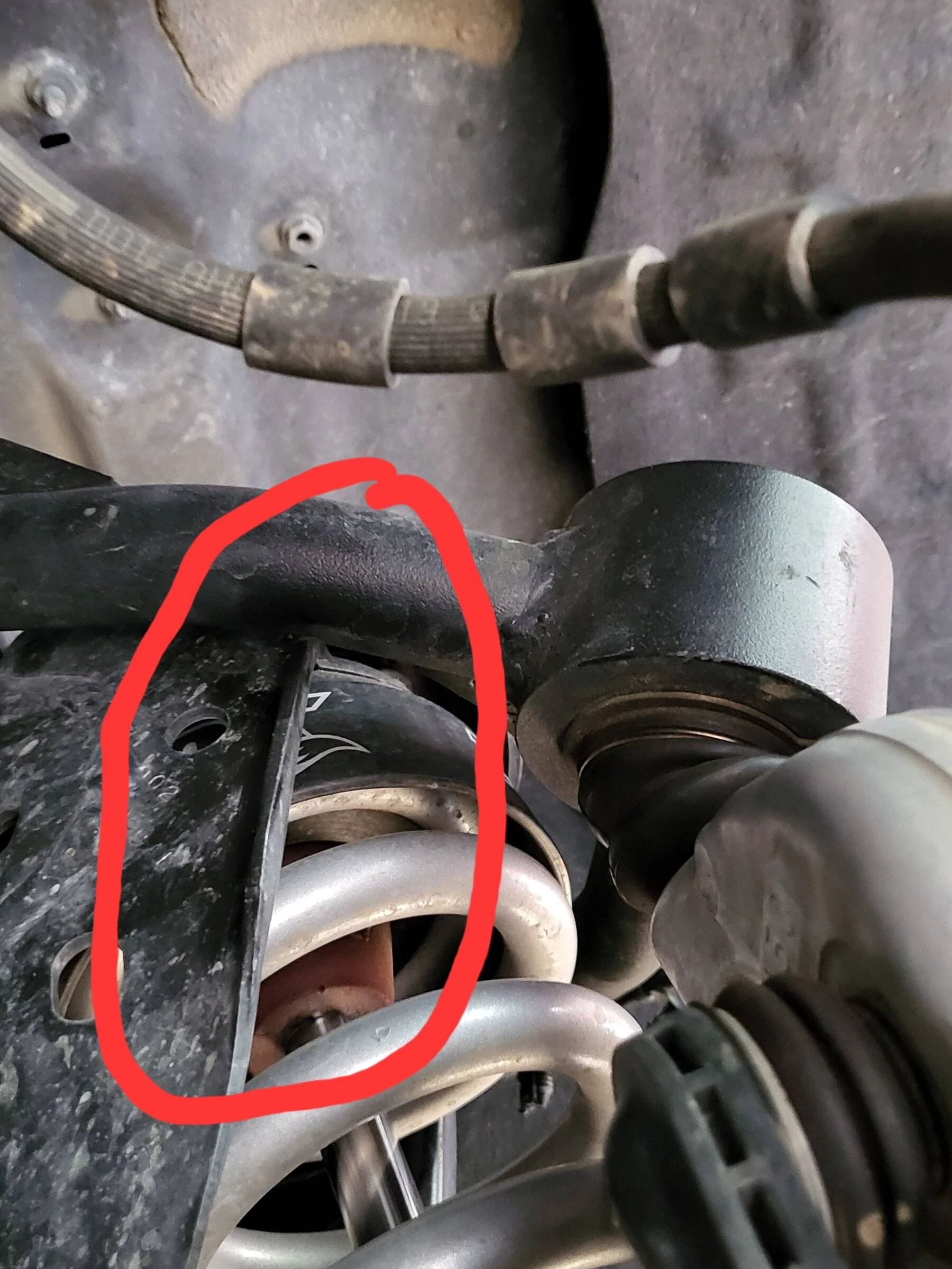

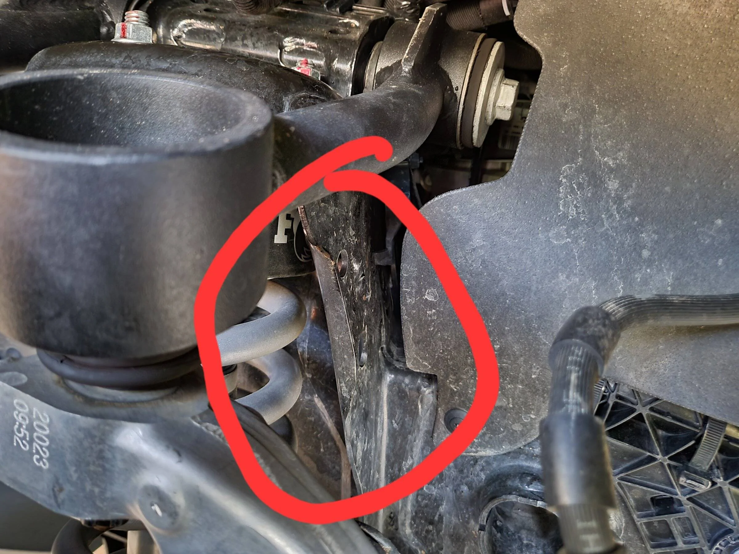

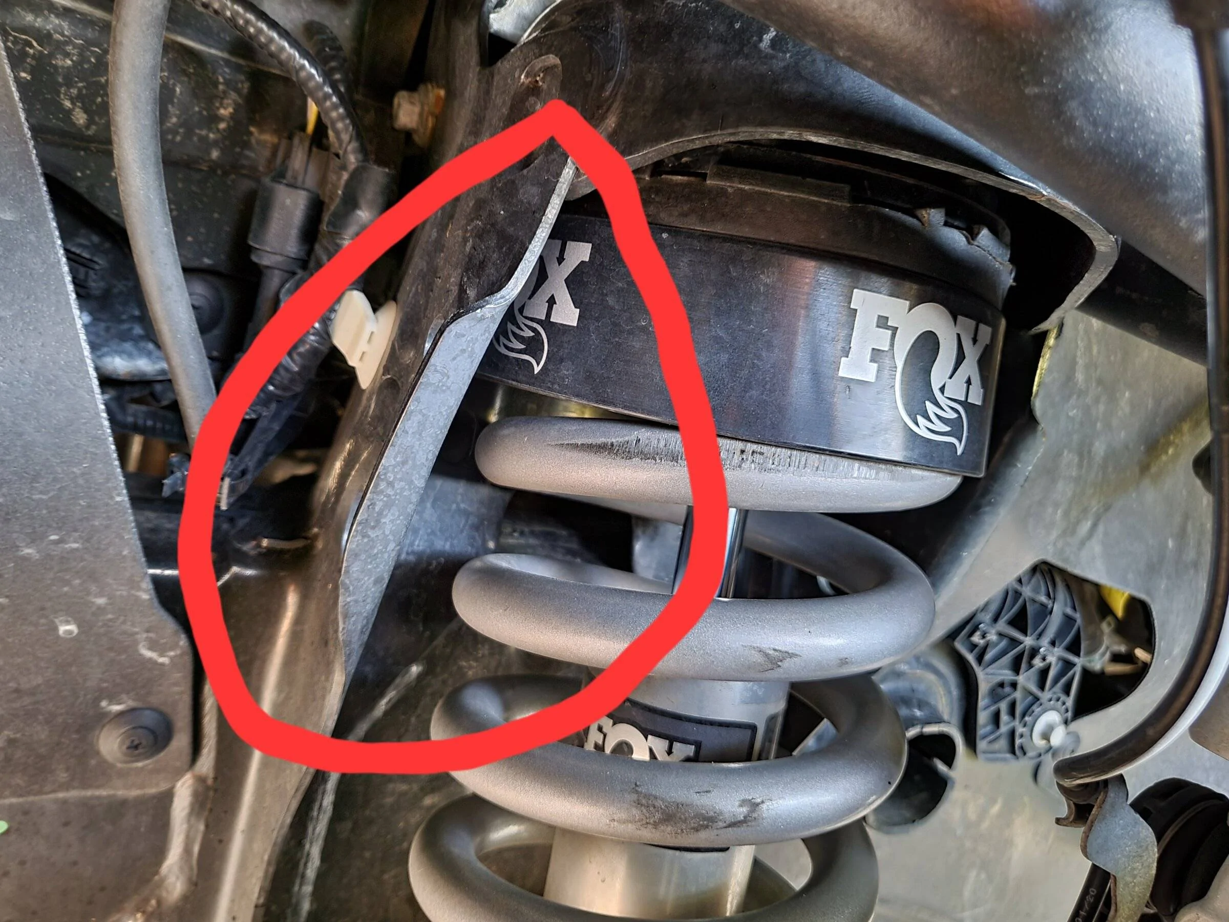

What is the purpose of this? ( see pics circle in RED). It's just below the housing of the front shocks. I noticed that my Upper Arm Controller would rest on that stuff. I was inspecting some rubbing noise when I step on the brake and noticed after I jack the front end one at a time on each side that the Upper Arm Controller would rest on the metal. I assume having same issue when off roading. Is this the stopper for over extending the shocks?

1) The spindle (steering arm?) is very close to the shock spring in the third photo. See the bottom right corner. Appears to be almost touching. The metal piece is probably a splash shiels, as people have noted, but the small flange appears to be positioned perfectly to catch the control arm as the spindle is about to make contact. That's probably not a coincidence, so I'd guess it's also a hard stop for the suspension, as you speculated.
2) In the first photo, the very first coil (top) of the spring shows rubbing marks where it's rubbing on the spring seat / cap when the spring is compressed. This could be the source of some noise, but I'm not sure if it would even make enough noise to be heard. It seems like a pretty light rub. Might rub some wax on there, or a tiny film of grease, but grease will catch and hold dust, so that might not be a great idea, as it could make it worse. Wax repels dirt, but it probably won't be enough to lubricate anything to speak of.
