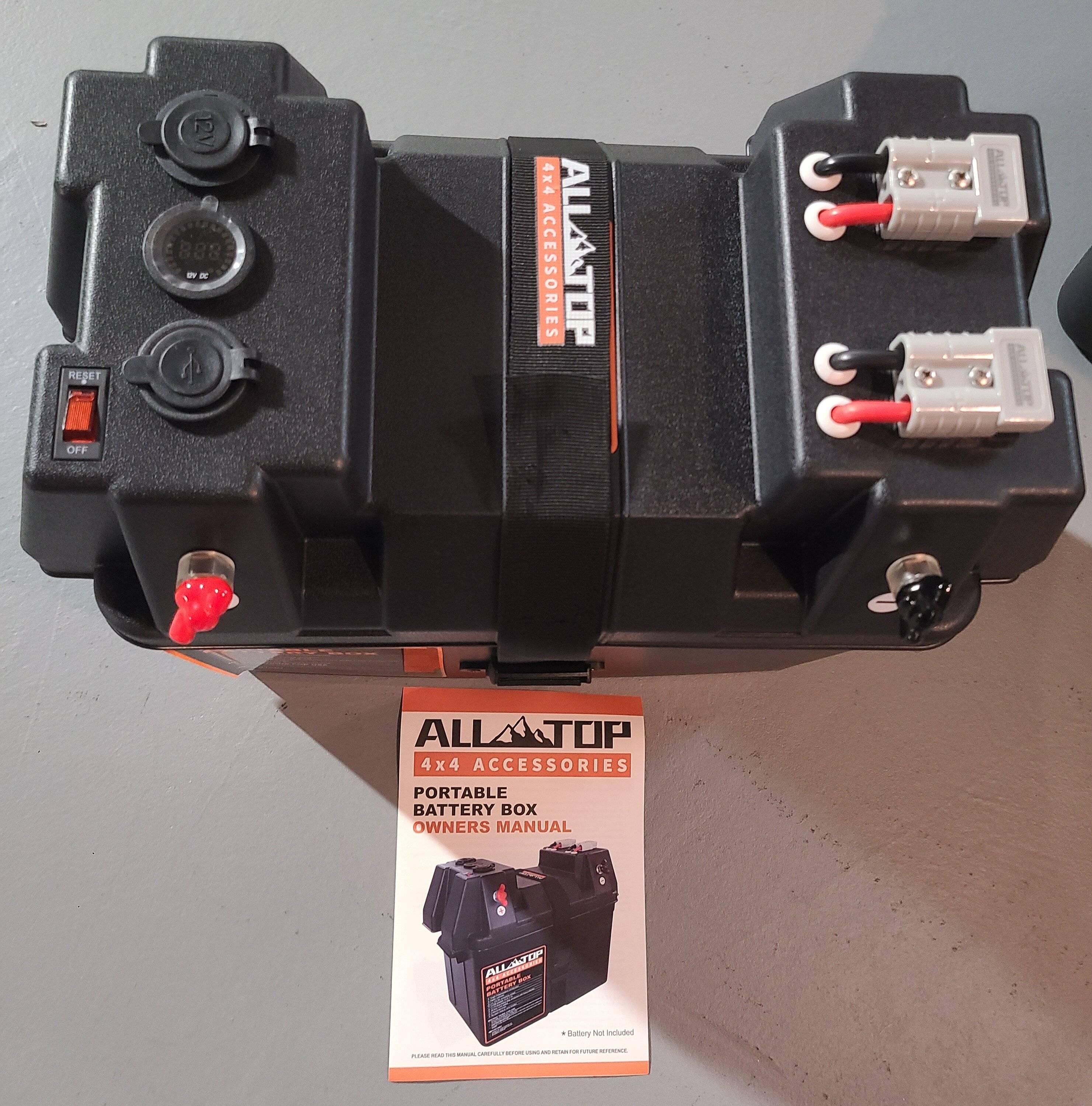

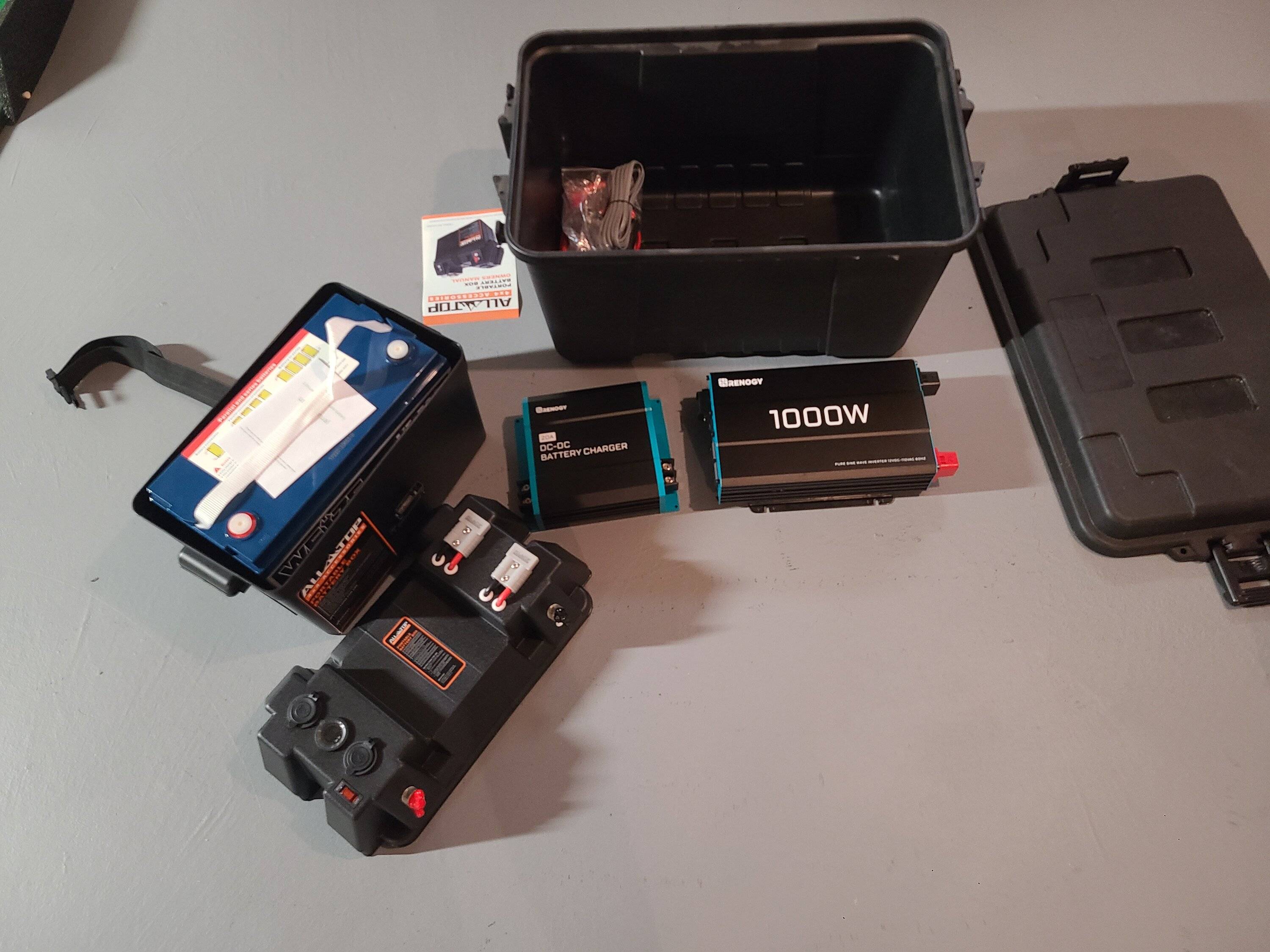

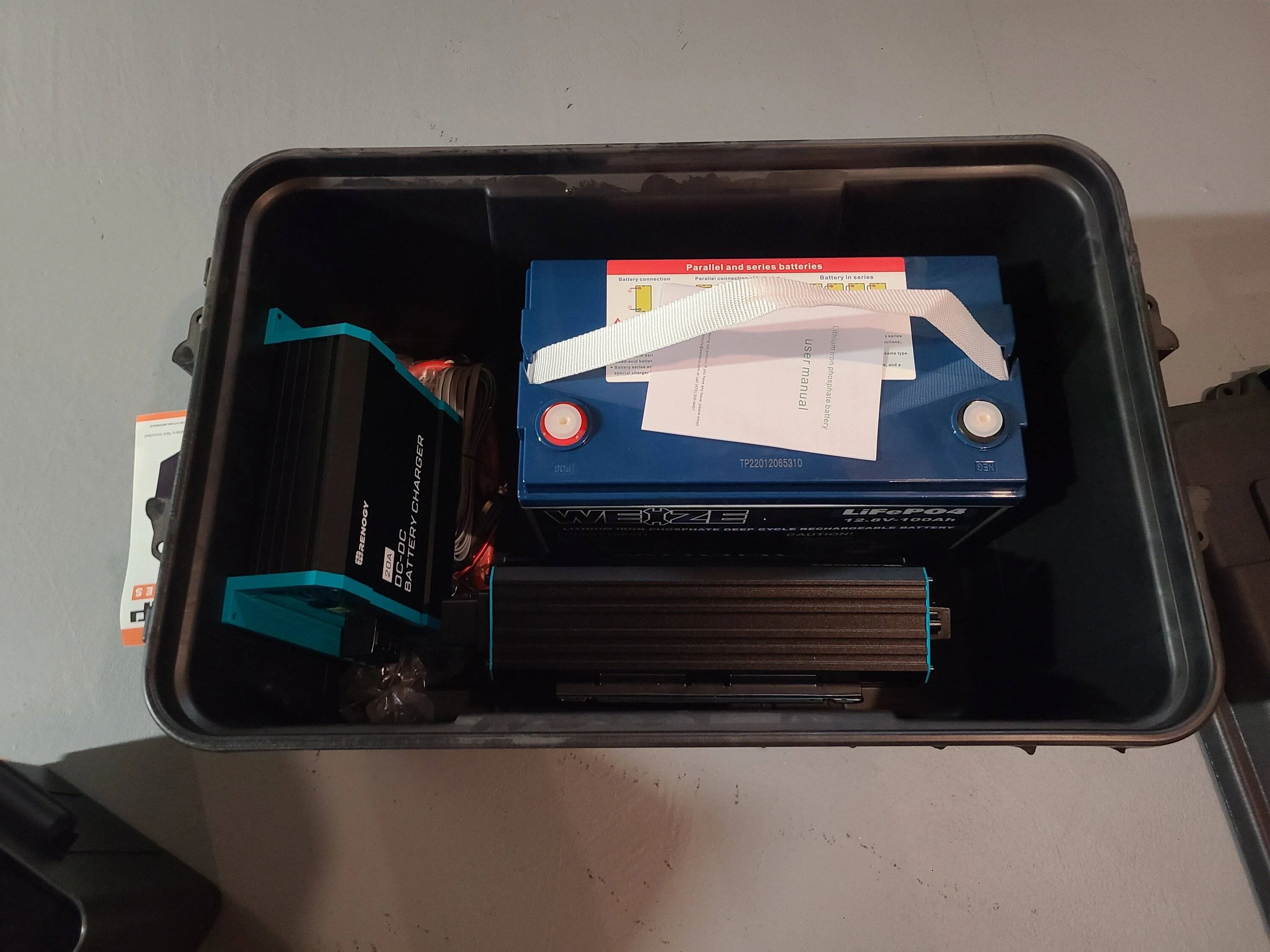

As I continue to "wing it" with this inverter project, my dc-to-dc charger and modified marine box arrived.
My two main routes:
Now I'm at a crossroads and not sure with way to go. With the size of the charger and inverter, I have an all-in-one solution with the larger plano box. I would outfit the top with 12v, USB, and 120v outlets and charge ports for connecting an array of charging options (12vdc for the dc2dc, 120ac to 12vdc, and solar, possibly all wired to a rotary selector switch for full isolation from each other). That said, the foot print is larger than I wanted for just one battery.
Second option is more modular. Use the smaller battery box and mount the dc2dc charger and inverter on the side wall of my bed (thinking builtright molle panels down the line) and have the smaller battery box tucked out of the way behind the wheel well... I could then order a second battery and basic marine battery box- by adding an anderson plug and make a 6ft jumper, double my ampacity running the two in parallel, and have them both tucked against driver and passenger side out of the way.
Only concern would be having the charger and inverter mounted right under the edge of the tonneau cover and the possibility of them getting water in/on them.
As a bed rack and RTT are still far out additons on this project, I'd contemplated purchasing the truck bed tent (fordpass points maybe?) and air mattress by Napier in the mean time, so something tighter to the side walls was a consideration with that in mind.
Choices?...
Any thoughts, suggestions or similar setups to what I just described? Thanks!
