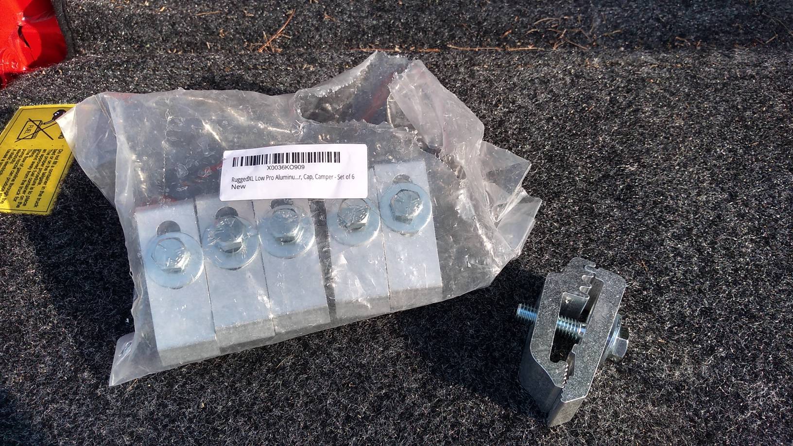

I got these nifty gator clamps thanks to a link from @RedDakooter05. =)
I'm going to add 3 to each side of my Revolver X4s to make it more secure. I'm not sure they need it but the 4 on each side don't seem like enough for the 6 feet of rail.
https://www.amazon.com/dp/B09V1SLJ88/
And ... Kate got yet more microfiber towels! She's a nut on detailing her new car (she even has those microfiber fingers for doing the vents). And the blue thing is a bucket caddy, because you know ...
At this point, welding them on would be an option...

No, I meant you lmao. You already have 4 per side.
I should be fine with just center mounts.(Have not installed them, busy with work)
But they were such a pain to get in and shim so that the tonneau rails didn't dip inward. They still do a little on the driver side so I'm hoping that more clamps with shims on each will help keep it level.
A semi-determined thief would do best by not trying to break the tonneau latch system but simply pry the tonneau rails up. Even with the clamps tight, the plastic of the bed rail caps is slick and the rails can be moved up with a bit of force.
LOL, always something that I can work myself up to worry about! =D
