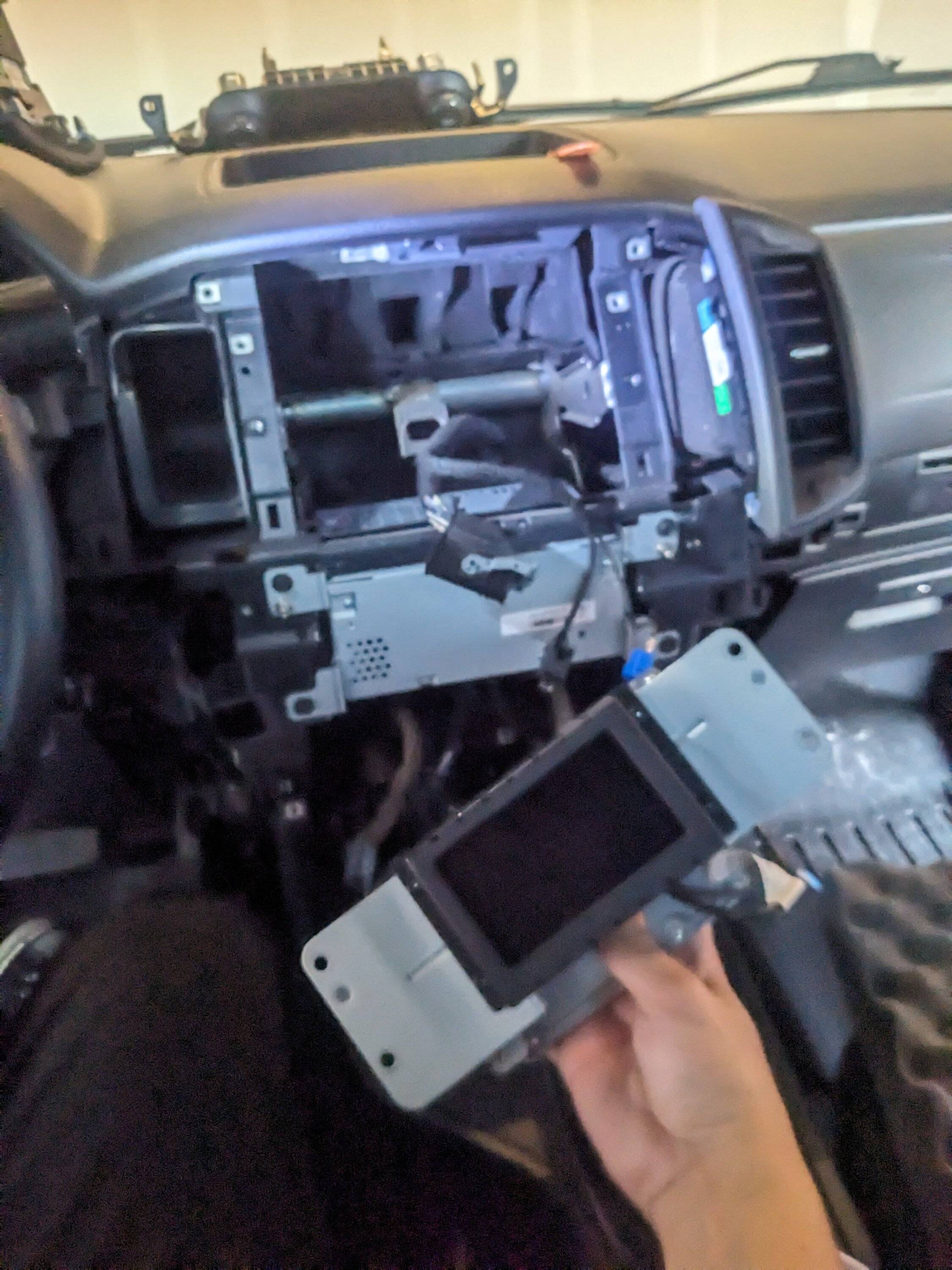

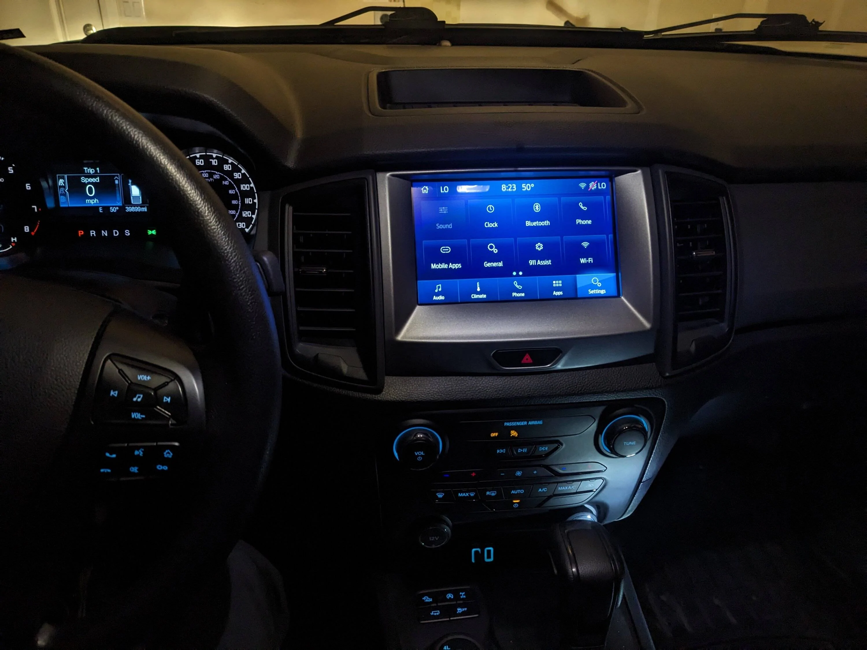

I'd love to hear more about this since I have the tiny screen. It was one thing I looked at after ordering my Ranger.
There is a few companies that make the 8 inch conversion for people who have the 4 inch screen. It's expensive if you ask me, but it's the easiest solution. When you order or purchase you enter your vin #. They program the 8 inch head unit before shipping it to you. Then you do the install following their video on YouTube. I have seen other companies that have a 12.1 inch screen too, so you could make your ranger like the 2024 + rangers. I put the links below.

Thanks for all the info, so $1,799.99 for what I want.
It sounds high but it's a complete kit with the entire new center console and ac/heat controls.
Anyissues with those connections? It's all a 1-for-1 wiring installation?

Yes, it all one for one and went flawless. I followed the you tube video carefully. I watched it in entirety before install and had it on my phone going step by step pause, complete step, rewind to ensure I did it correctly, then proceeded until the end.
? I worried about this plastic clips too, I did use the plastic pry tools to help me ease into pulling parts off the dash etc...but every clip survived and went back into place. Whew!
