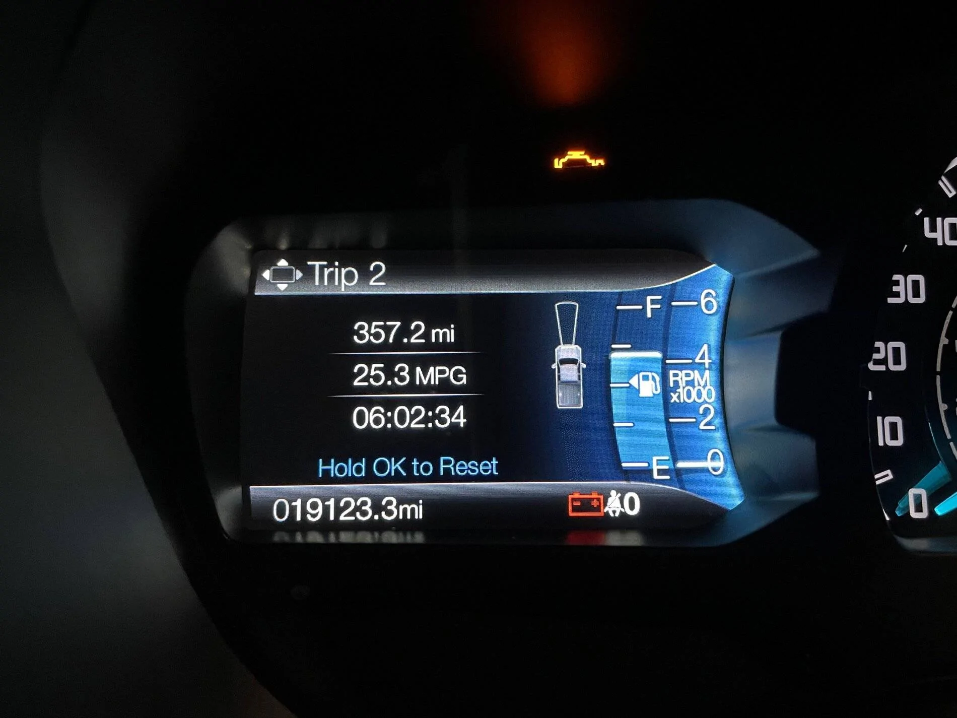

Did a small drive for something..
But the "funny" thing was that I remote started the car and came to there 10-15 minutes later. Then I pressed the start button and the car vomited set of codes. Check 4x4, 4x4 malfunction, reserve maintenance, downhill assist failure, front collision detection failure, jada jada jada..
Drove off and the car was in limp mode. Stopped, turned off the car, walked around and restarted. And off it goes without any issues.
So I guess we're reaching the predicted technology level..
P.S. It was bit over -20'C in here this morning.

Sounds familiar except for the cold.
Sorry to hear that you've experienced the same situation.
Today the temps were only -11'C and there was no issues.
However I did take ODB reader to the car and the underlying issue seems to be engineering choice.
Actual code is "UE401 - Invalid data" and the symptoms are software/design choice. Practically the design choice here is "Some sensor is sending data which does not match engineering expectations so let's just disable everything to be safe".
Any normal person would note that "You data is crap, go sit in the corner and only come back when you have something real."
