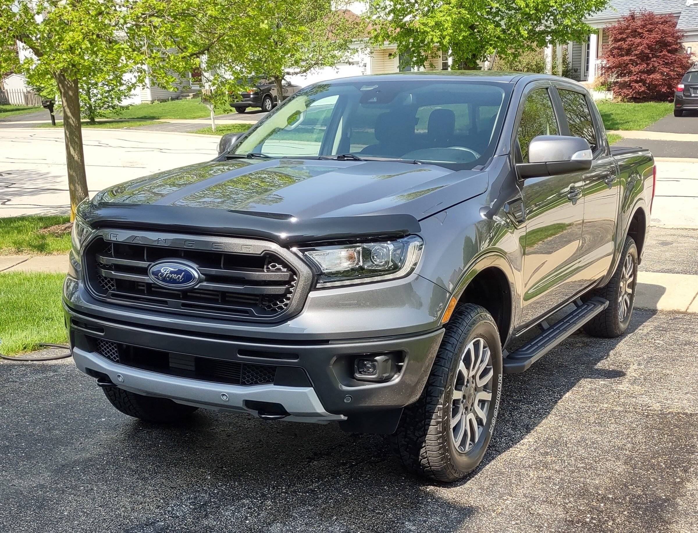

Finished the installation of the lift. I did break the sway bar end link on the driver side though. It will be parked until I get the new one lol. Next up is the winch installation
Did you break it or just pop it out of socket?
I did the same thing and took the bar off and used a rubber mallet to pop it back in. Granted I still have less than 11,000 miles on my 19'
I’m curious if either of you did your install by jacking up only one side at a time. I’ve read that it puts enough strain on the anti-sway bar for this kind of thing to happen.
Or, were both sides in the air on jack stands at the same time and it still happened?
Just trying to help out the next home installer. ?
I basically followed stage 3's video and sort of forgot twice to loosen the bolts for the sway bar to give it enough tolerance for when you have to push the control arm down. Woopsie lol

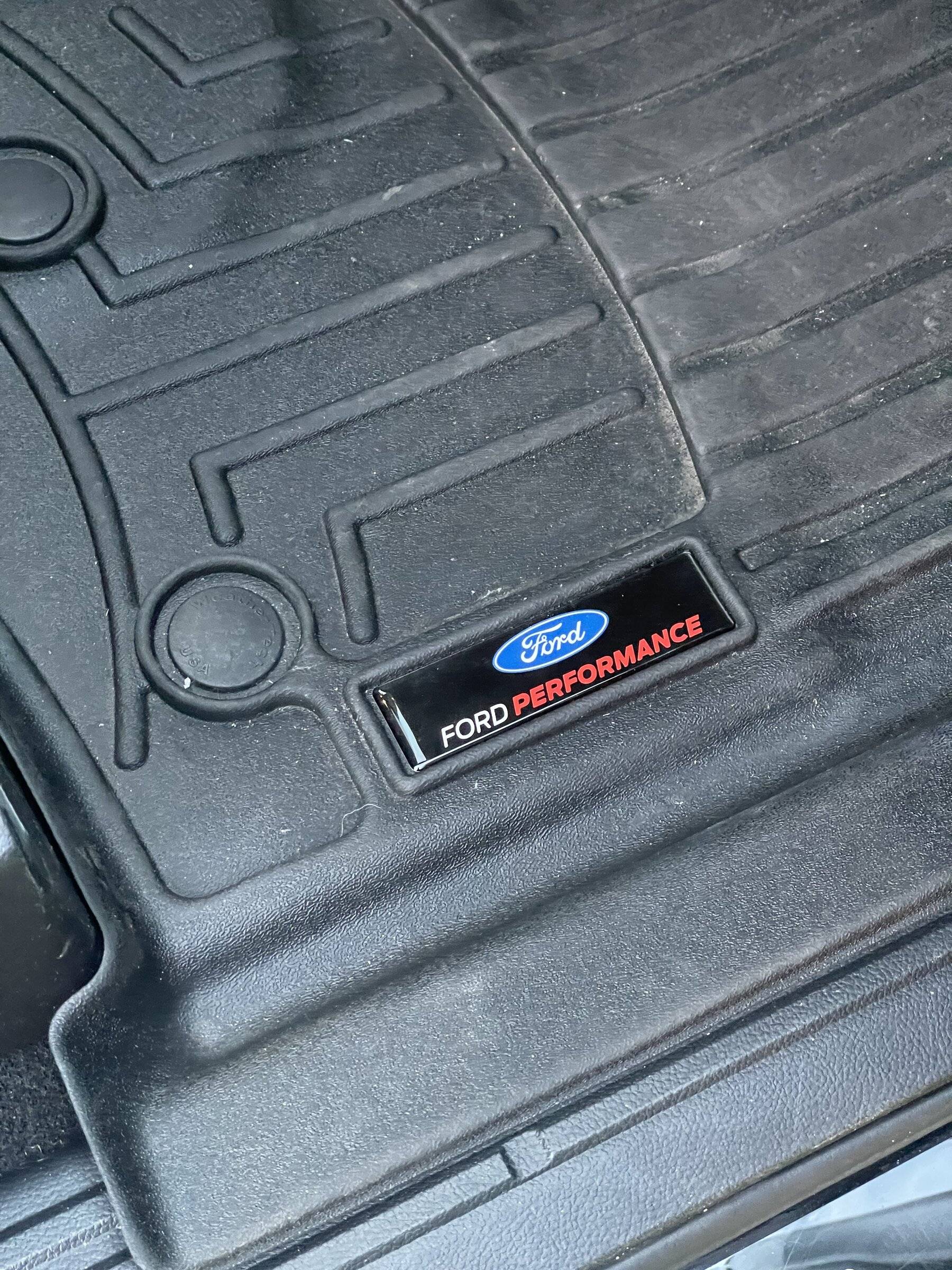

Put this on instead of the weather tech branding. Do Interior stickers count towards extra hp?
I was vacuuming my truck yesterday, and the Husky sticker came off the driver side mat. I wonder if it's the same size as these? Do you have the link for these?
My Husky sticker keeps coming off on the driver side too. Don't know if it is the same size as that.

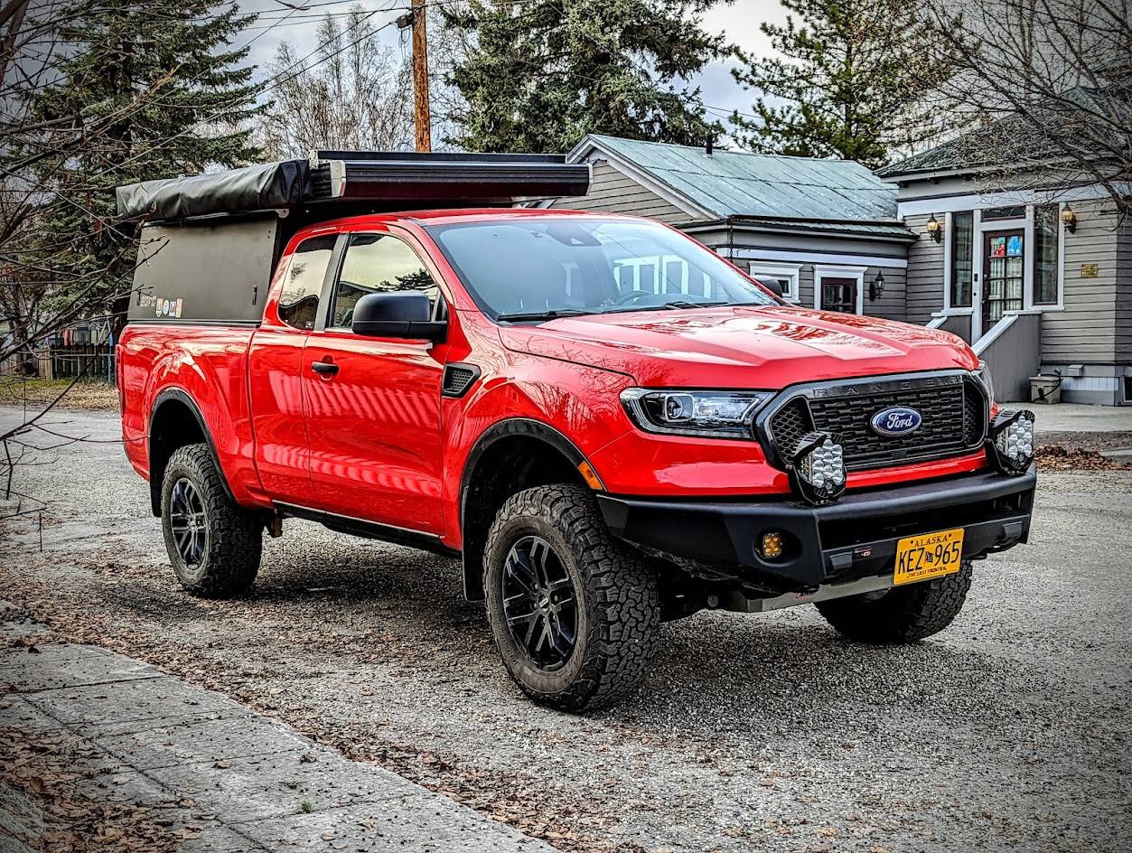

I only had one side at a time jacked up with a floor jack/stands. I had the sway bar bushing brackets loosened on the side that broke. For the passenger side I just disconnected the end link before I started and had no issues.
