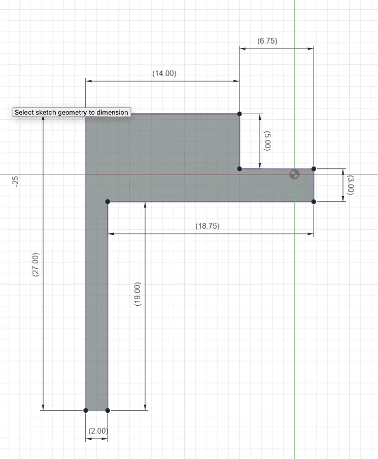

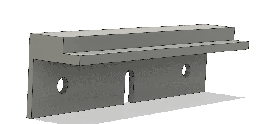

What mount are you using for the amber markers in the top slot?
I printed some polycarbonate brackets. Holes are slotted for the lights, top ledge is the width of 1/4" VHB. Top edge is taller than the tape and allows for alignment against the back edge of the grill before pressing up to bond tape. Whole thing is offset so its inset just behind the top edge of the grill.

Nicely done. You may want to add a radius to the base of that 2mm section. It's a point of fracture.
