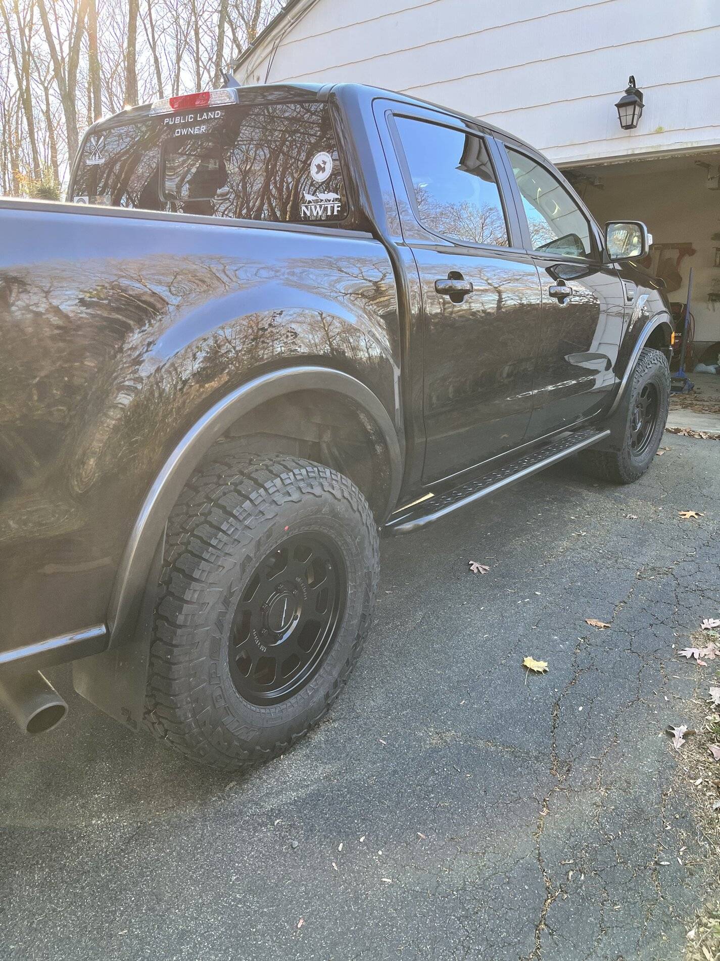

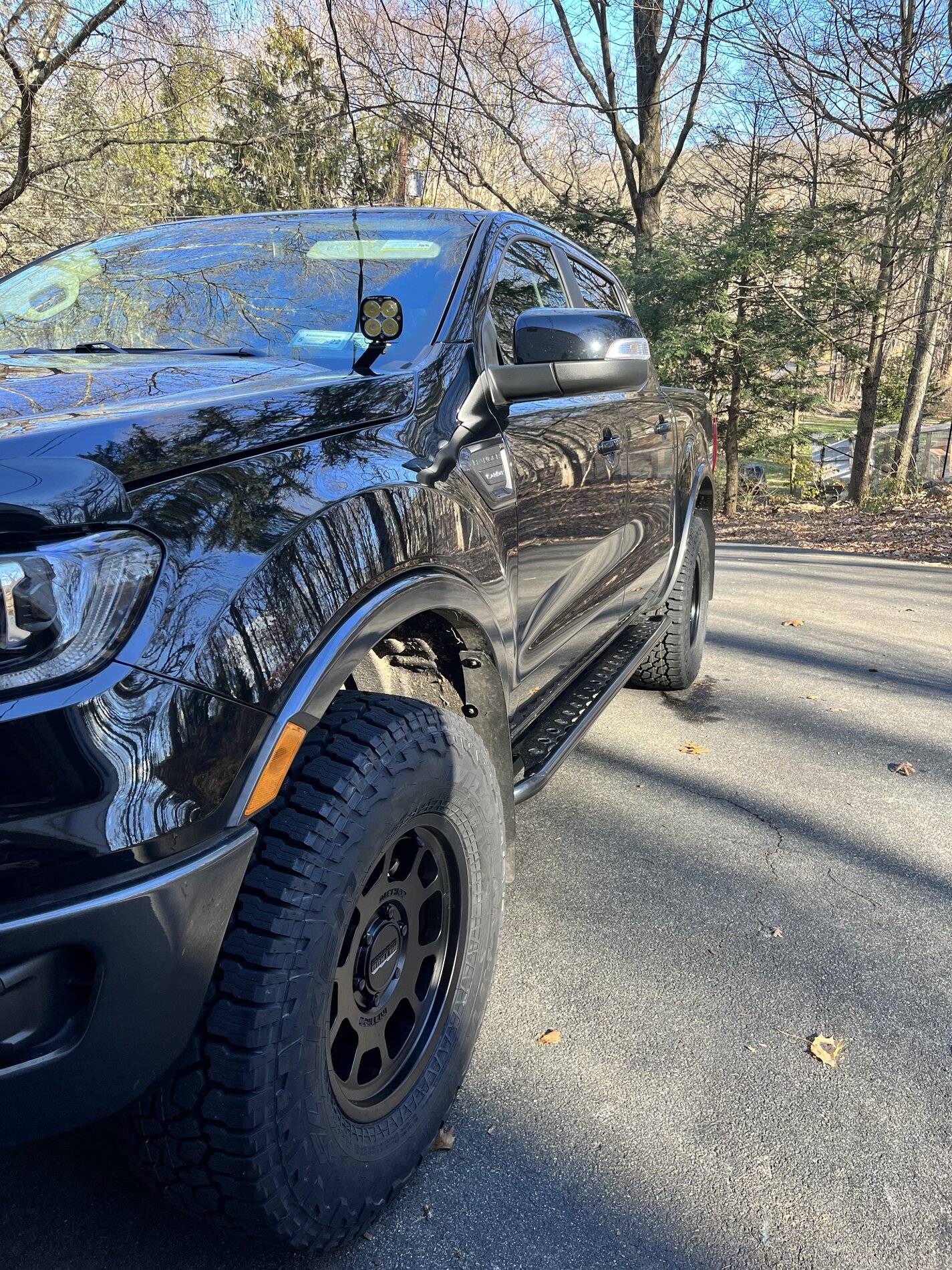

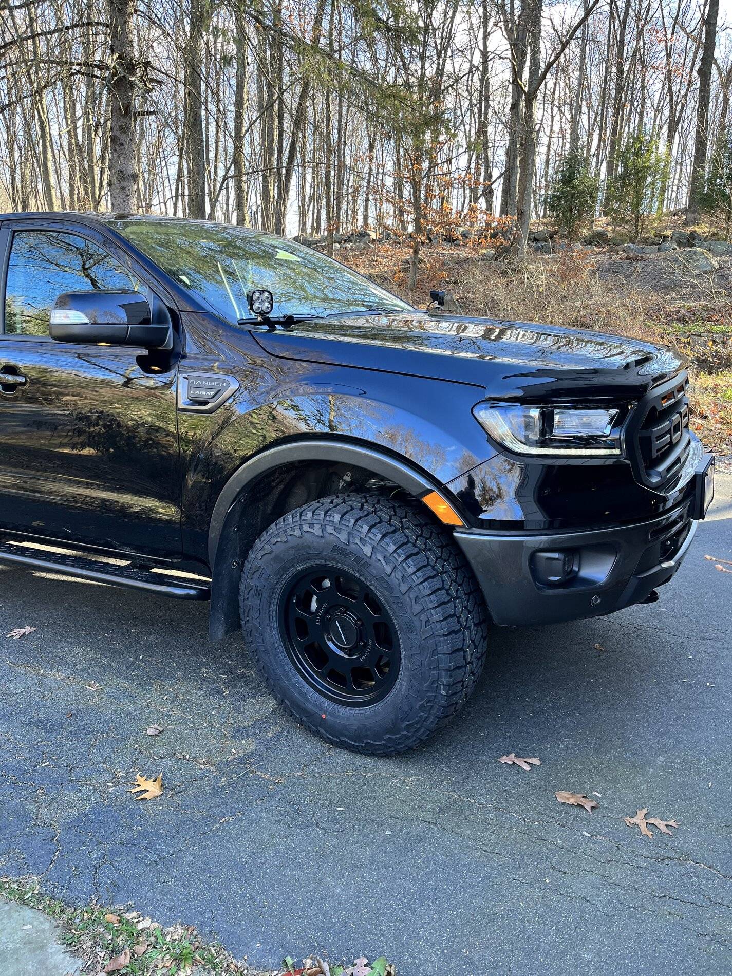

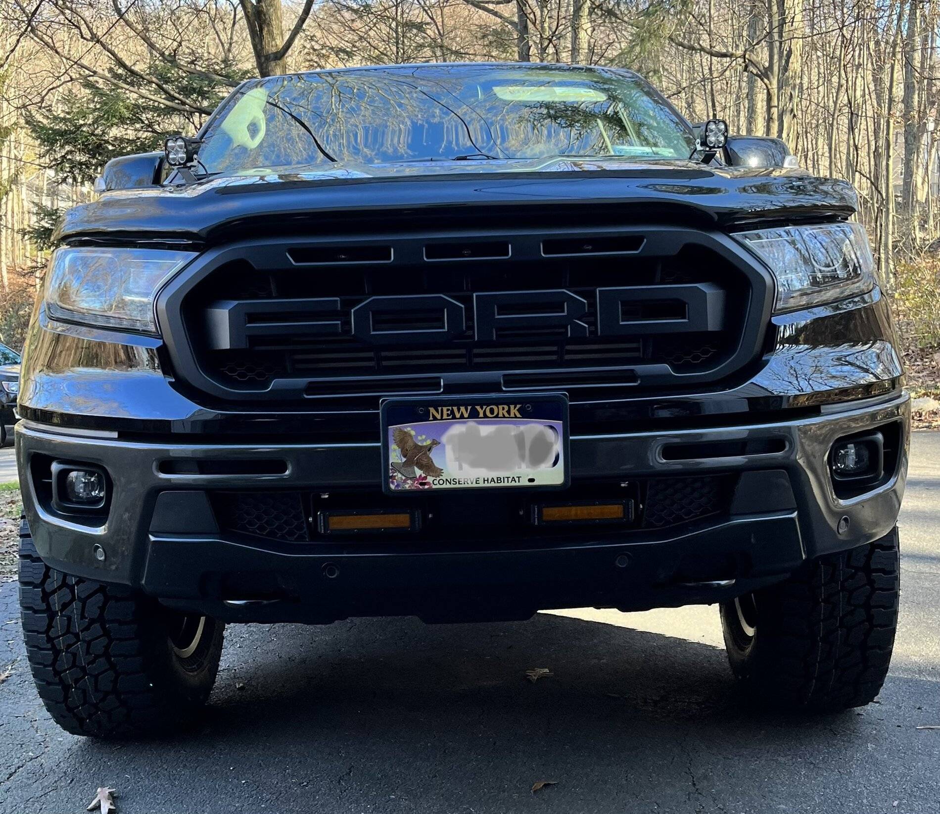

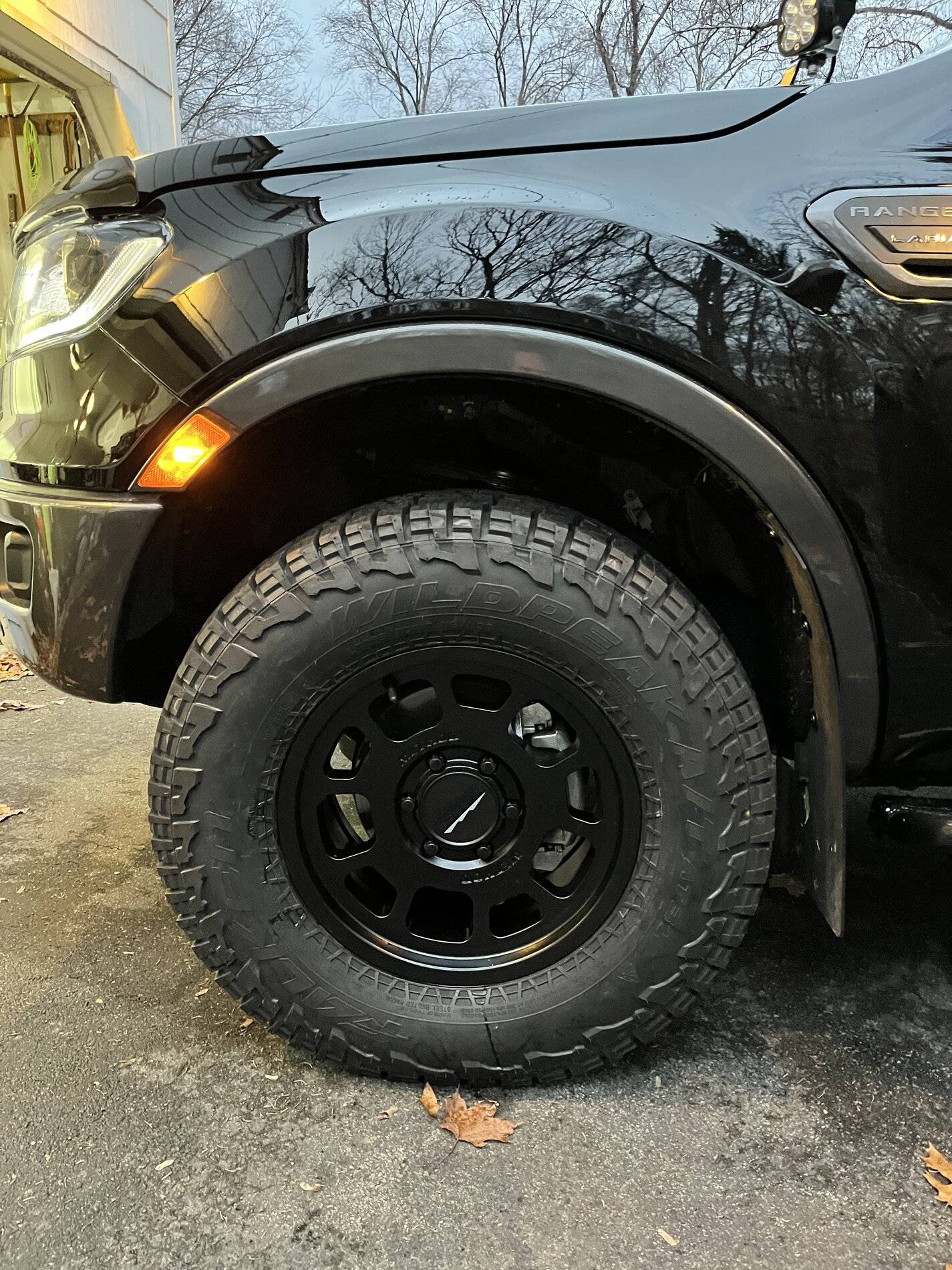

Swapped out wheels and tires on my Trenor for set of 286/70/17 Falken Wildpeaks on Merhod 705s.
To make fit I swapped out the factory crash bars with the Ready Lift bars. Used my Livernois programmer to reset revs/mile. I think looks great and no rubbing or vibrations.

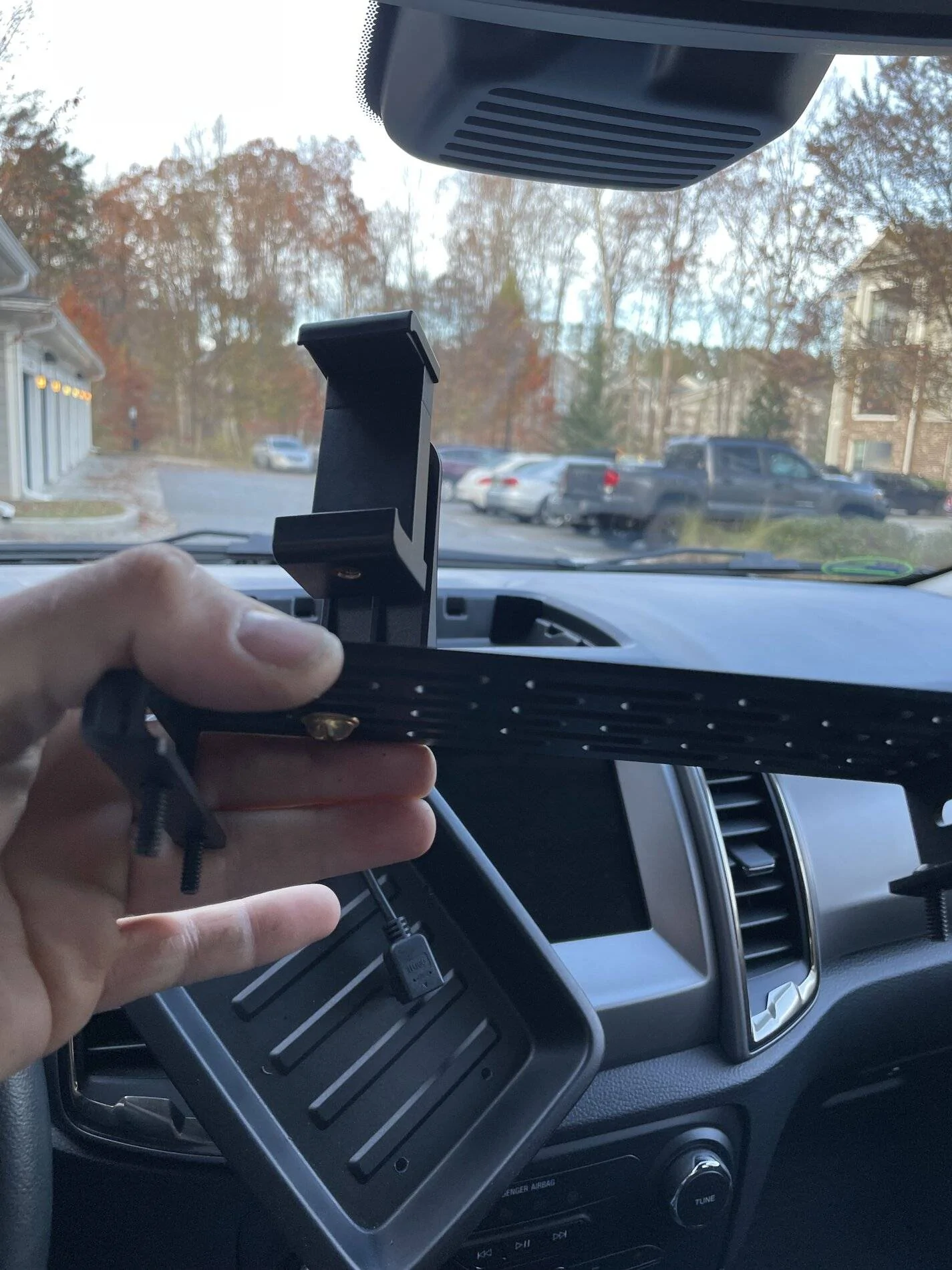

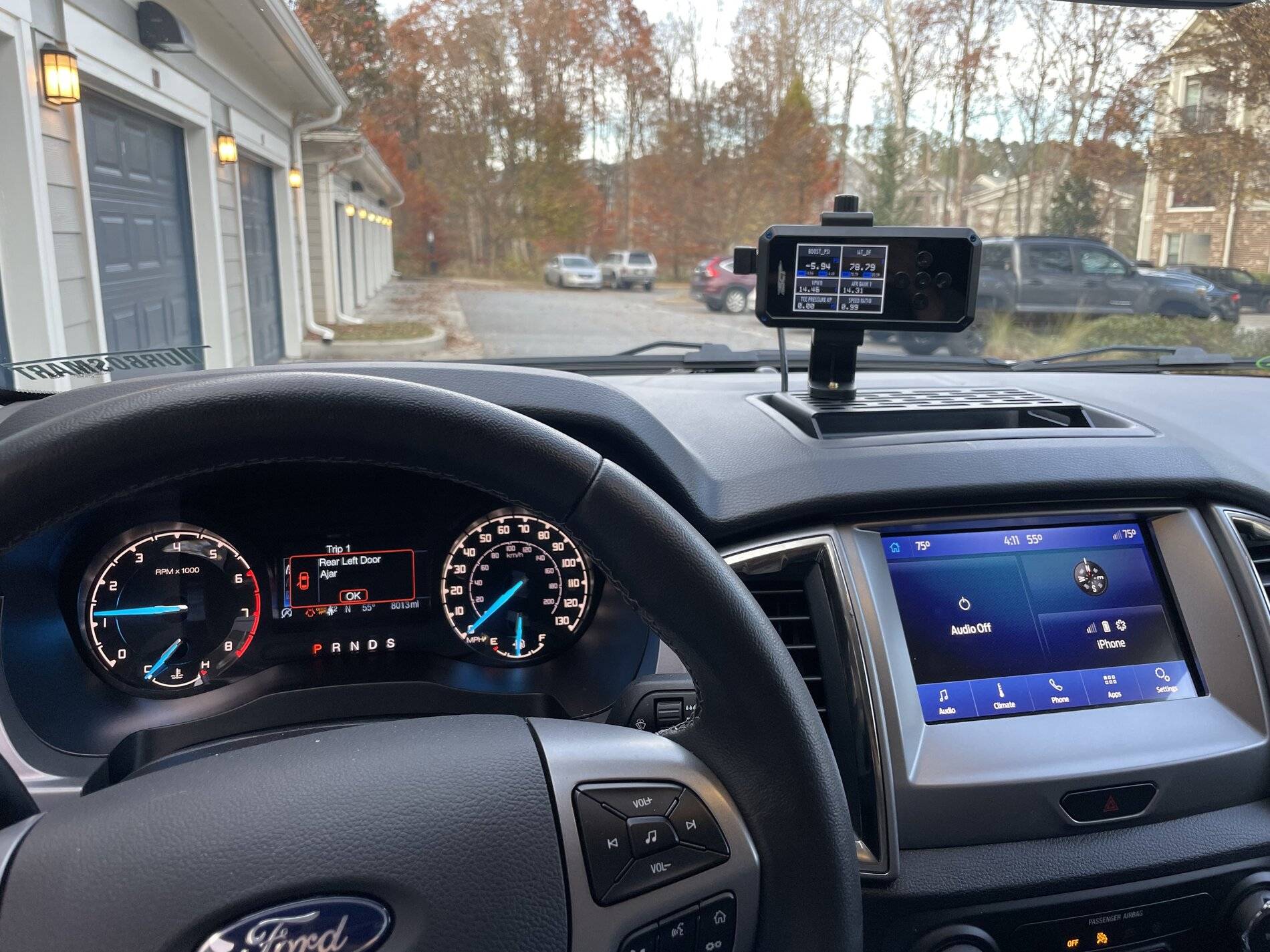

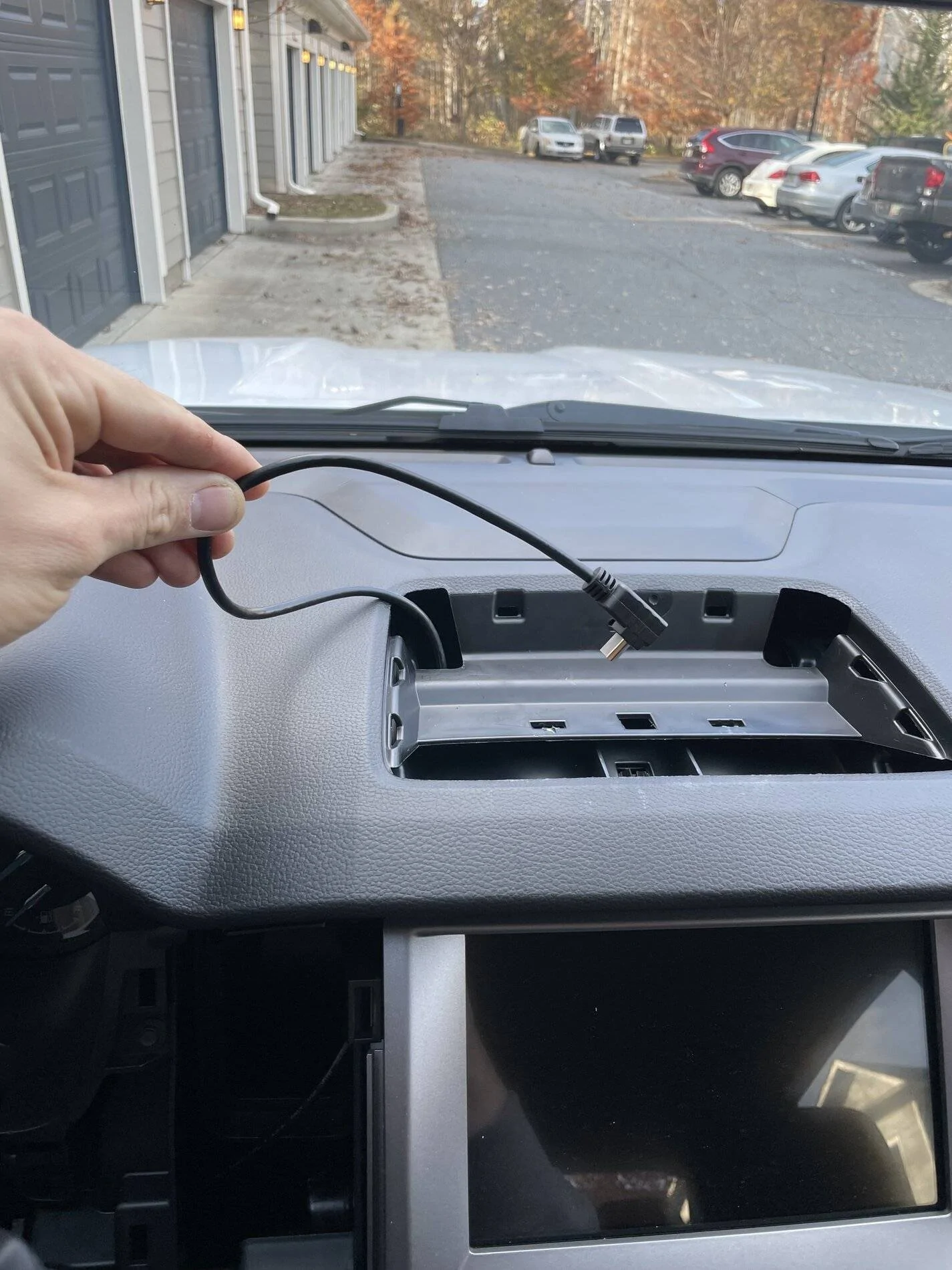

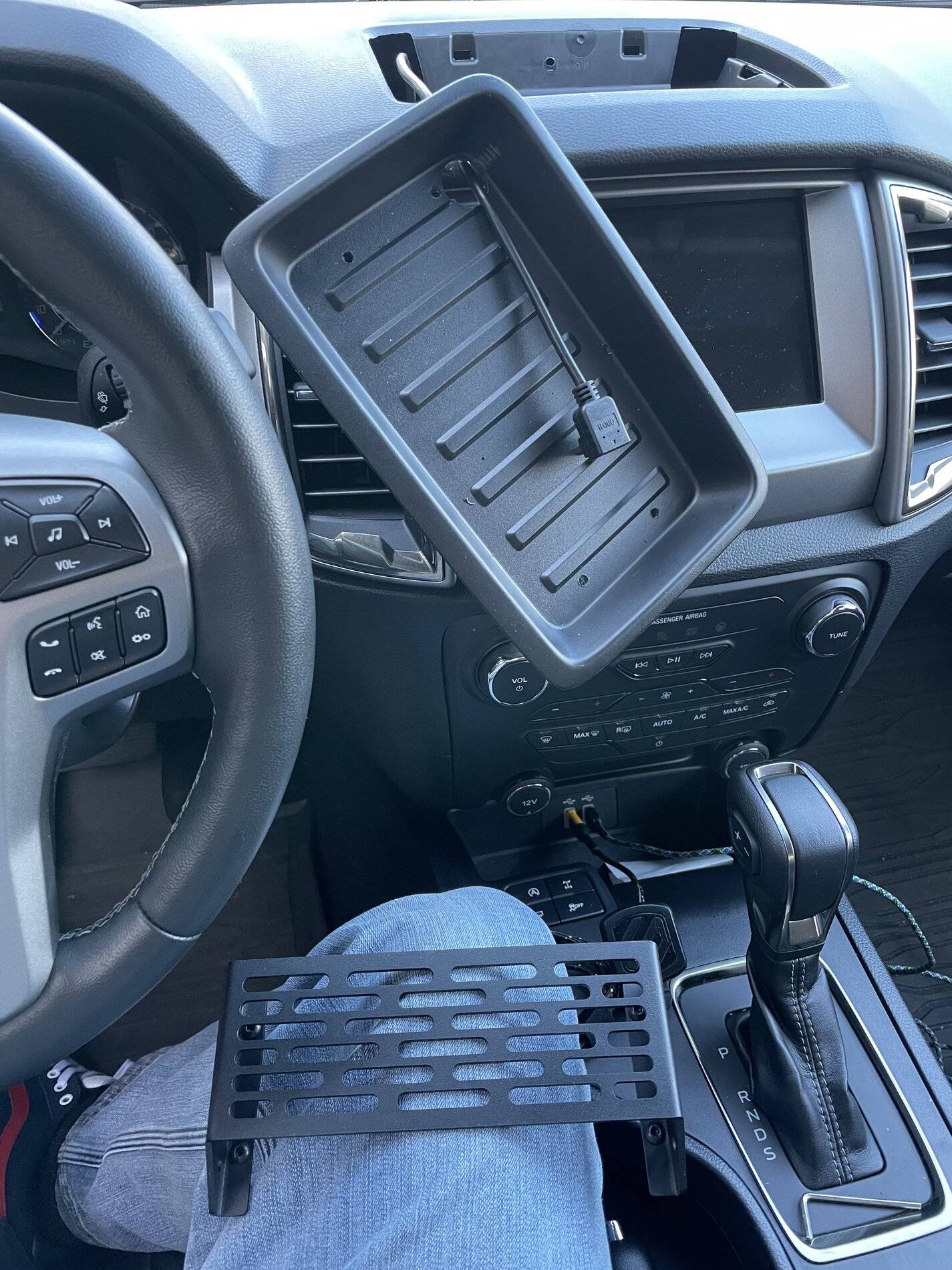

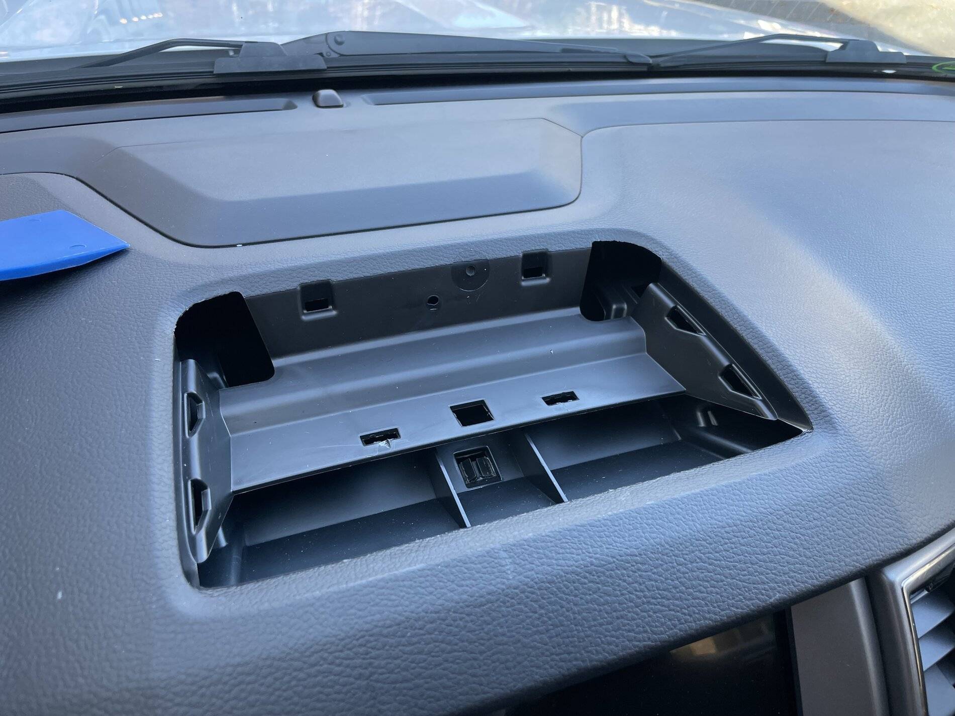

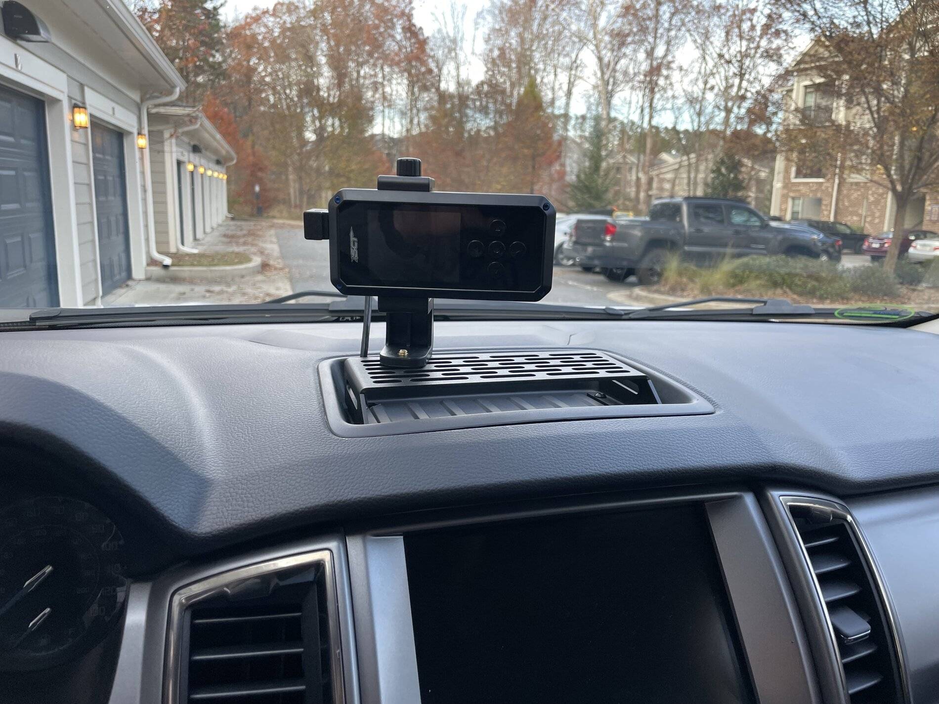

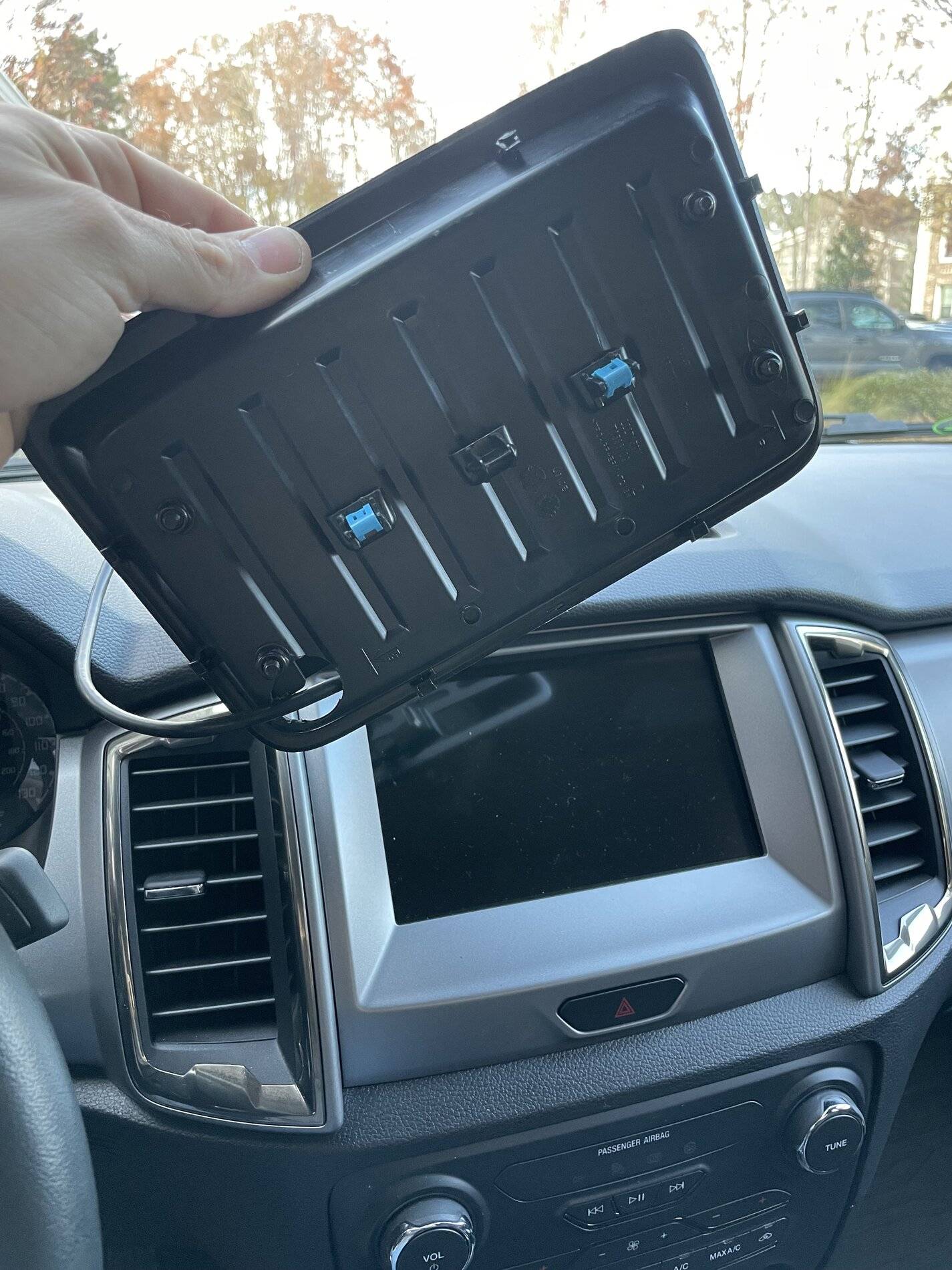

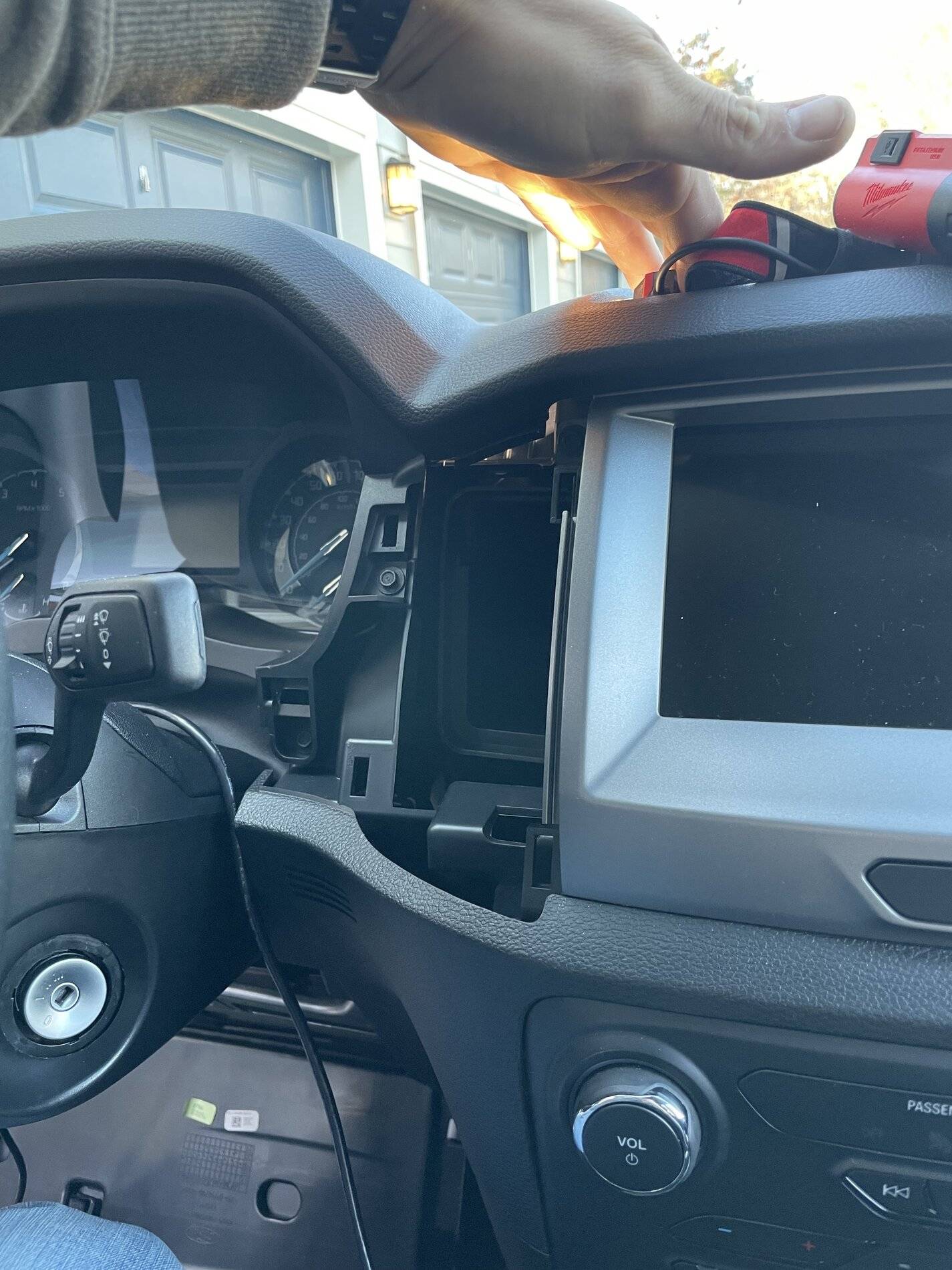

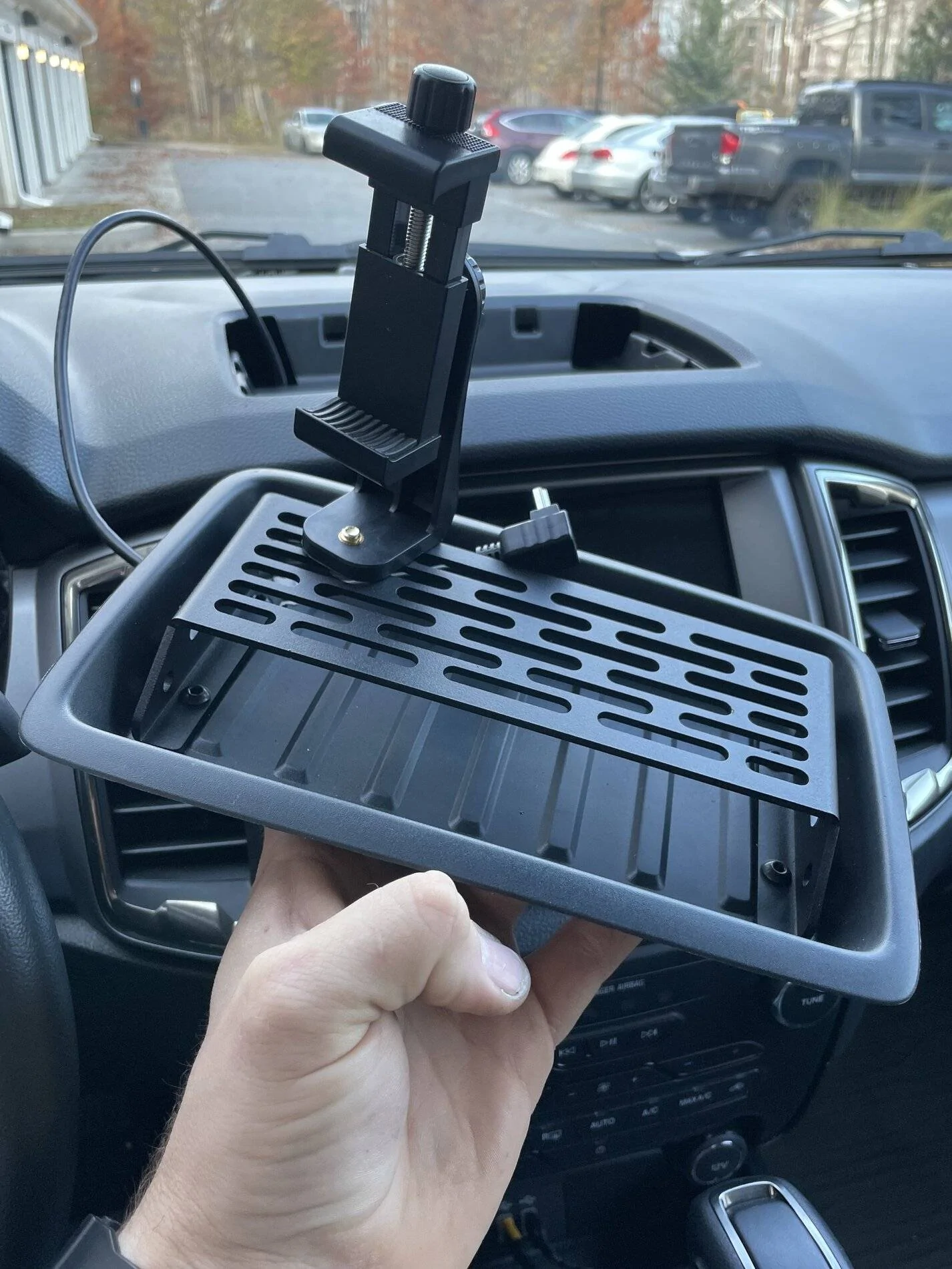

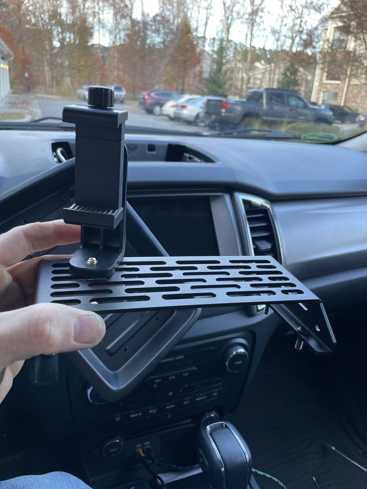

Installed a Built Right Industries top dash tray table to hold my SCT BDX tuner. Unfortunately, I used a plastic iphone to tripod adapter to hold the tuner which vibrates on rougher roads. Easy fix though, I will just replace with an aluminum one and all should be well.

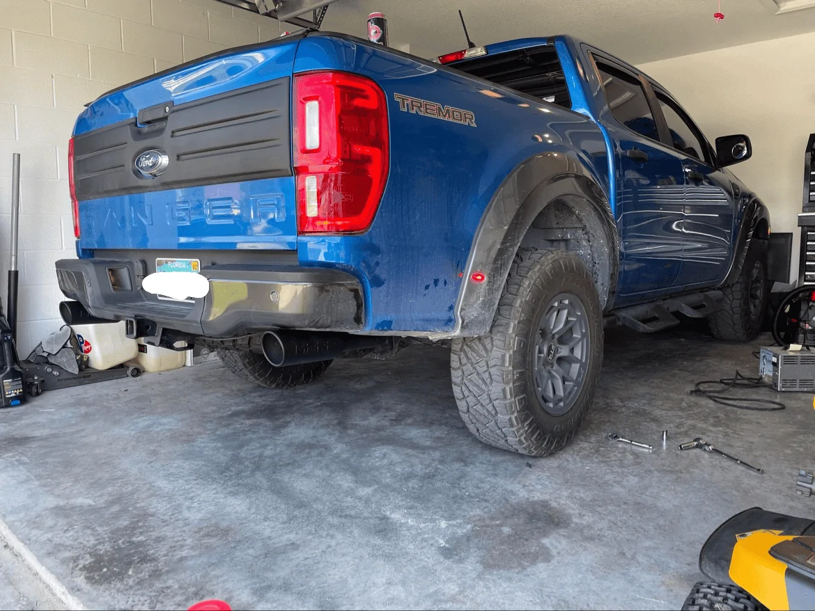

Threw on MBRPs dual exhaust. A tad bit louder than i thought but overall ok with the noise, its not obnoxious nor accentuates the 4 cyl note which is a big plus.
However, 3/5 clamps they provided straight up did not function, started this on turkey day and had to wait till friday to finish it cause of that. Other than that installation was decently easy. But i noticed no matter what, the exhaust seems to shift after driving; driver side shifts towards the bumper and the passenger side shifts down. I thought the y-pipe would be the culprit but that thing is on tight. I originally did everything at 45ft-lbs, but now redid them around 4 metric f-tons and they still tilt a tad after a drive. May have to go to an exhaust shop and see what they can do.
Waiting on next fuel fill up to see mpg increase, goes anywhere between 1-3mpg bump from my normal numbers. Getting 20-21mpg on 33's goin 76mph on the hwy is nice to see.

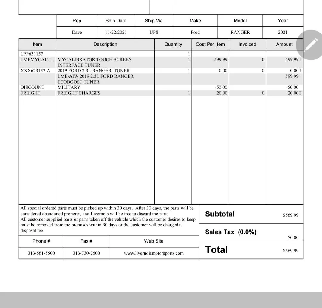

I pulled the trigger on this.
Received the tunes today and took it for test drive. I could definitely tell the difference. My neighborhood is next to the highway and is the only way out so I have to get to 70mph fast. With stock, it usually struggles when it hits 50, it still gets there but I feel like I'm putting to much pressure on the transmission. No issues with the tune. I chose livernois over the ford performance because I don't want to be stuck on 93 octane in order to use the tune. Overall very happy with it.

Nice to see you finally got the tunes. Which on are you running now? With the soft shift performance tune I barely notice any harsh shifting like I did with the performance tune. It will take a couple tanks to fully "learn" and once it does it'll fell like a ...?

Since they sent me the performance ones first, i installed it first. I'll stick with it for a little awhile. Then try out the soft shift. He told me they turn off the auto start stop by default now.

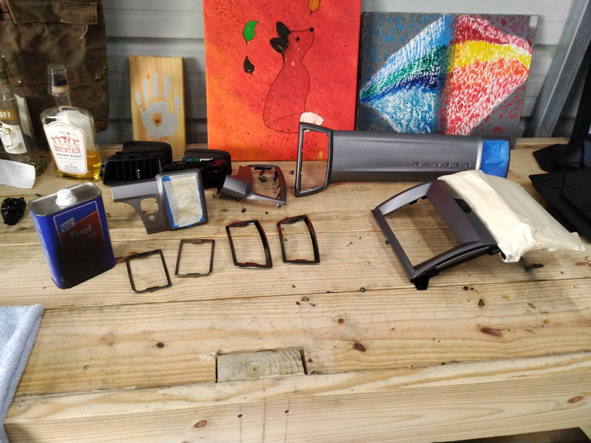

A project I've been wanting to do for a while now I finally got started.
Bye Bye silver/chrome trim.
Also, for those who want to remove their touch screen trim at some point in future, the guys at Ford made this ONE trim piece so you not only have to take the entire console out, but you would then have to remove these PITA tiny screws on the back of the console to get access to THE screws that actually connect the trim to the console. Ain't no body got time for that!
