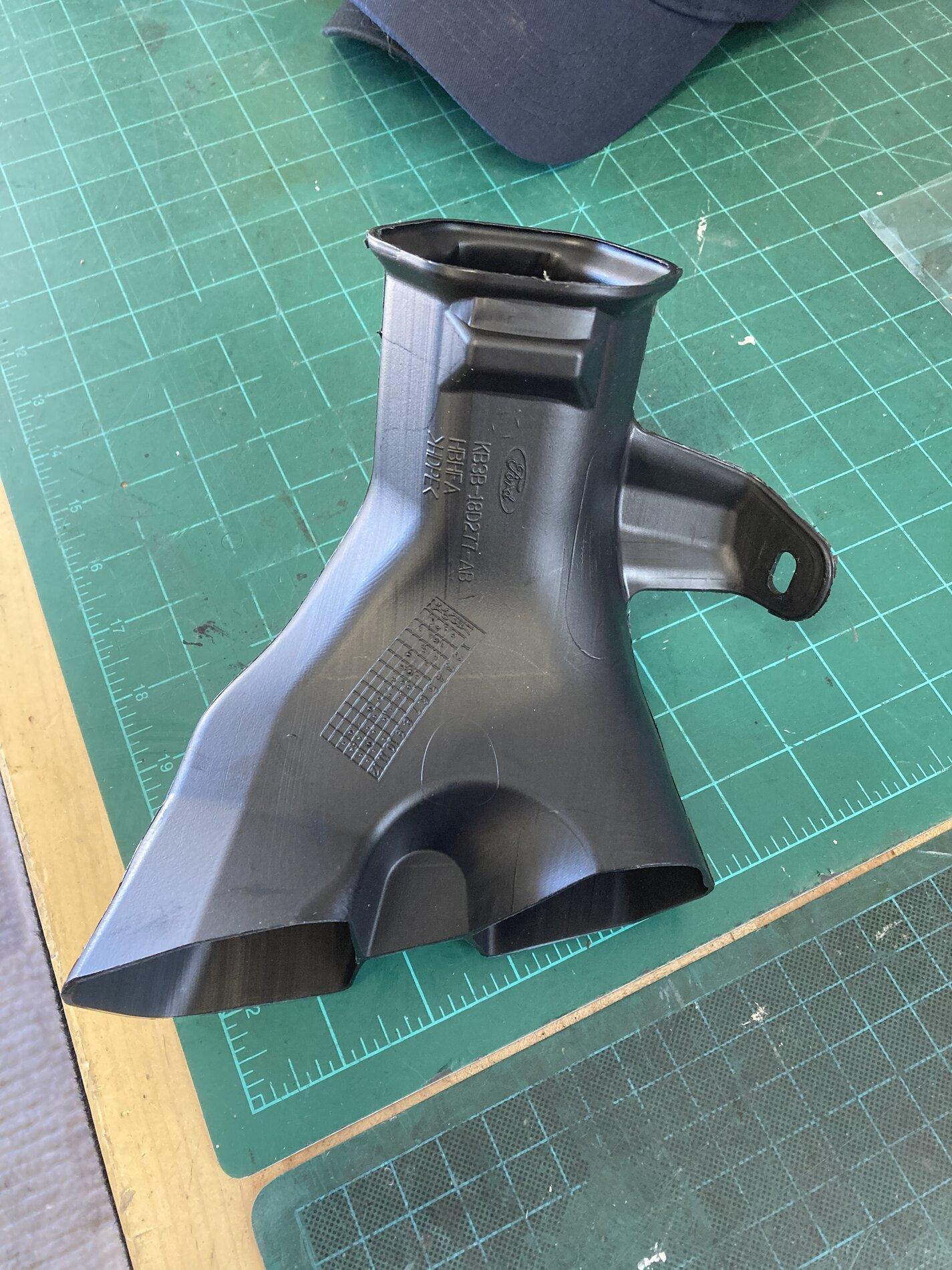

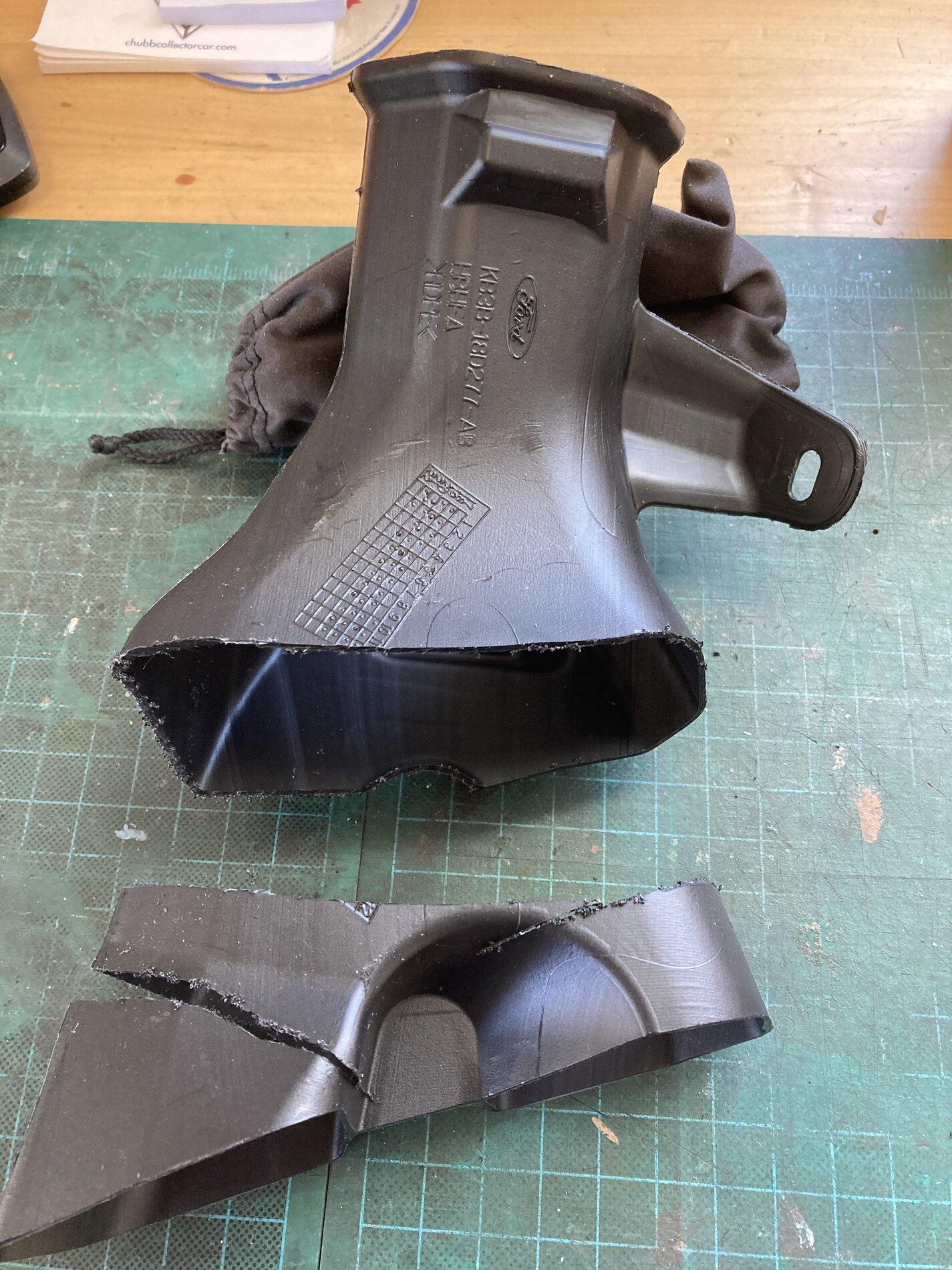

Today I remedied a nuisance. The vent on the driver side foot well hangs so low I was constantly kicking it. I wear a size 12 and it seemed like the toe of my boot was always making contact with something.
Turns out they put the floor vent right above the brake pedal.

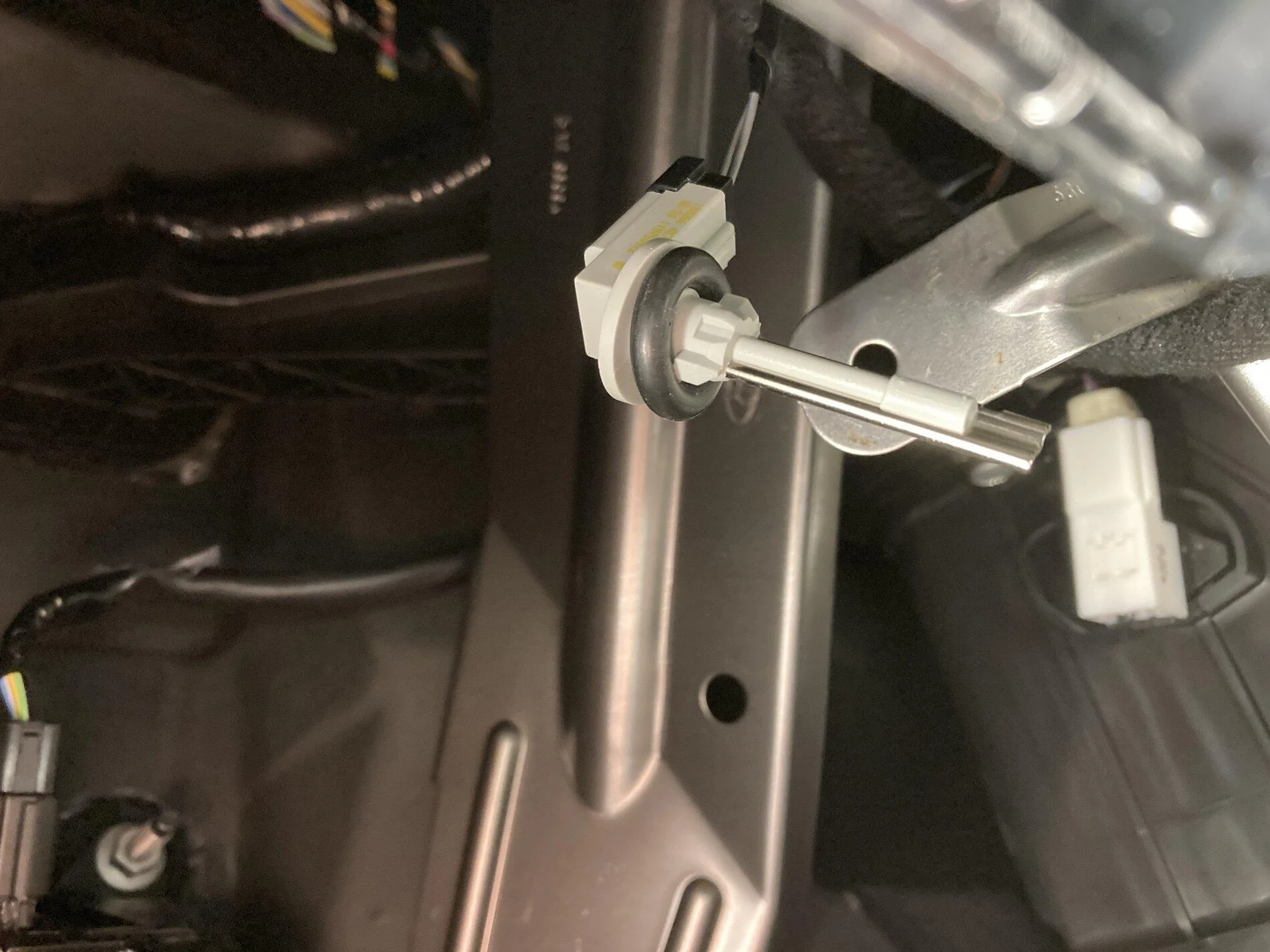

I was going to remove the whole end piece, but they put a temp sensor(?) in it.
So instead I just hacksawed a few inches off the end.
The temp sensor is just a 90 degree twist and it pops out, there is one plastic screw and socket and then the deflector just pulls off the upper hose.
problem solved.
