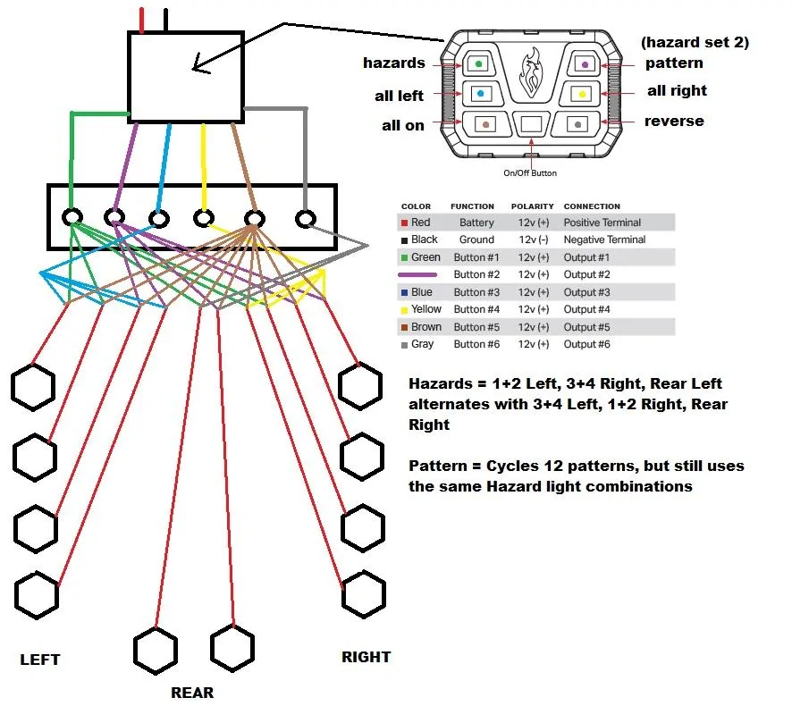

Edit (Problem Solved): My "all on" circuit was backfeeding all others (on the aux connection side) even when the switch was not engaged. So I can get everything else working fine by disconnecting all ten of those lines until my diodes come in.
Well my feniex 4200 mini is not working properly. All buttons light all lights. I am guessing I am going to need diodes to prevent backfeeding juice to everything. What a bummer.

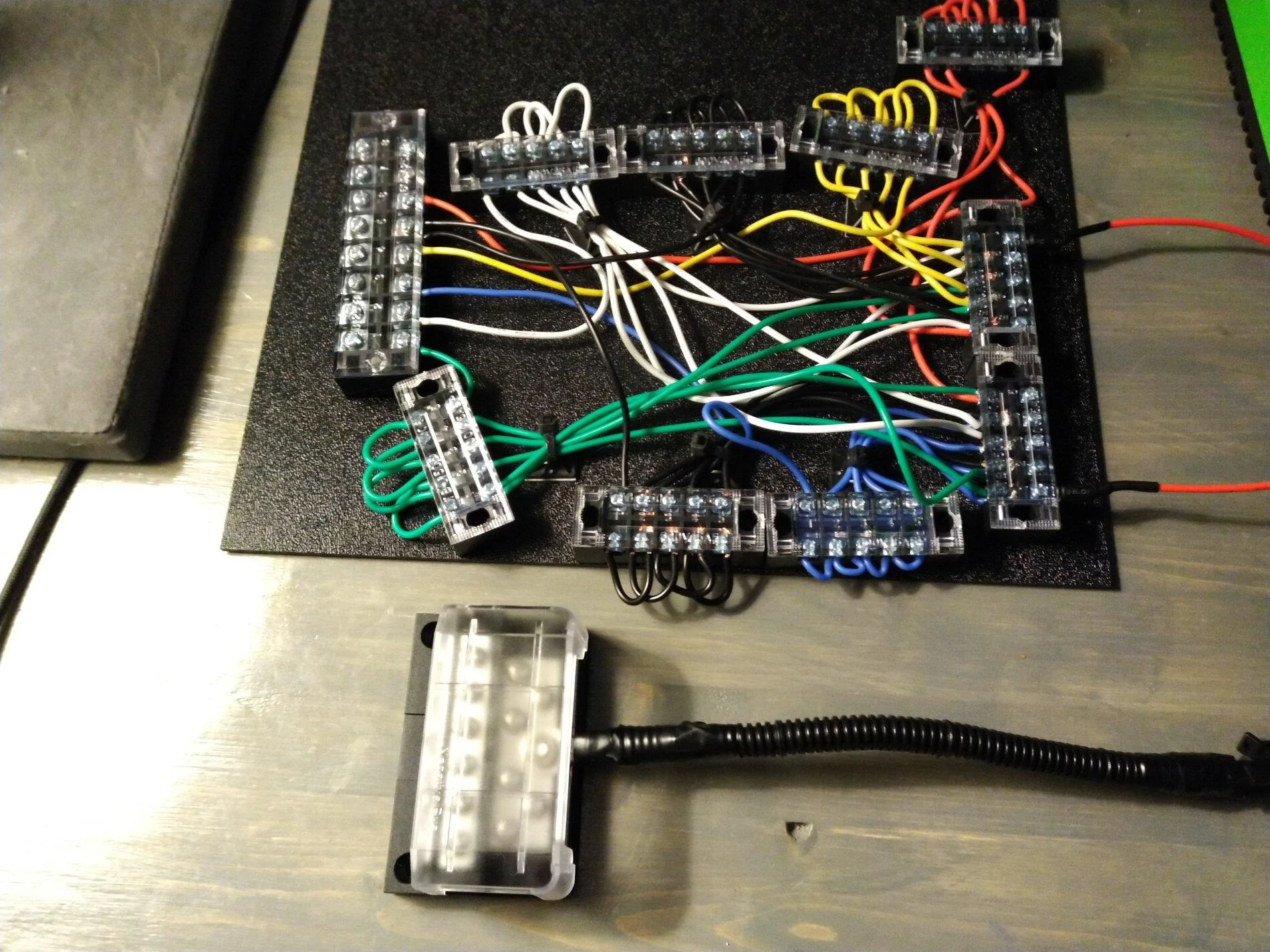

Any electronic wizards here? Here is the picture again of my junction as well as a picture of the general idea on how they are suppose to function. (in my case purple = white, but white wouldn't show up on white background. also black is brown (all on floods on) and red is reverse (grey). I simply didn't have those colored wires.)

WOW what is that gadget!? Nice work though!
Yeah current flowing backwards is always an issue in car wiring, but sounds like you got it figured out.

Controls 10 perimeter lights, (yellow) all right, (blue) all left, (black) all on, rears (red) and a 2 channel strobe (green & white).
Turns out my green and white circuits were back feeding too because they are setup in a way to alternative between lights on all sides of the rack. That means they crossed channels like the all on circuit wiring. So until my diodes come in and I get another set of days off to finish the wiring I will only have all right, all left, and reverse operational.
Edit: Sorry I misunderstood, to answer your question it is a Feniex 4200 Mini controller. I got one from my work for free because a car was being re-equipped with something different. You can get them brand new on Amazon for about $110 I think.

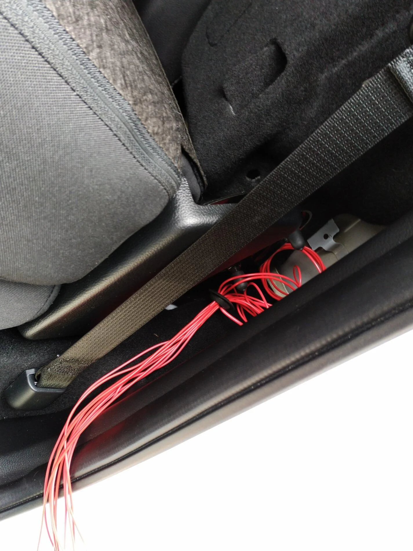

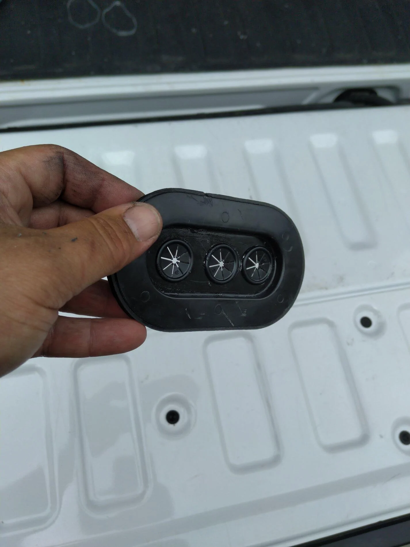

Disclaimer is post was made using speech to text.

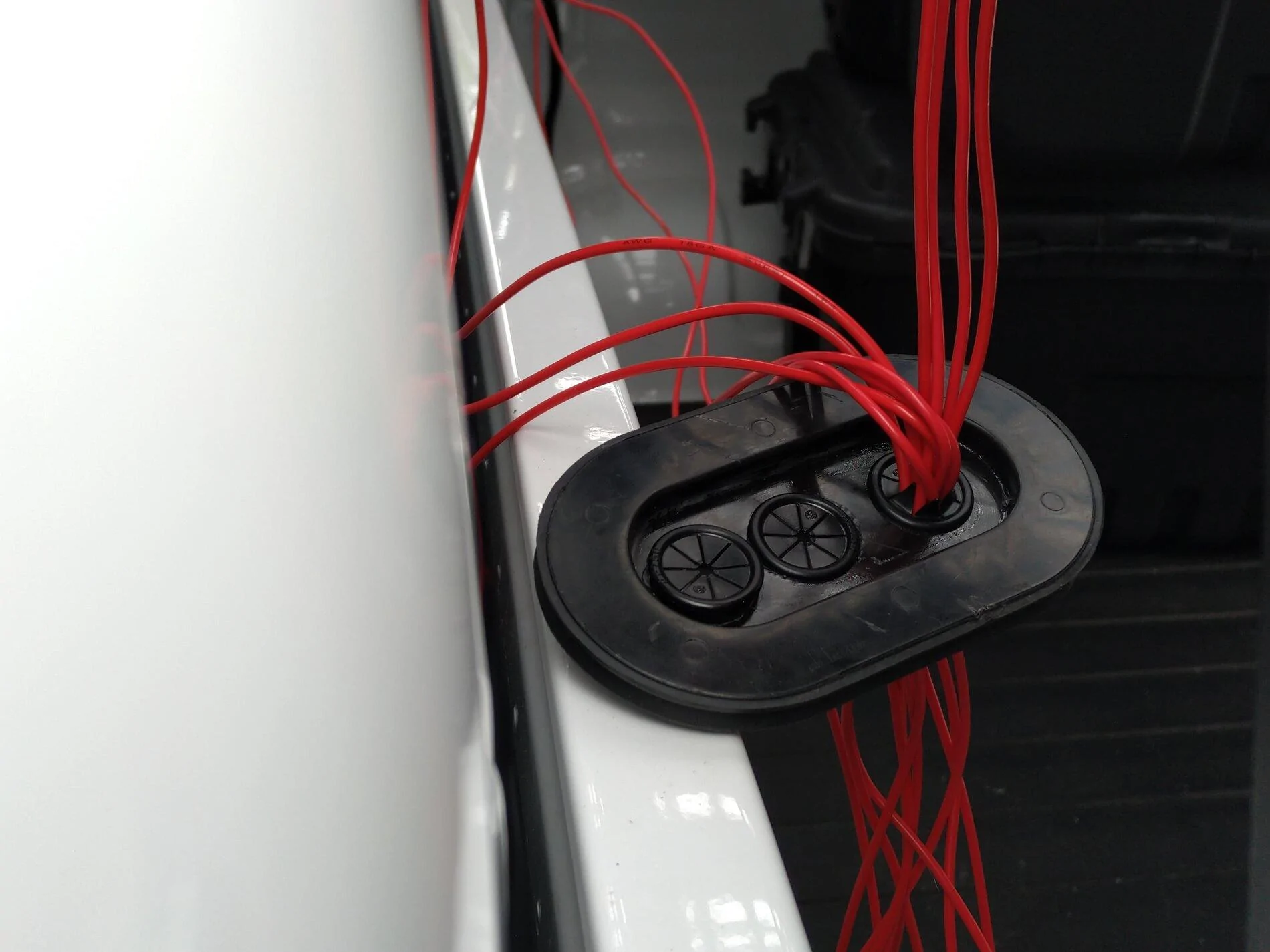

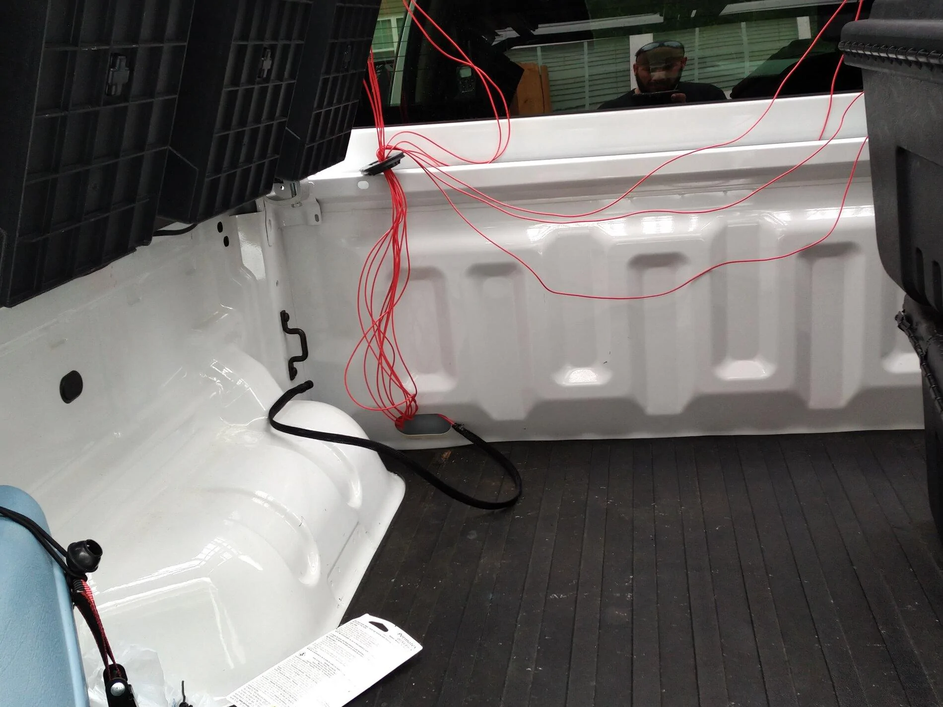

Spent most of yesterday getting the wiring run from behind the rear seat where the junction controls will be out the back and into the bed. I popped out the grommet for the bed and then remembered that I had some small I think they're half inch rubber grommets that I use for my dash box to run the wiring and thought I could use it here and pre-drilled three holes. They ain't symmetrical but they'll serve their function and you can't really see him but keeps it nice and clean.
The bundle of wires is for the 10 perimeter lights the other larger single red wire was already back here when I was running something else for my third channel on my dash box. I'm going to cap it off as I'm not currently using it any longer but I'm sure something will come along that I can use that line.
