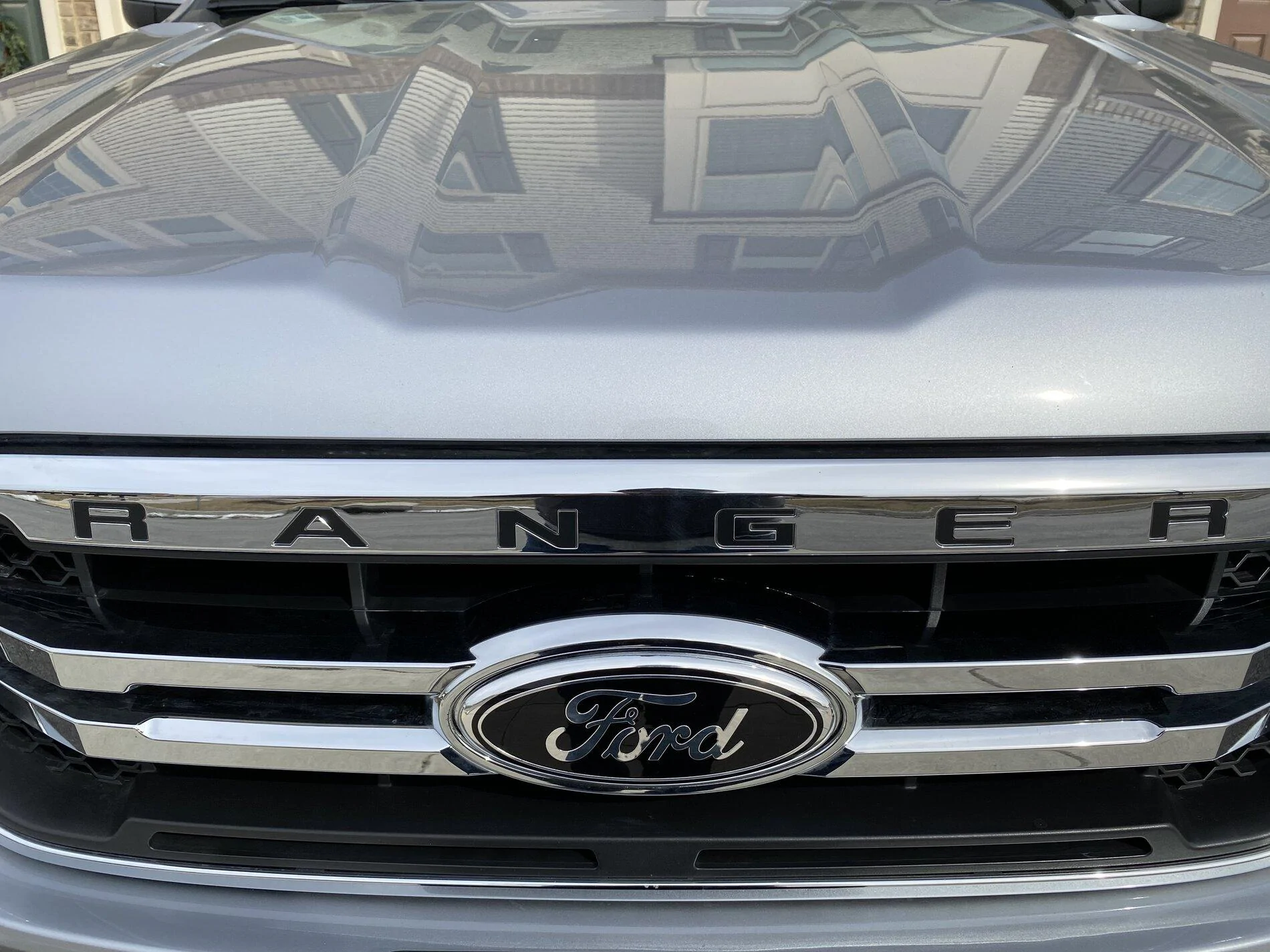

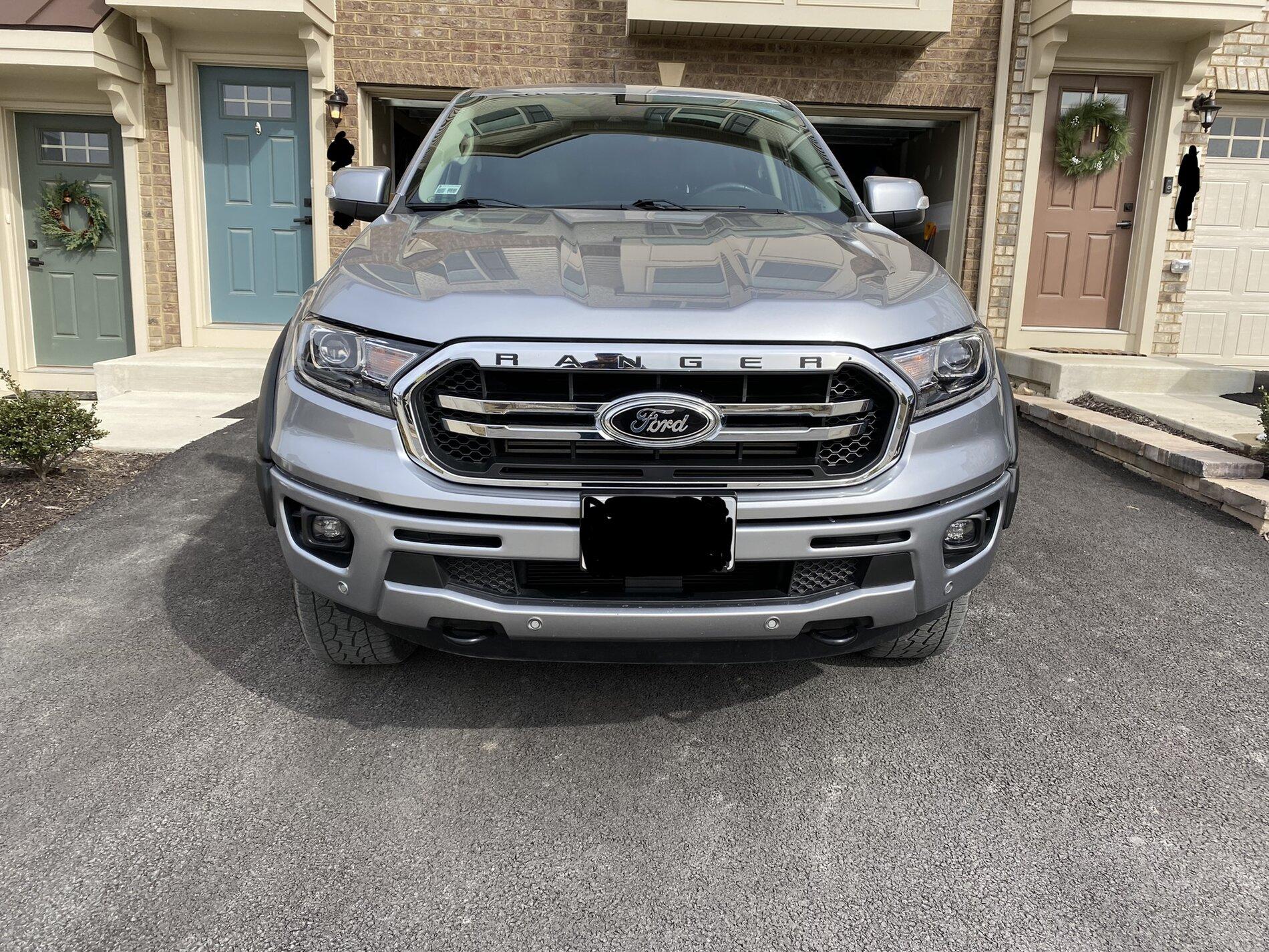

Put on my black/silver Ford emblems on the back and front. Also put my seahawk emblem on ;) (if it looks blue it’s because my recycling bin behind it).

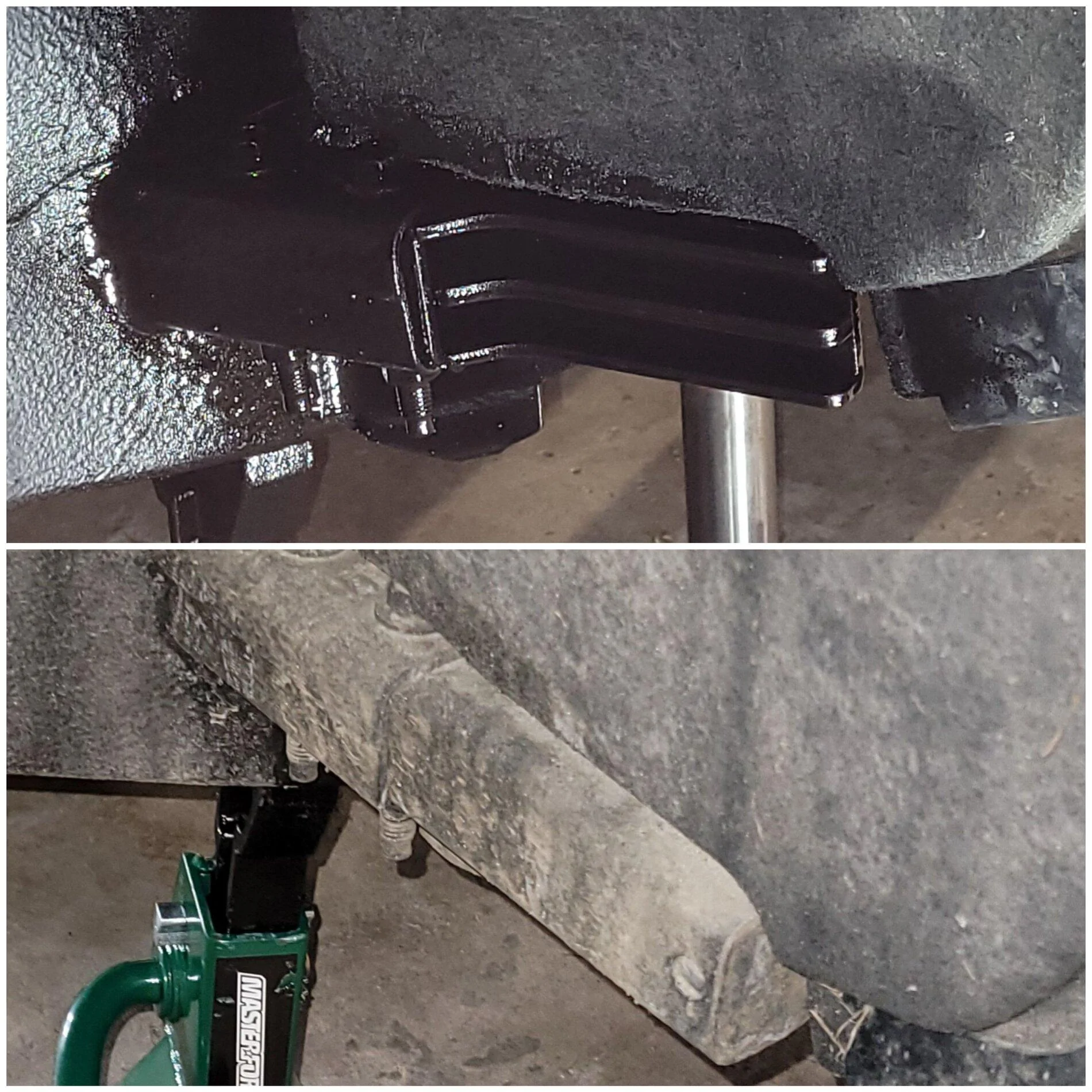

I swapped out my OEM Intrusion beams aka crash bars for the Readylift bars, impressive design, I am not a metal gauge guy and I forgot to take an end view side by side photo before install but to my naked eye these new bars appear to be every bit of 3/16" thick or a tad more and the OEM bars looked to be about 1/8th inch thick. I did attach before and after Pic collages, I used a Lenox Metal max 4.5" angle grinder blade to cut about 75% thru then finished that cut off with the Lenox medium to thick metal blades. If I owned a 6inch grinder I could've cut them entirely off, that blade is a beast! The Sawzall blades worked but I used them all, because of the angles and tight space I could only use part of each blade before dulling it or banging it and bending it too many times. If I had a lift I may have been able to cut more with the grinder from below, I didn't want to have my face right under the sparks laying on my back.
I sprayed bedliner on the new ones to help with corrosion, going to add 1 more coat later. I know they are powder coated but that's sure to take a beating on short order. The only other thing I did that wasn't on the instructions was to drill a small hole in the plastic liner and the hard plastic crash bumper behind and above the rear bar and ziptied it once to keep it from flapping and or rubbing and lessen debris. Due to pulling the liner back for install I wasn't sure if it would go back to its original state.
Broke my cheap impact wrench at some point prior to starting but my Ridgid cordless one was able to get the lugs off easily.
Used a Menards rebate check to buy a 12 ton bottle jack and a set of 6 ton jack stands, worked great ?

No bumper removal, removed the plastic shroud on the front bar , cut the bar off near the insertion spot, unbolted it , slid out the remainder and slid in the new one and bolted it in
The rear ones took a little more time, removed a few plastic fasteners and one screw to pull the wheel well liner back then removed 4 bolts to get the.plastic crash block or whatever it's called out of the way, that allows access to remove the outboard bolt after cutting the beam , cut the beam, remove 2 long bolts from the top (nut is welded onto the bottom) slide out the remnant, put the new bar in ,bolt it in per specs, reassemble the wheel well liner and put the wheels back on. I tried to remove the rear one without taking that plastic block off but it can't be done.
If you go to readylift.com and find the intrusion beams you can scroll down and open or download the instructions, all in color pics. Only confusing part was the picture of the rear beam was sideways and took a second to orient myself.

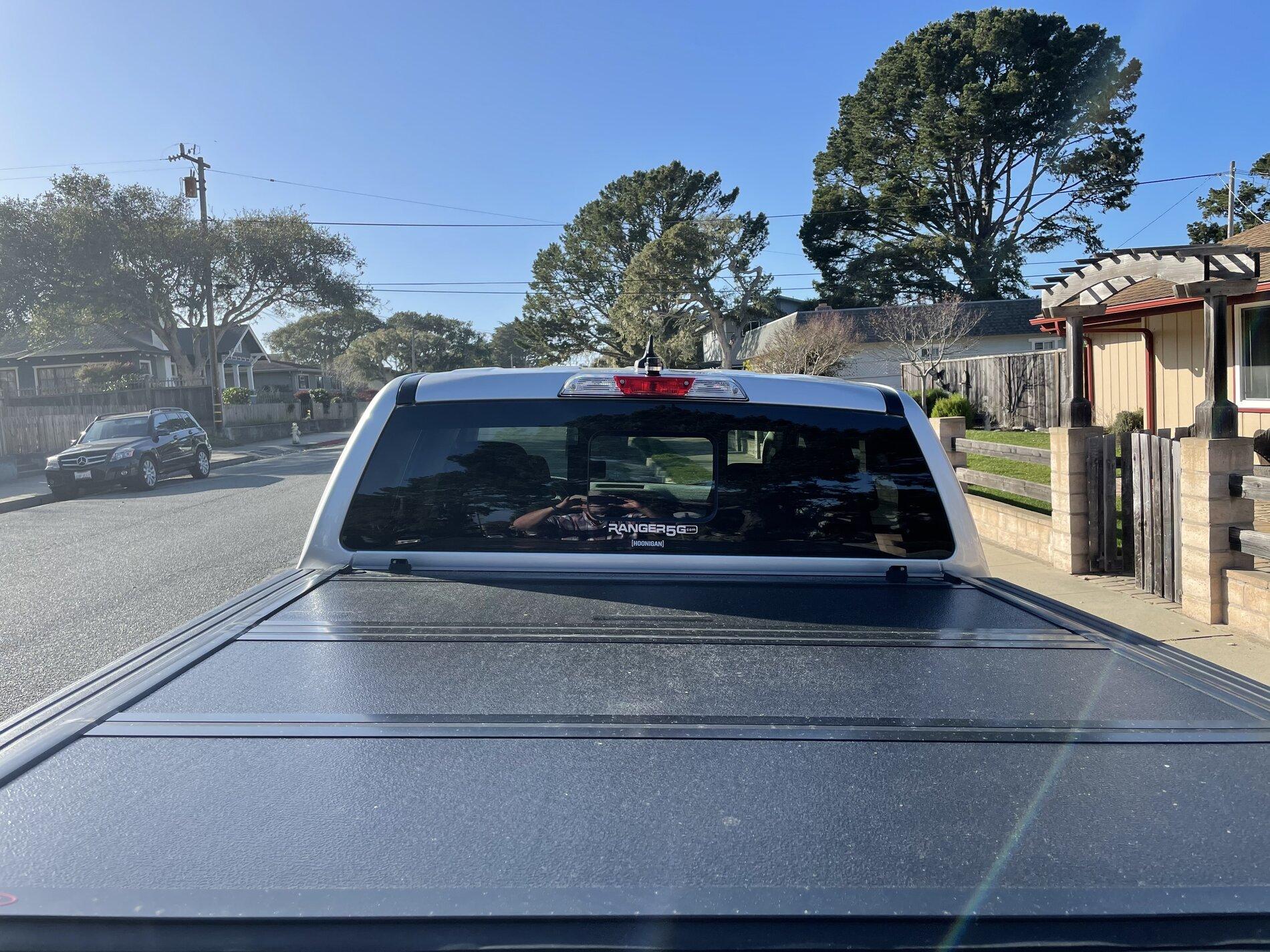

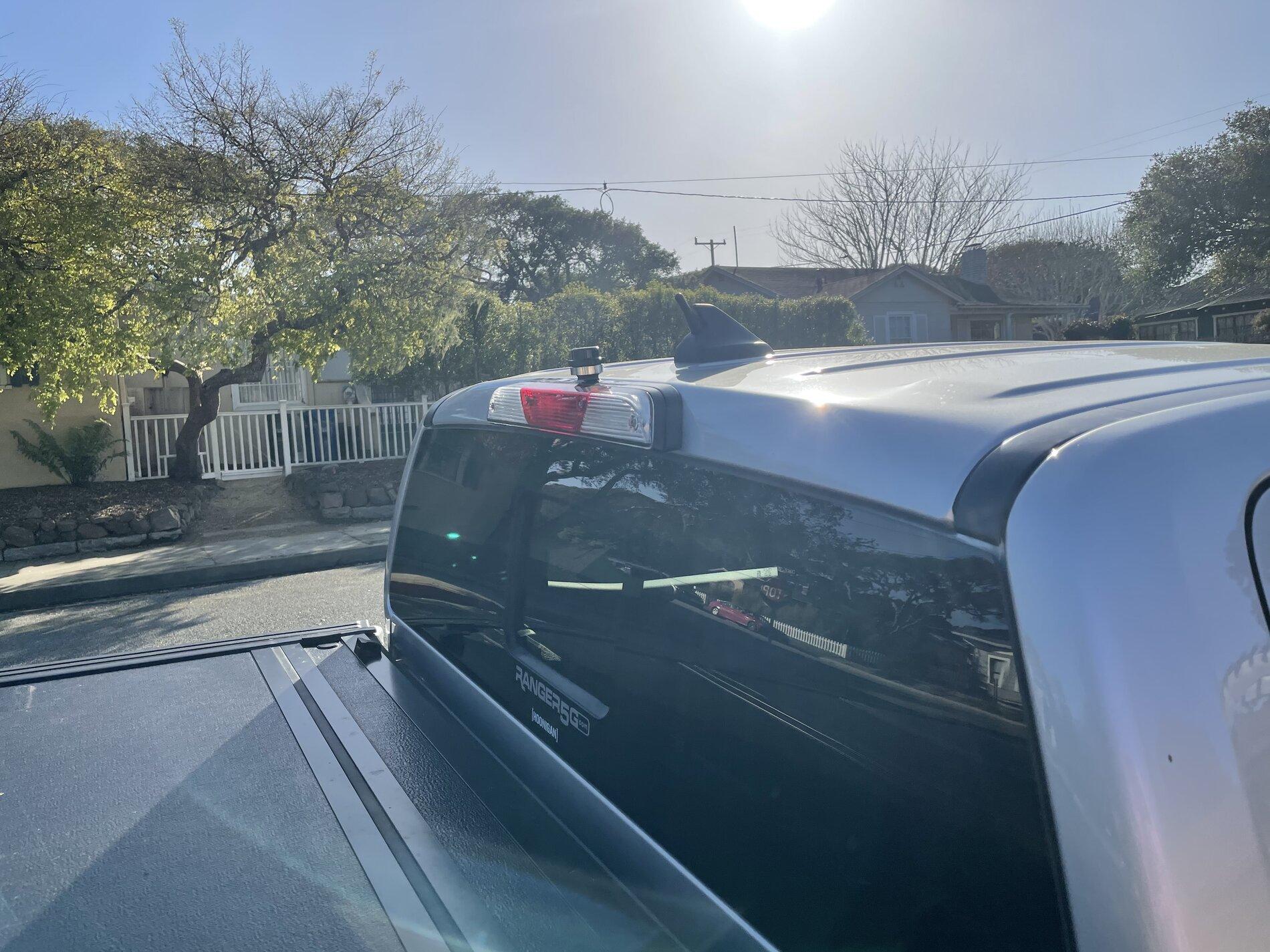

Installed the Bullet Proof mount today (thanks to @WxNerd2015 Trevor) for his great install build/pics to begin with and answer a question or two from me).
Take the time to read what others have done/directions and it took me about an hour by myself...including, yes having to uninstall it to route the cable through the middle roof slot (somebody had mentioned that in a thread, but duh?!). Hardest part is deciding how YOU want to do it.
I popped the C pillar panel edges along the back and the back panel bar, but did not completely take them out, just enough to route cable behind them. So the cable runs along the rear window top to the passenger C pillar panels, down the rear window C pillar edge ( under it) to the cross panel on rear wall. Underneath that panel to right above the first child restraint. Down and out that cutout.
Snap panels back into place, reverse of popping them and done.
My time was about 5 minutes each for setup, put away; 10 minutes to CAREFULLY pop the panels involved; 20 minutes to get the zip tie tip to where I could raise the liner and see the end of the zip tie to grab with needle nose plyers (this is where two people would be best); 10 minutes to route cable well so no panel pinching; about 10 minutes to pop panels back in, clean off, inspect and take a pic of final.
No drilling or cutting BTW.:whew:
