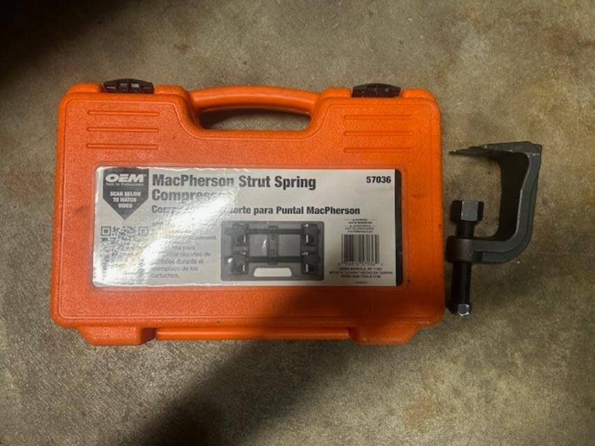

The Spring Compressor is AutoZone (Loan A Tool) with option to keep (I think I will keep it)
This fits over the coils perfectly and had no problems compressing the spring enough to get it apart.
When I did this professionally we had a wall mounted compressor (much safer) than this but it worked and just ensured I was taking it down slow and easy and my safety pins stayed in place.

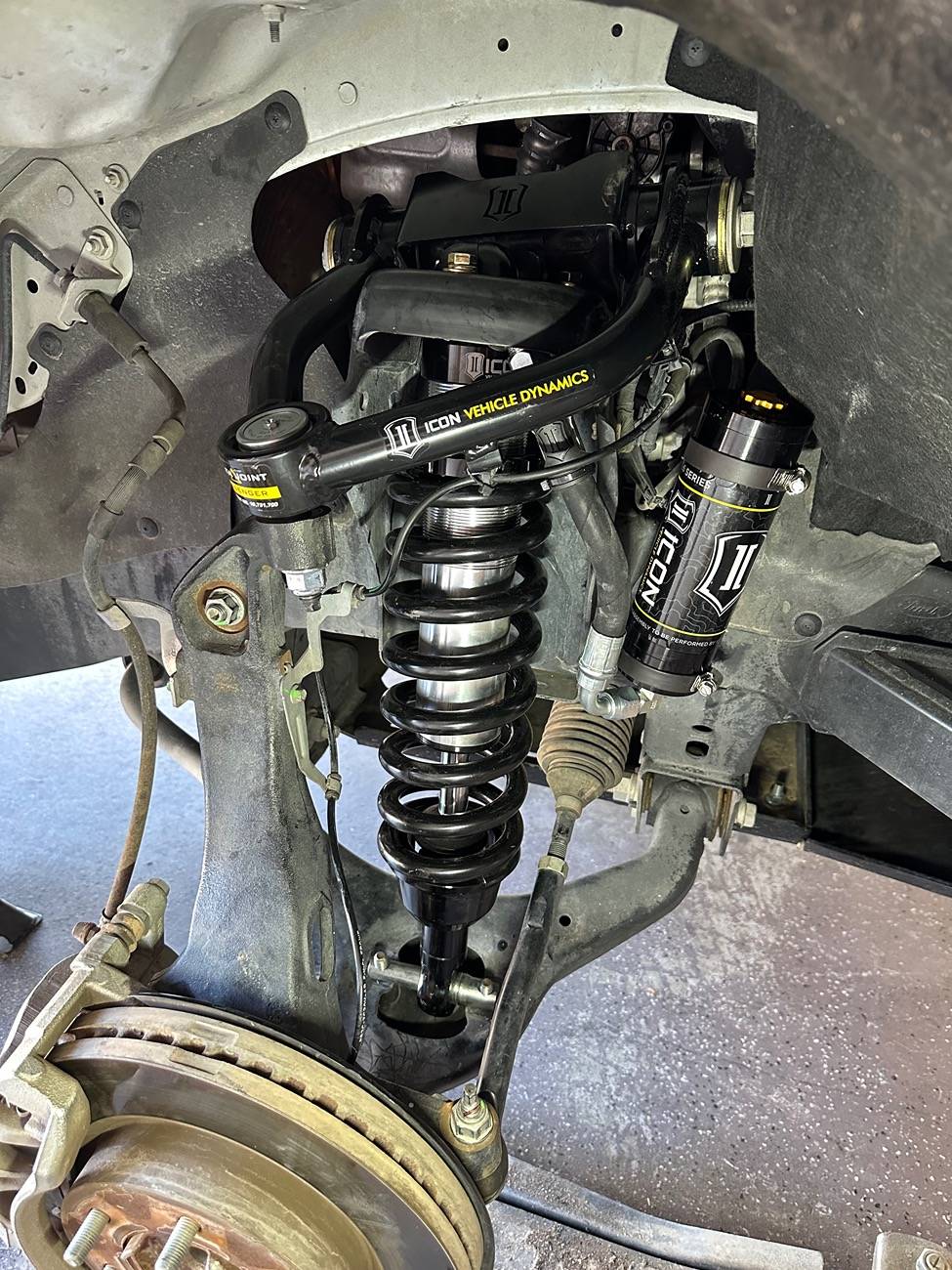

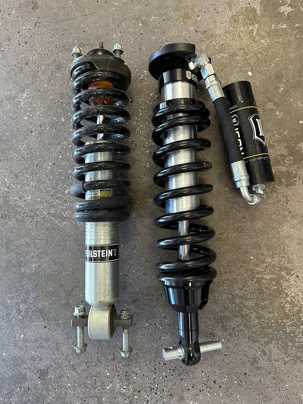

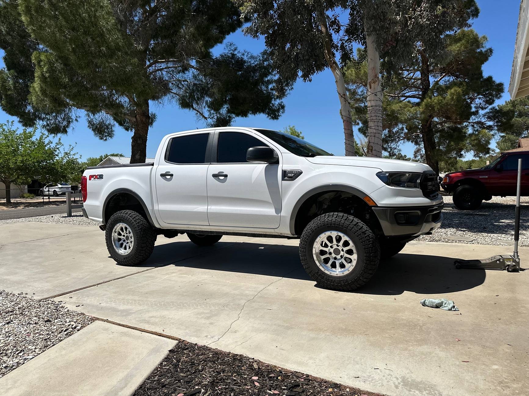

What a project, completed the full by myself, which in hindsight wasn’t the brightest idea. Suspension stuff is heavy! Ended up going with the extended travel coilovers from ICON and adjusted them to provide a 3” lift. Now the truck sits level and drives like a dream. If anyone is on the fence about coilovers, I say do it!
Looks good!

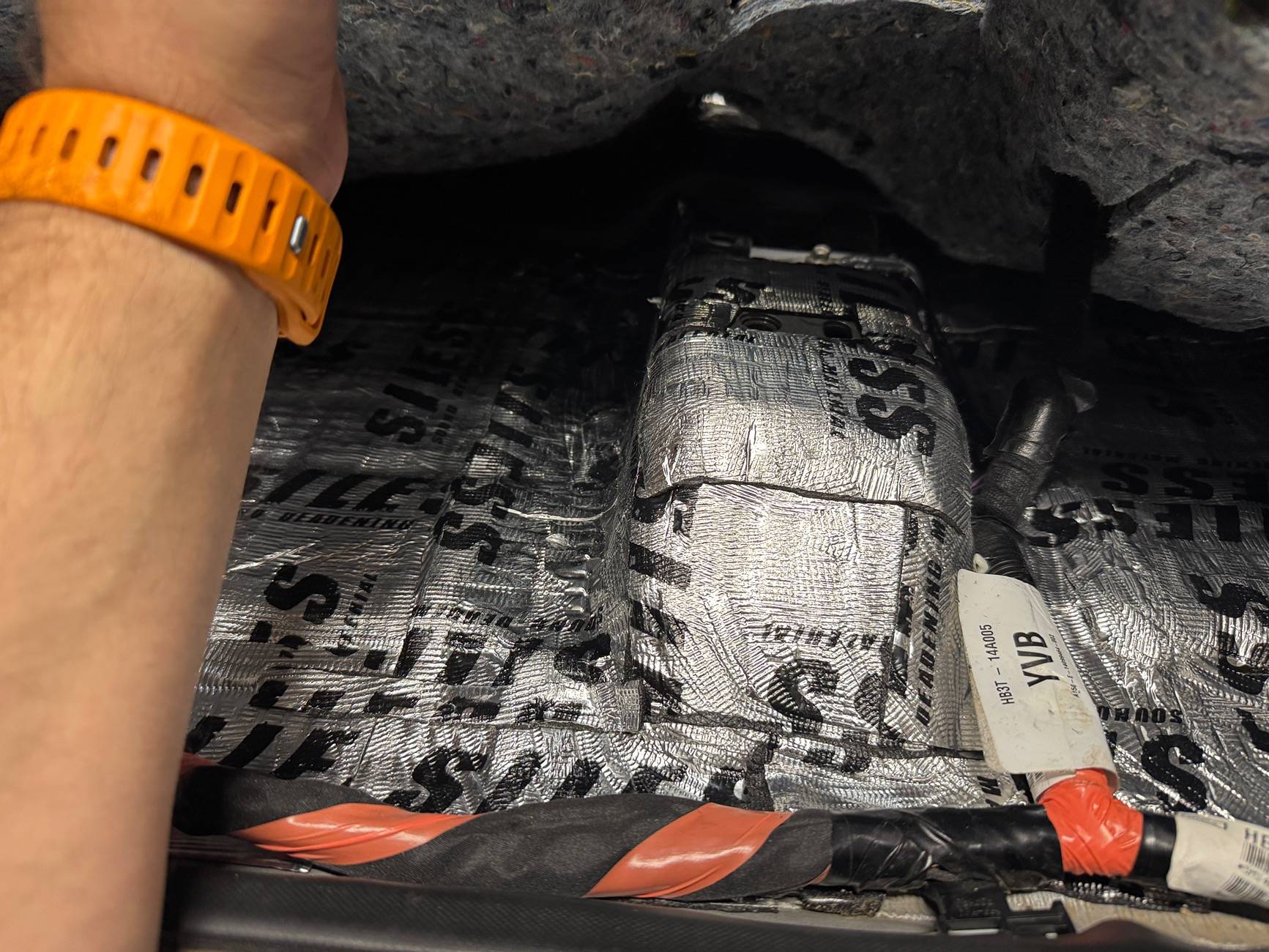

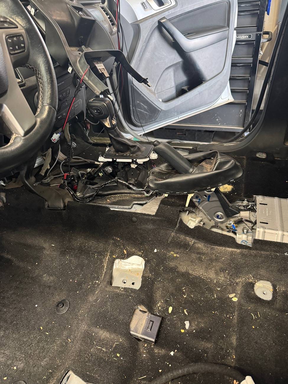

currently in the middle of full interior sound deadening.
I did my doors several years ago. Be curious how much more this helps. I know the roof could use some since it sounds like a tin can.

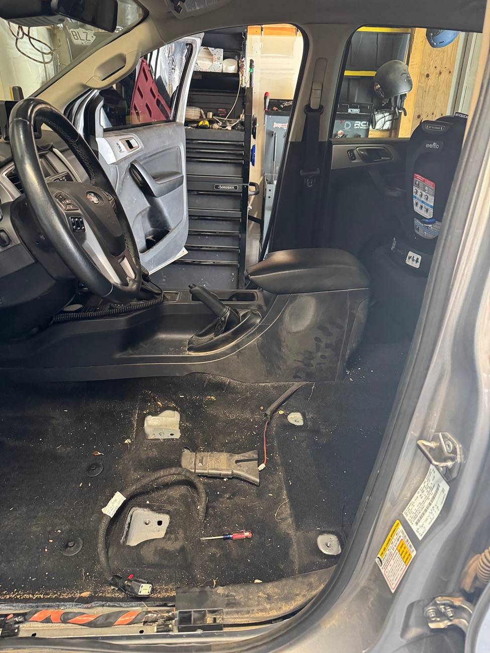

I did my doors prior to this, but I don’t think I did a good job. I’m going to redo them while I’ve got the truck apart (redo = add more).
I meant to take a picture before putting the carpet back down but I forgot. There’s a ton down. Took a package to do 3/4 of the truck. A new box of sound deadener just arrived so I’ll keep working when the kiddo goes to bed tonight. I thought this would take more time than it has, honestly. Started yesterday at 2 and ran out of material at 830.
