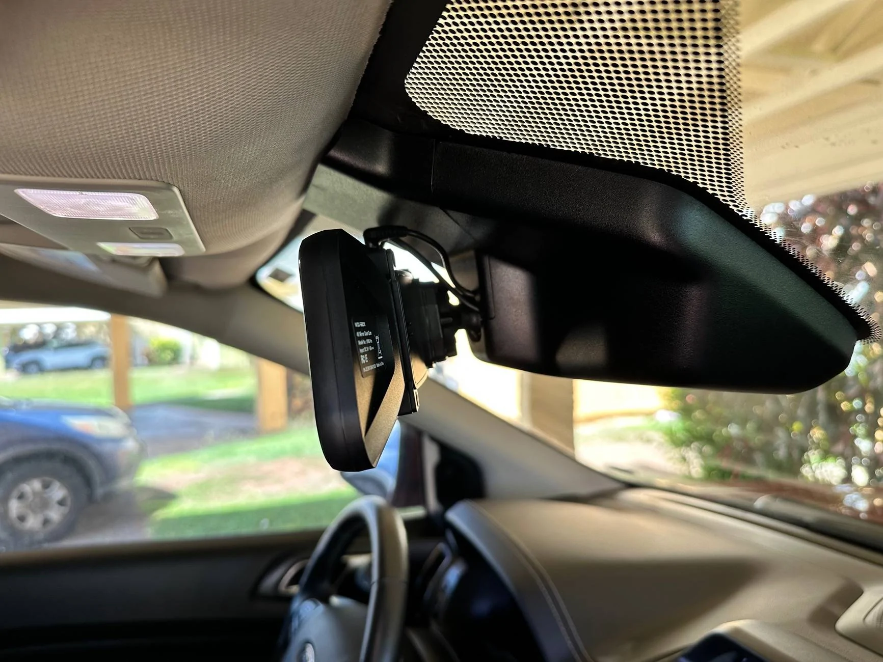

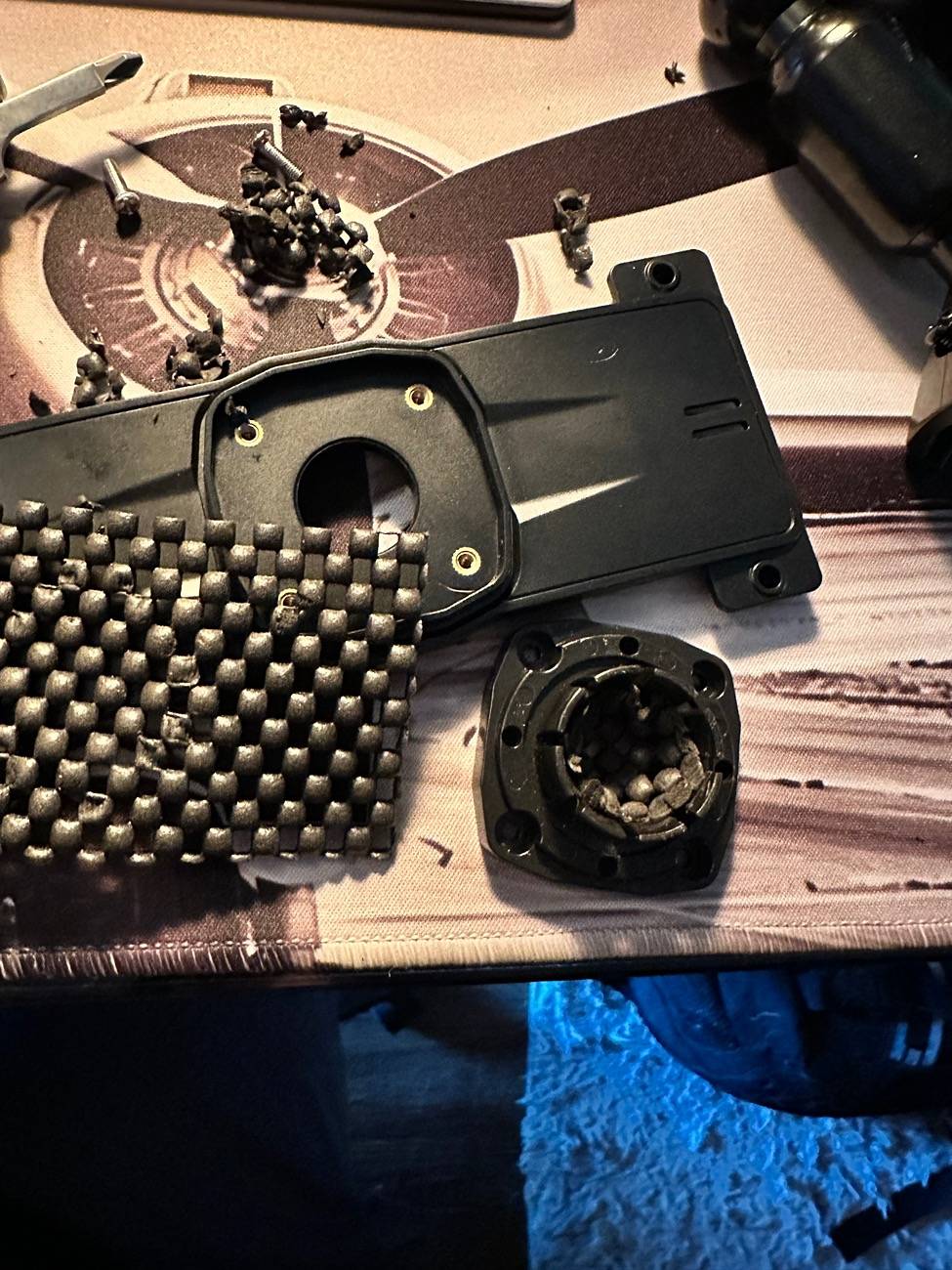

How did you attach it?
I bought a cheap ford mirror off eBay, I think for an escape, but it had the same mount. I broke it apart and built it into the Wolfbox mount. The ball it moves on is slightly smaller so I used a small circle of that grippy kitchen drawer liner stuff to keep it from moving. Fit perfectly and won’t move without a little force.

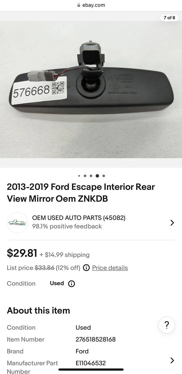

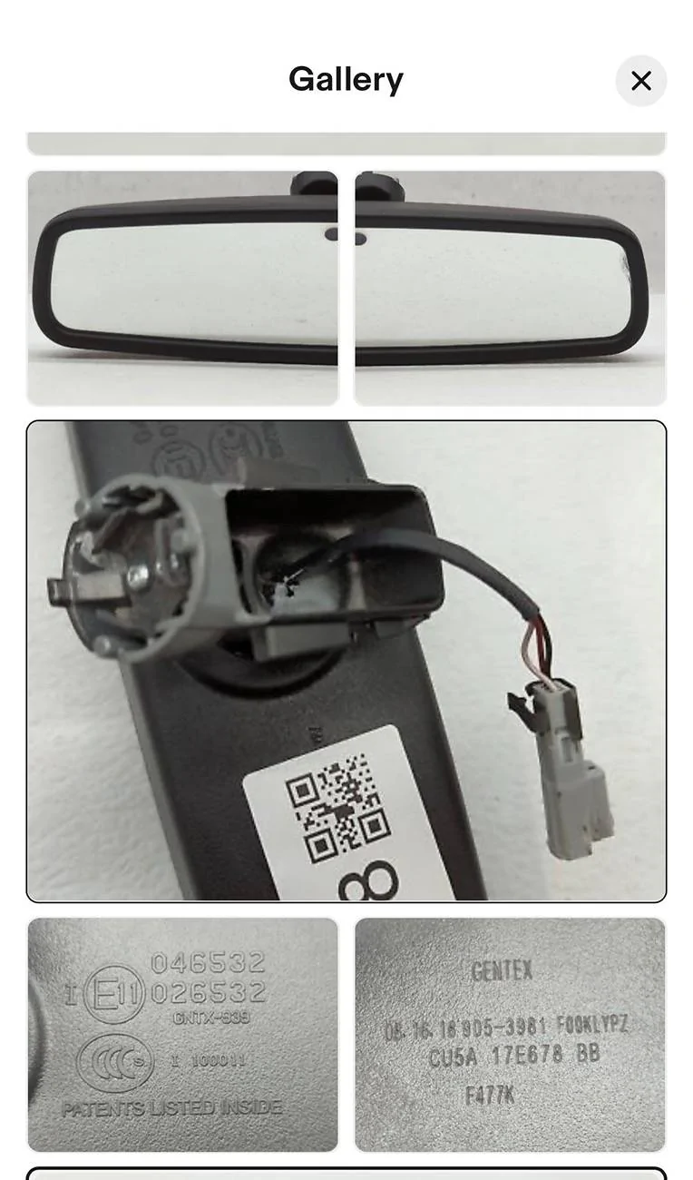

If you could link the eBay mirror you used, I would appreciate it. Having the Wolfbox attached to the front of the OE mirror was awful and caused me to return mine. I would love to install it, but want a clean look like yours.
Sure,
eBay - mirror
Also, pictures because I’m not sure how long they’ll leave an old link up.

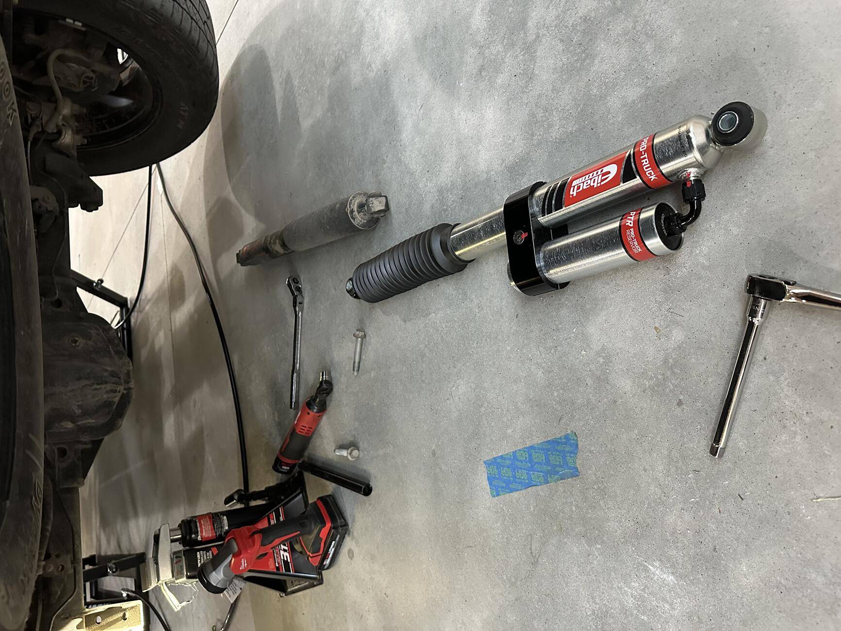

After putting on 15K on our ranger in 9 months, I got tired of the suspension. So Eibach Stage 2Rs are going on. Rears done tonight in a few min, Fronts will go on with a 1.5" lift or so next week when I get the tools I wanted to do the alignment.
Already riding around with just the rears on the ride quality is already really improved!
