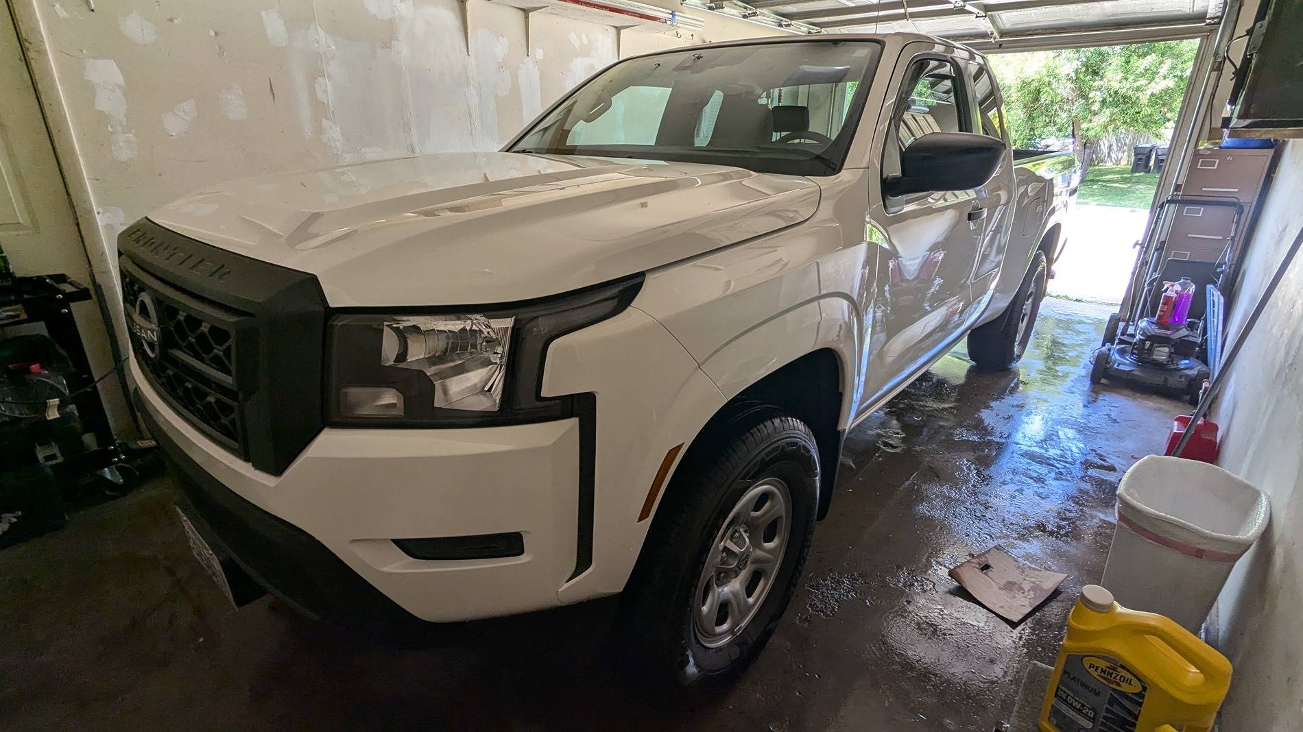

Washed it. Half outside, then rest inside my garage cause it kept raining and I'm also a psychopath...
Yes i will post my Nissan in this thread sometimes. Can't quite break away from here yet.
Ps I don't recommend you wash your vehicle in a drainless garage... Lol

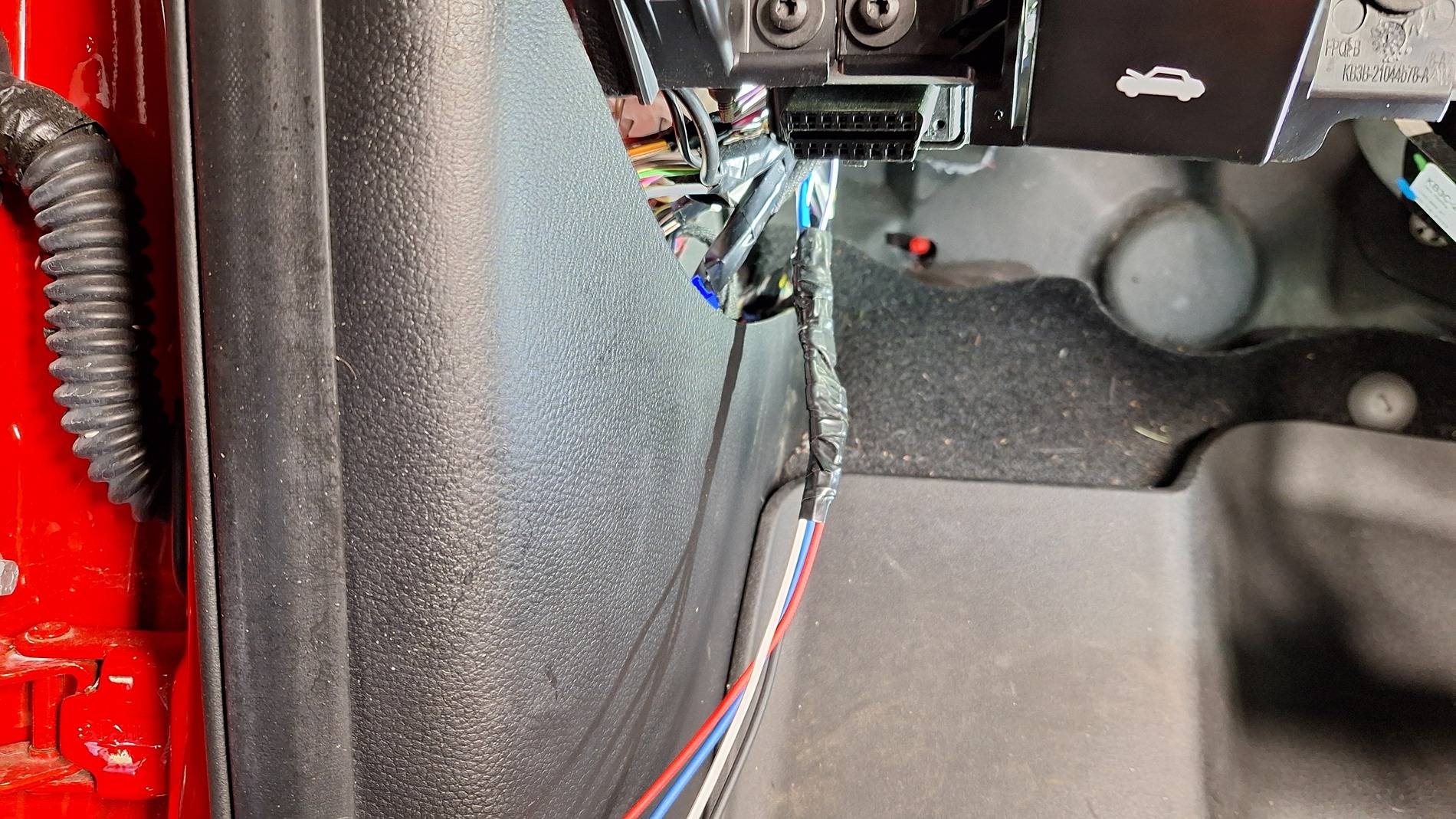

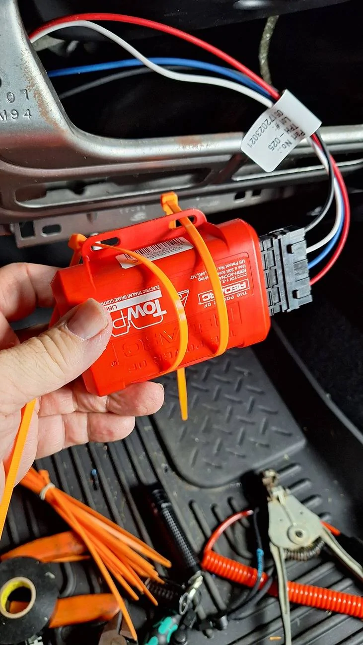

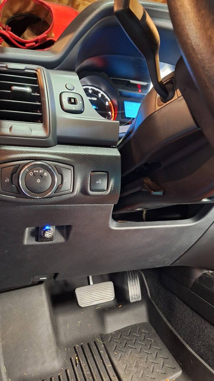

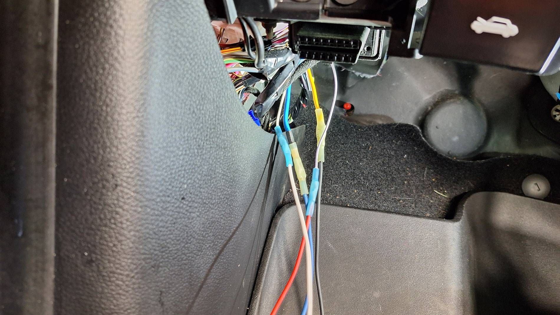

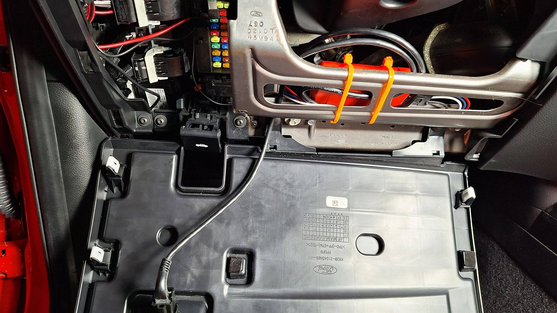

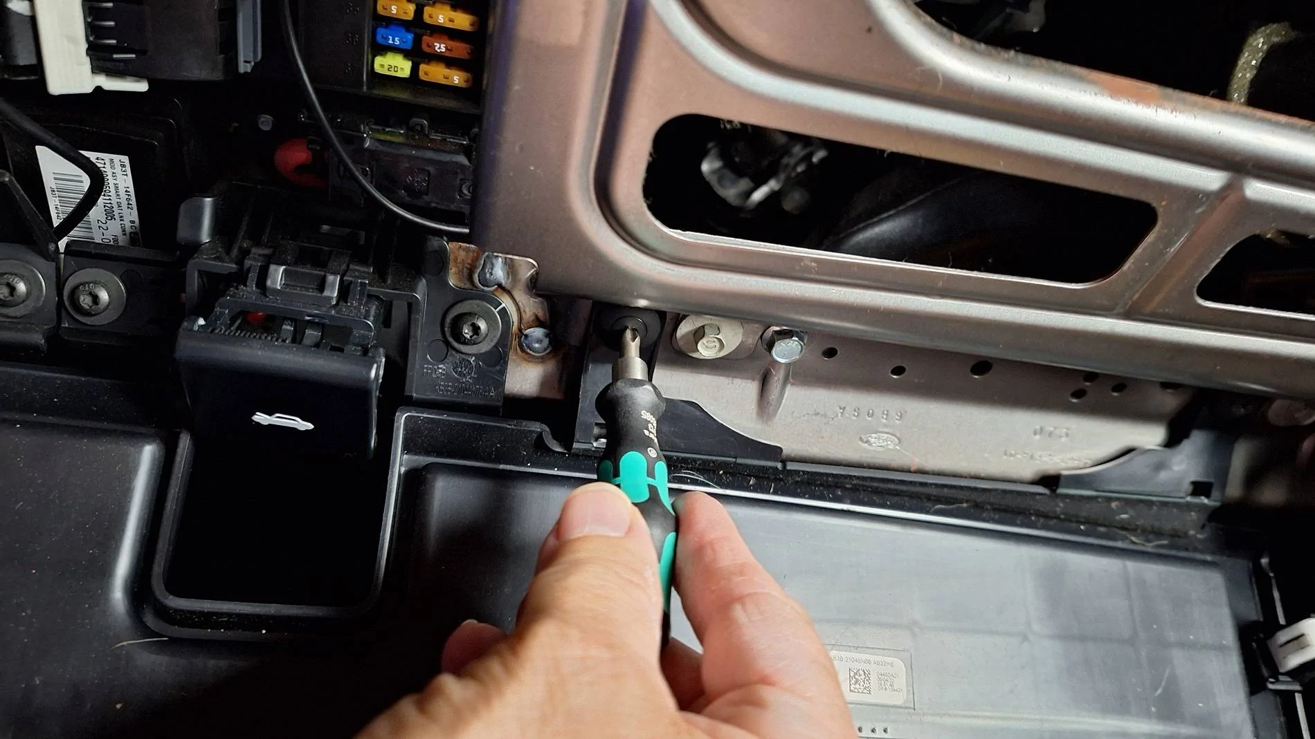

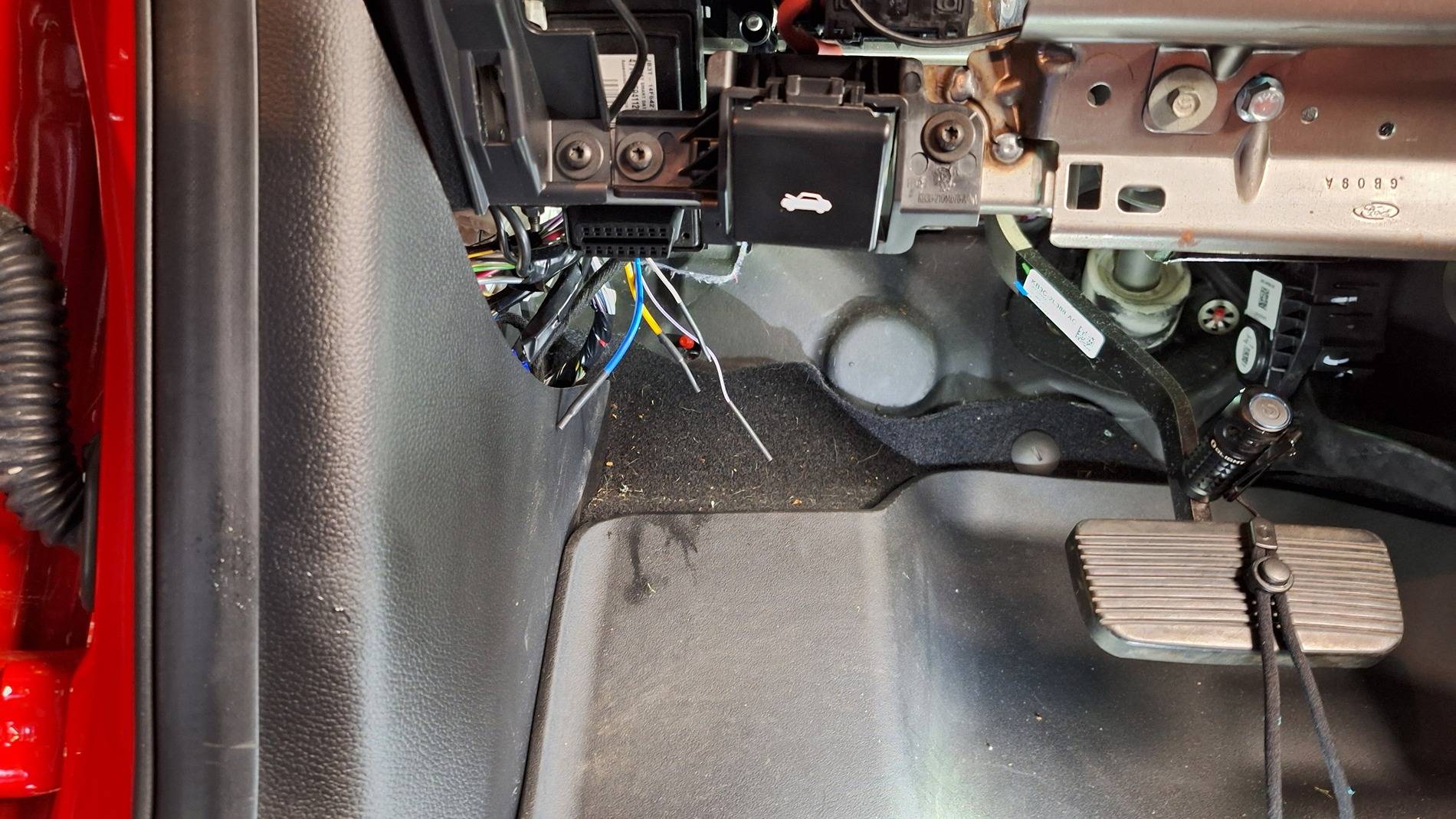

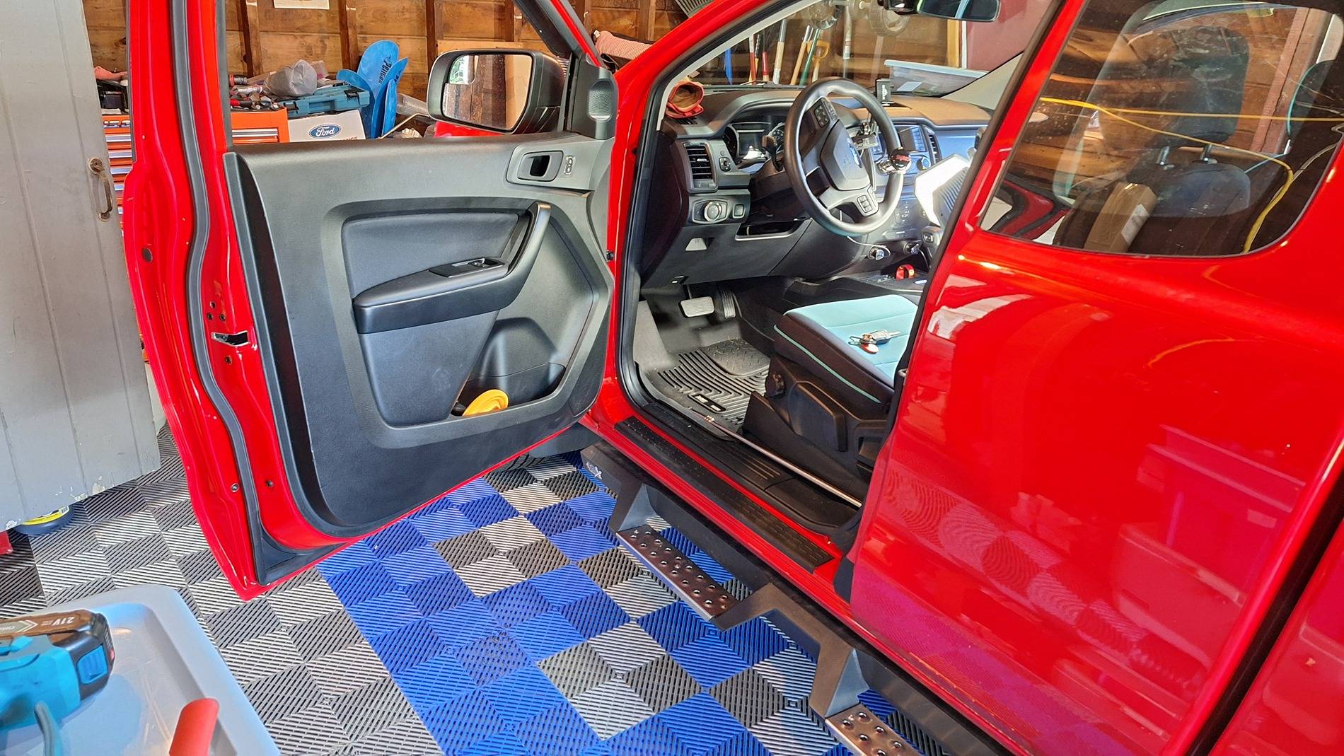

Finally, after much inner turmoil for where to place the button, I went with the standard Ford location. Main reason: me and plastic clipc don't play well together - they make me bananas. LOL, even with the easiest mounting location, I still had a cussing fest trying to get the stoopid panel back on - bah! =D
first though, I scored the garage as Kate was out - nice since the sun was beaming down cooking what brains I have left

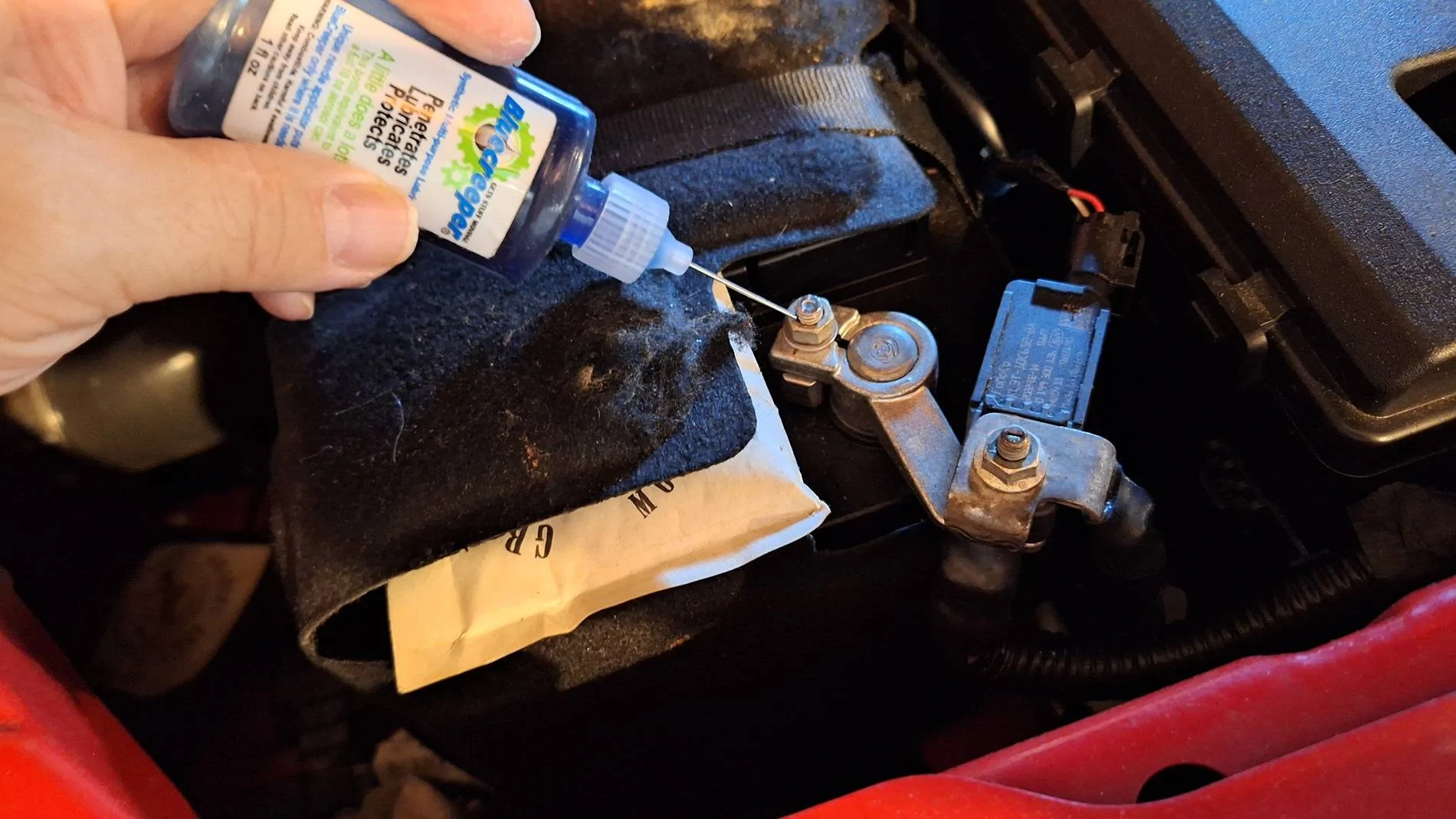

@Fordup hooked me on Blue Creeper and it's nearly an EDC item for me, I love the stuff

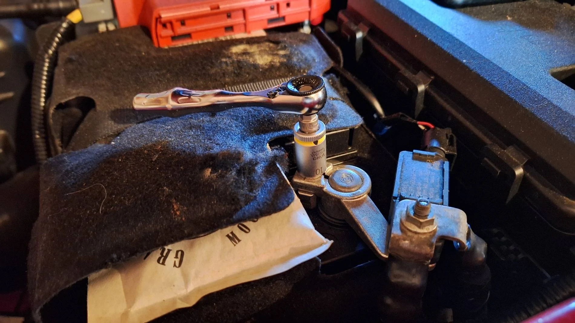

the mythical 10mm (note my rodent nibbled battery blanket - lil' bastards =p
took down the panel - that etrailer guy in the video lied, I struggled getting this thing back on =D
I'd pay $50 to have Ford make these 8" longer, but not too bad to get to them

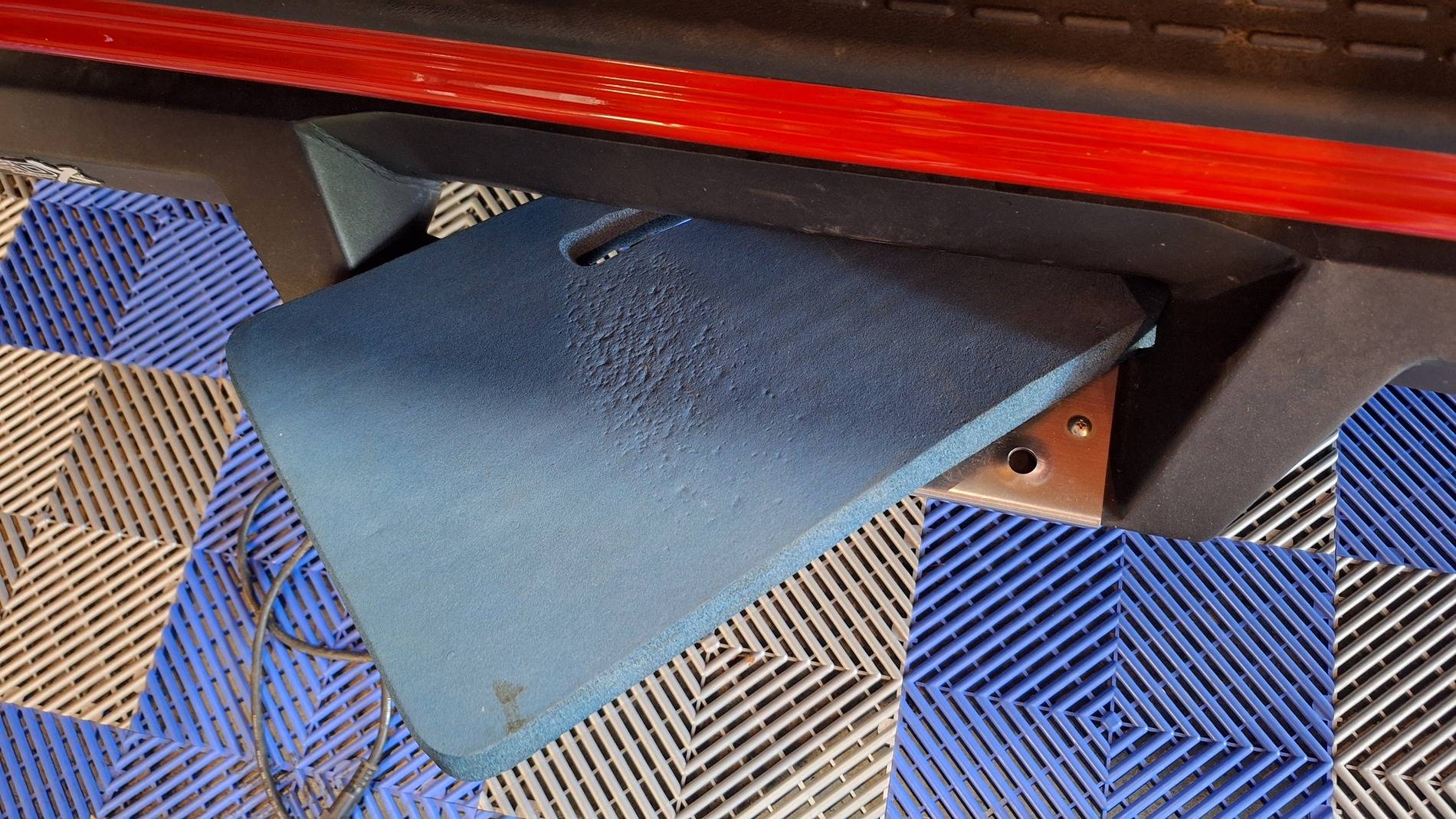

I couldn't have done any of this without an old garden kneeling pad on the side step
or without my trustee foreman making sure I didn't work myself up into a heart attack - stoopid plastic clips ... =p
used those Shrinky Dinks butt connectors =)
I almost used 3/4" shrink-wrap to bundle all 4 wires, but it has the glue in it and that would be miserable if I ever took this apart, so just electrical tape
I don't off-road, so I figured tie-wraps would be good enough

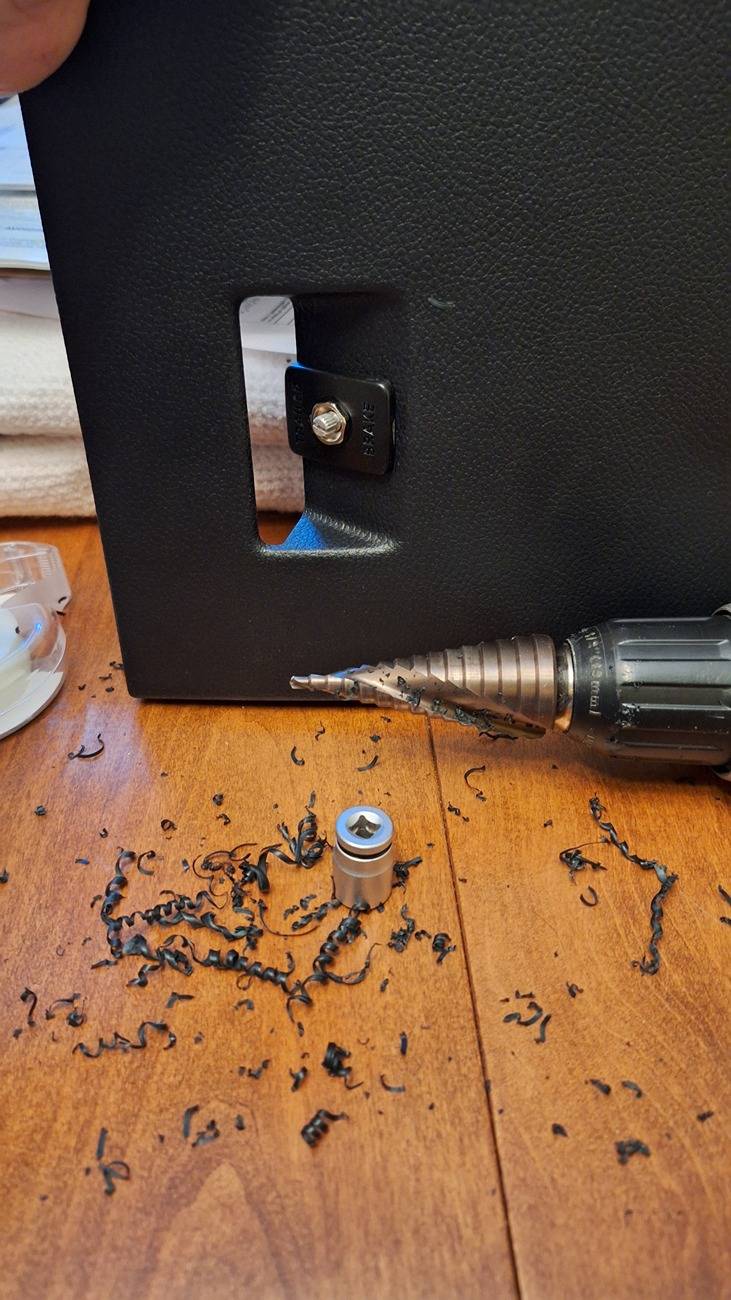

after all my heehawing about knob placement, I wussed out and went the easy route - 12mm to hand tighten the knob body thing
even tucked the wires under the controller making sure no sharp metal edges were rubbing
reconnected the battery and didn't smell anything burning, good enough! =D
Step bit worked like a champ, placement won't get hit my my knees (short guy = short legs), I don't have to worry about Cheech mashing it since he often steps all over the place when he's not harnessed in, and I keep my 12V for my phone. The XL only has one USB, so both 12V are used for Kate's phone and mine.
Anyway, I figure if I ever get into a trailer sway situation I'll be bashing everything in a blurred moment of doom! And I can see the light just fine with the plate mounted a tad higher up to maybe look more OEM (at least in my mind and remember, short guy doesn't sit as high up). =D
All in all, not as bad as I thought. It would be easier to pop the seat out but since I couldn't figure out the airbag sensor clip when I put on the Wet Okole seat covers, I decided to pass. If you have the Merlin-like ability to conquer a plastic clip, the seats are super easy to unbolt (I did for those Seat Jackers).

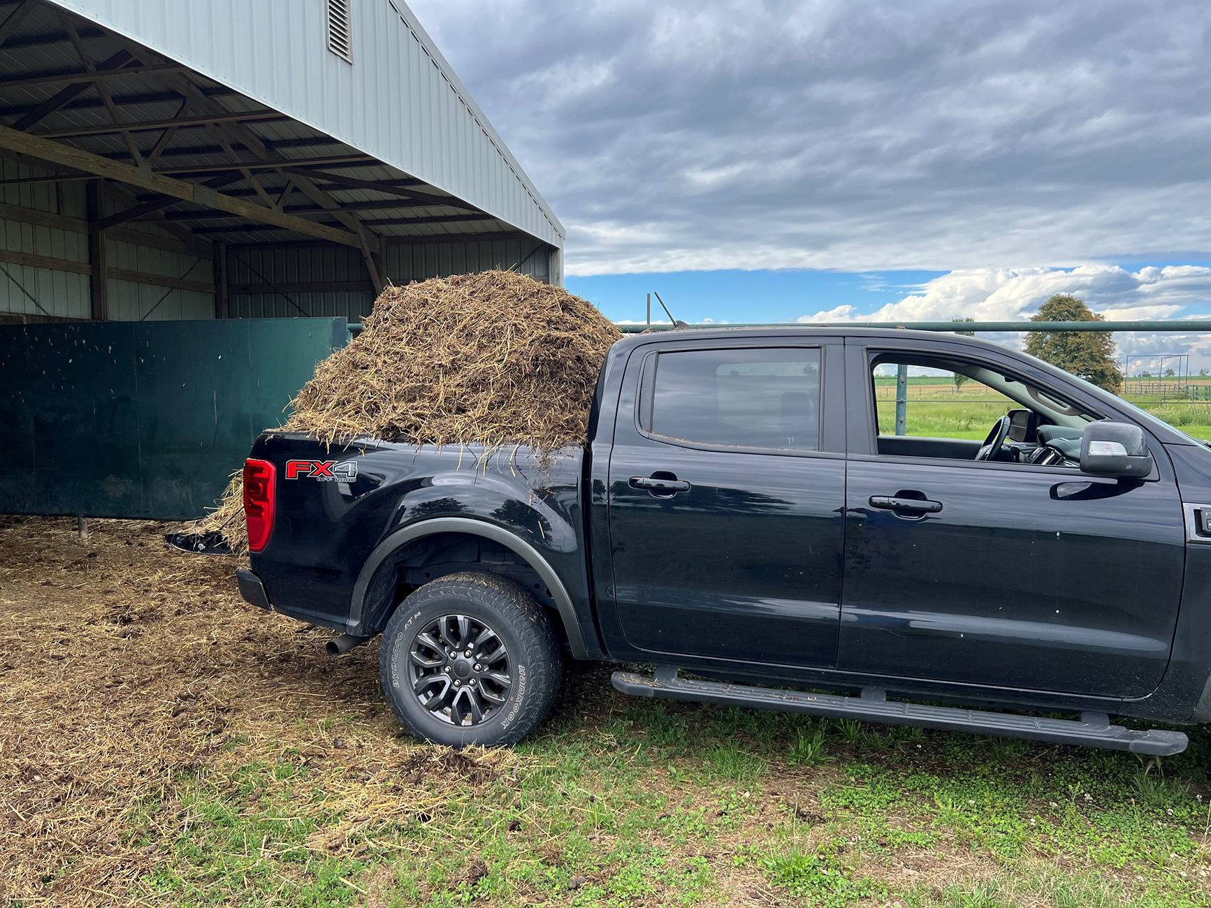

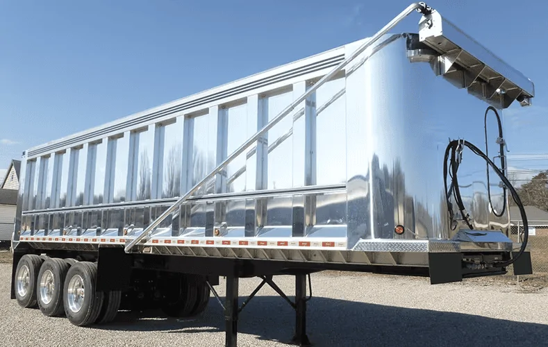

Now I just need me a big dump trailer!
too big? not for a FFR! gee, better flip my drop hitch over to raise it up ... =D

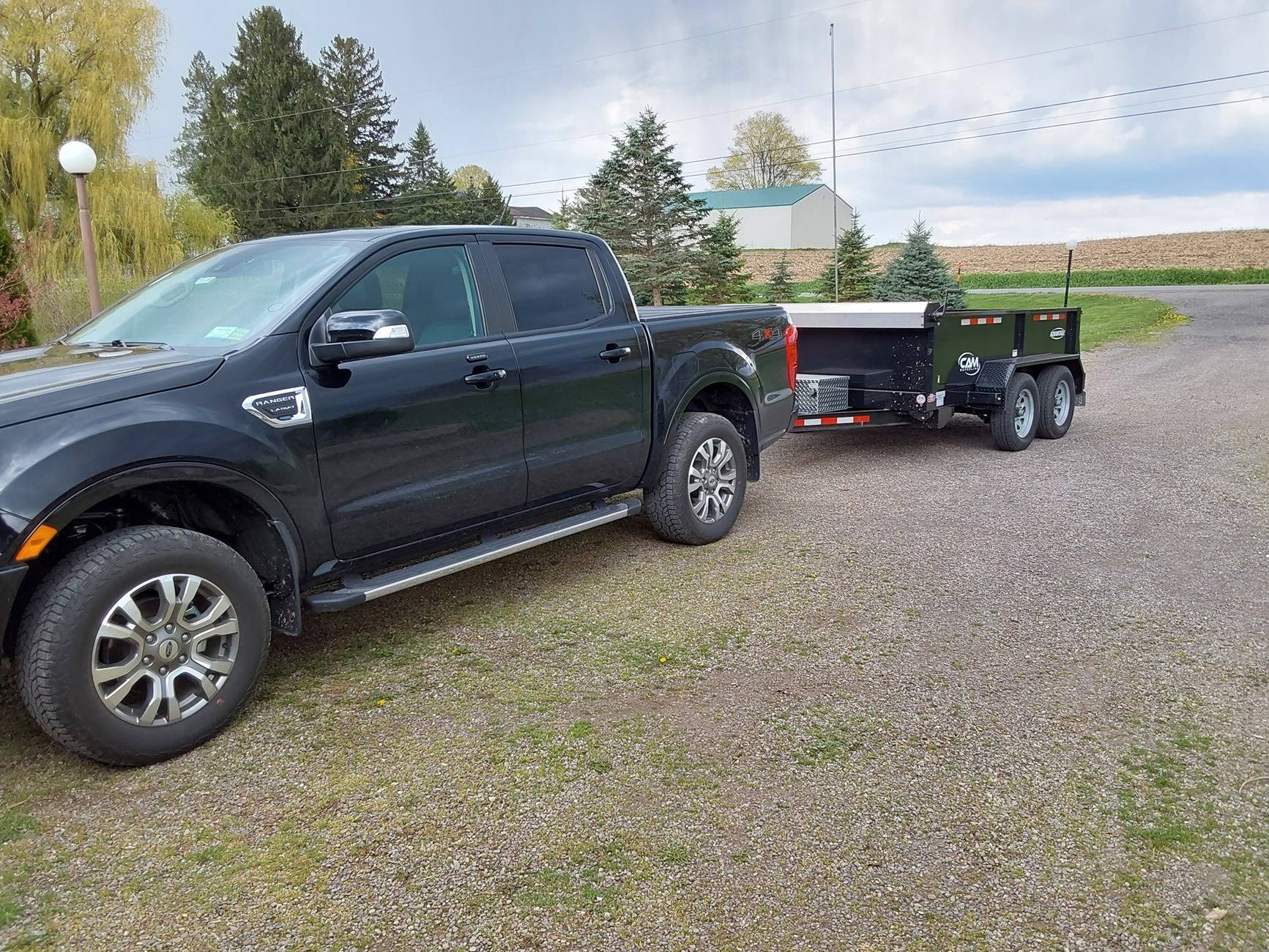

A 6 x 10 is perfect. But beware of the loader operator.

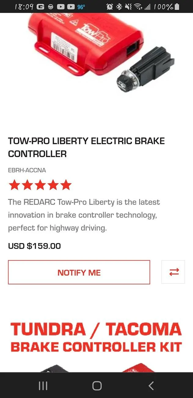

Your the reason they are all sold out!!!

I guess I lucked out, I got this for Christmas. =)
Hope you find one soon.

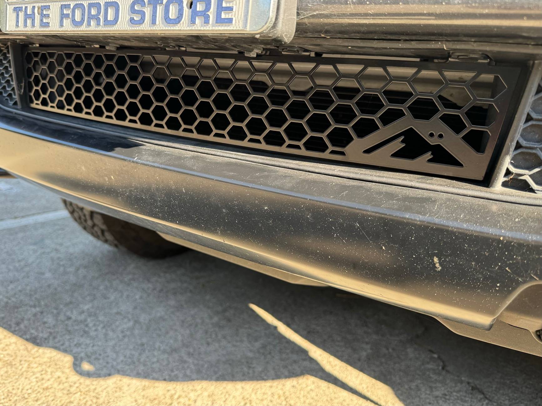

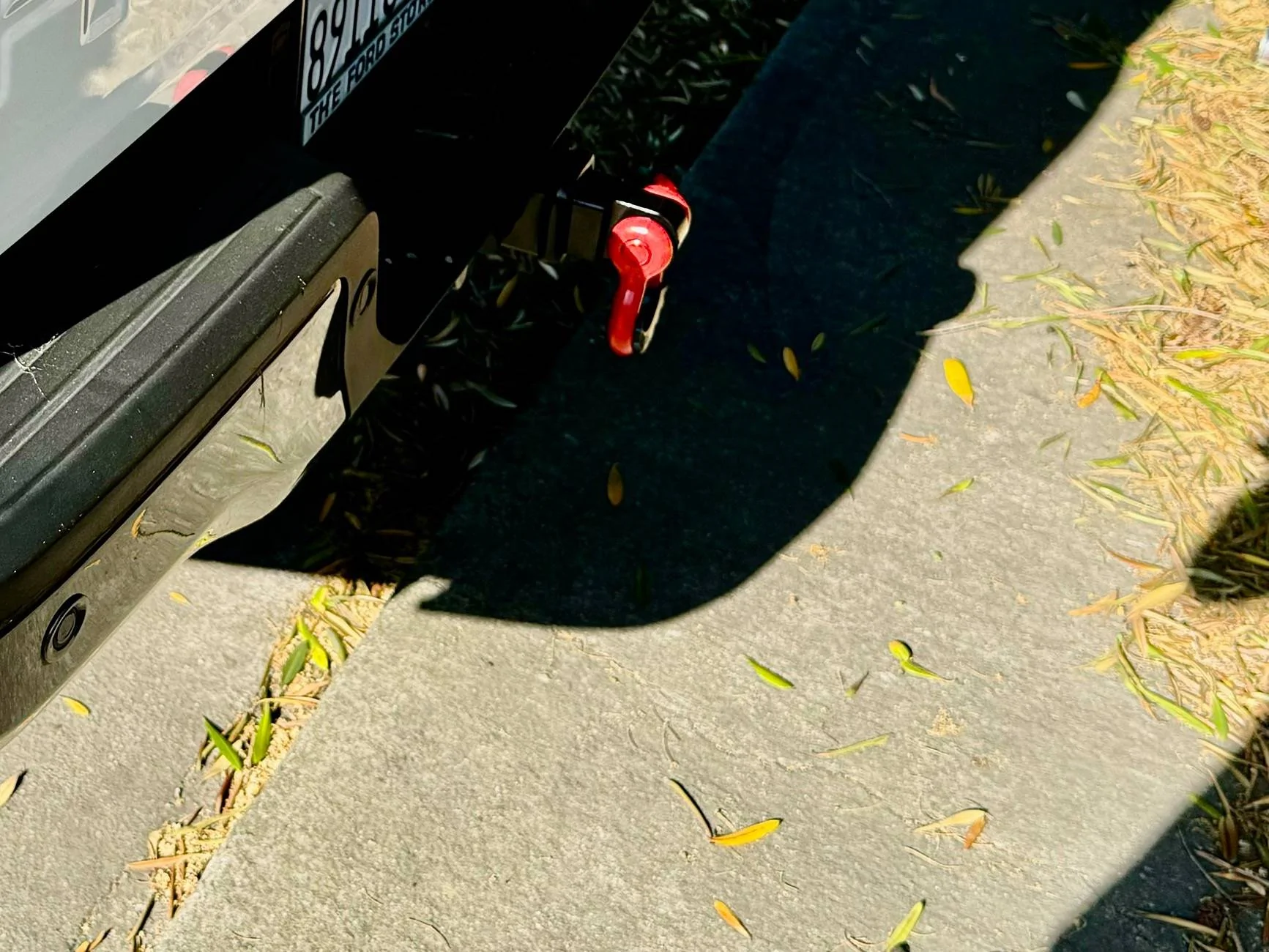

anyway I got a couple things in the mail today. Got to toss them on before going to our fav Mexican restaurant “The Mexican” with the family.

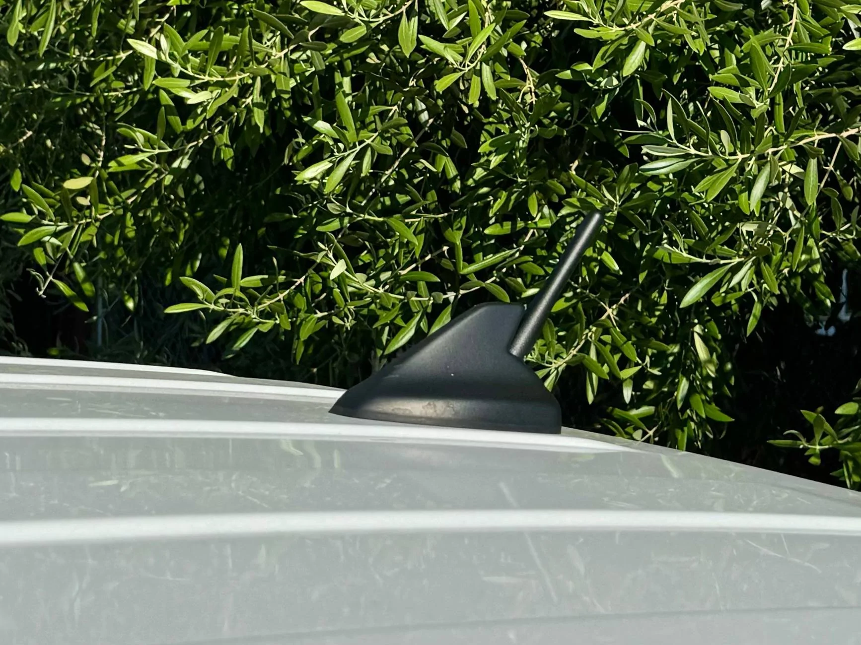

The stubby 4”
Rhino recovery shackle
M2M lower honeycomb (this one I wasn’t expecting to like as much as I do.)(it’s pretty nice for just $50)
I’m not good at taking pictures btw.
