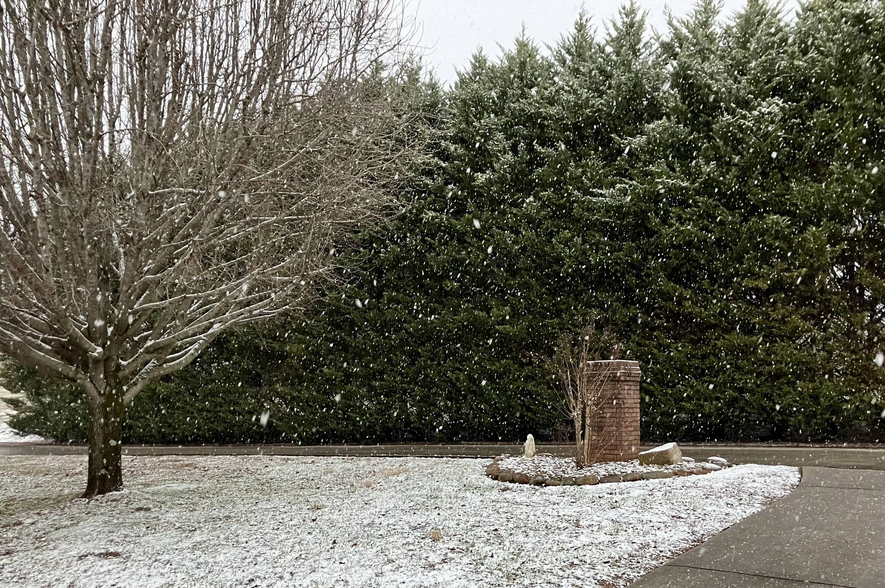

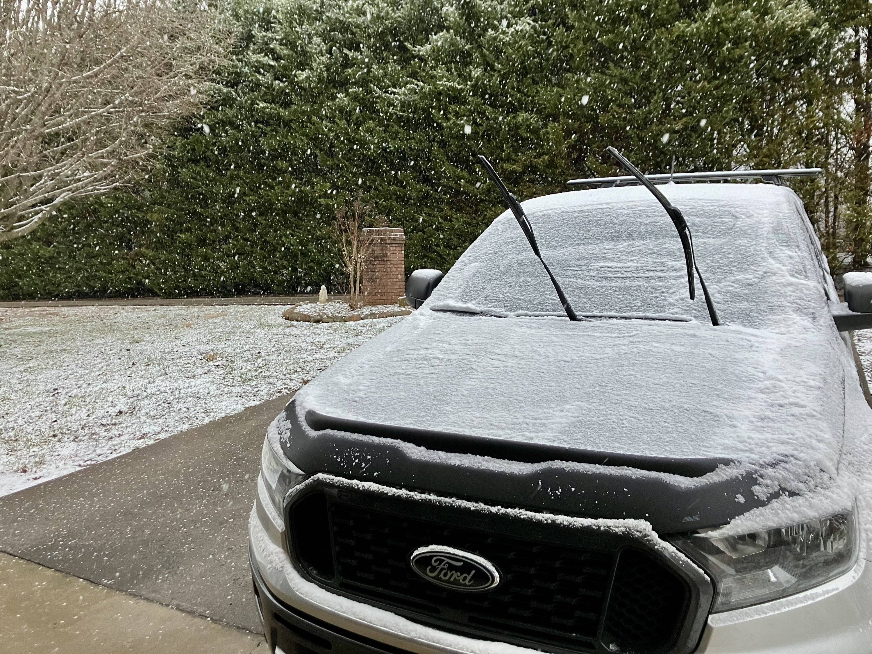

Nothing will be done to or with the Ranger for st least 2 days.
it has begun with 4-8 inches expected. This place will be shut down for days ?
East TN is not where you want to drive in these conditions…last time I saw people in ditches everywhere and numerous wrecks. My defensive driving will be staying off the roads! ?
