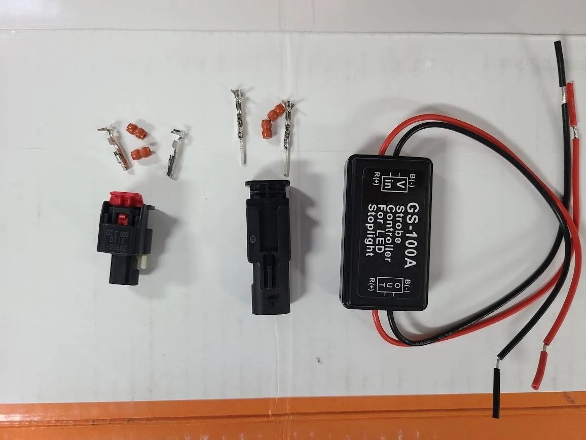

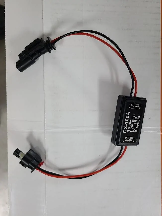

Looks like the pins/sockets are not seated all the way in the connector. You should not be able to see the metal that is exposed in your picture. That is a short waiting to happen. Could be why the connector is not making good contact. I have heard they are a pain to get seated properly.
I used a pair of pliers to push it in and that’s all it went every time in every direction

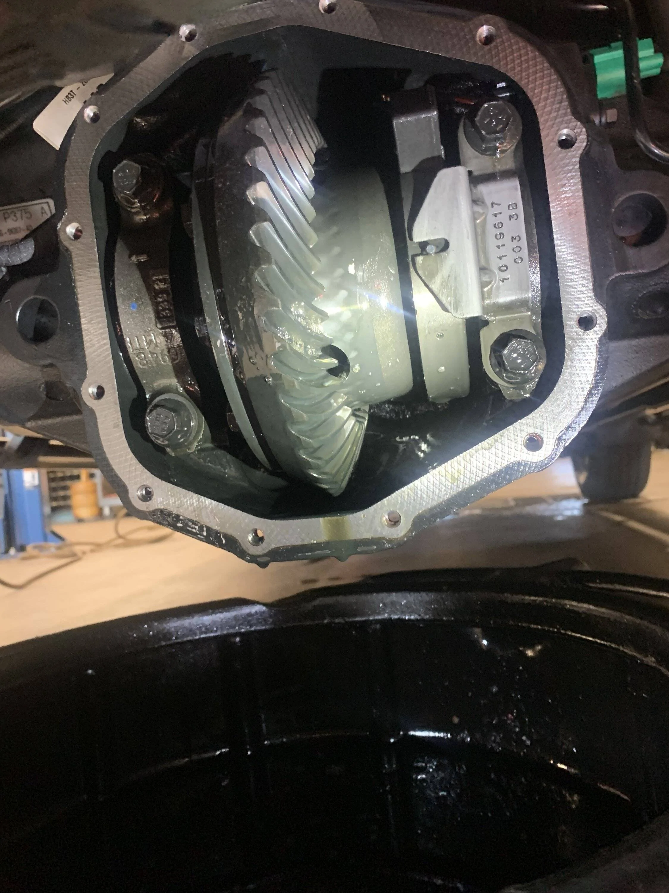

Posted this yesterday, but not sure why my text didn’t show up with the pics. Got a bath and changed the gear oil in the rear end. Yes only 3,400 miles, but it had a good amount of break-in metal floating around. So for $15 and a few minutes, why not lol?
Any chance that you soldered the wires to the pins?
I made a new harness for my Jeep a few days ago and figured I'd solder everything. Darn solder crawled into places it should have & I could not get the pins to go all the way in to the connector. I tried filing the solder off, the pins went in but wouldn't lock. Luckily I had ordered extra pins so I just cut them off and crimped the wires on the new ones. All was good after that.
I made a new harness for my Jeep a few days ago and figured I'd solder everything. Darn solder crawled crawled into places it should have & I could not get the pins to go all the way in to the connector. I tried filing the solder off, the pins went in but wouldn't lock. Luckily I had ordered extra pins so I just cut them off and crimped the wires on the new ones. All was good after that.
On the back of the molex pins there's a little tab. This is what locks the pin into the connector. When you soldered the pin, you probably filled the tab with solder. It will never lock if this happens, as you found out. You can solder it, just have to be careful.
Installed electronics for about 30 years. AND YES, I'VE DONE THE SAME THING BEFORE :crazy:
Yup, that's exactly what happened! But it all turned out good in the end. I didn't have to cut any factory wiring and the new piece I installed is truly plug & play.
