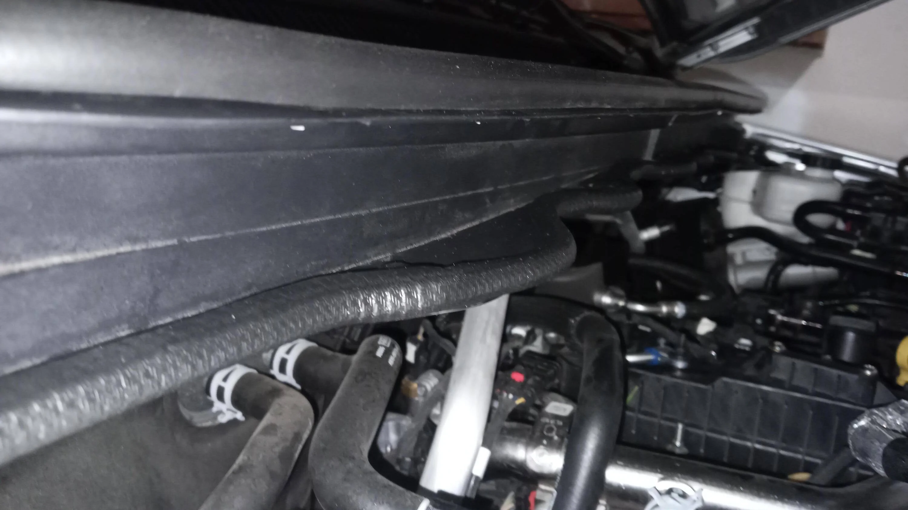

Alright, as mentioned before cowl leak, got seal ect.
I tried 3M tape, but wasn't thick enough so I opted to use RTV... Messy mistake but hey whatever.
Seal came in, got that thing in... let's see if I still have leaks.
Now just gotta figure out what to do about the gap between the two cowl panels... Plastics suck sometimes.
And yes would have been a good time to add a mesh screen to the blower motor openings in the cowl.... Didn't have any.

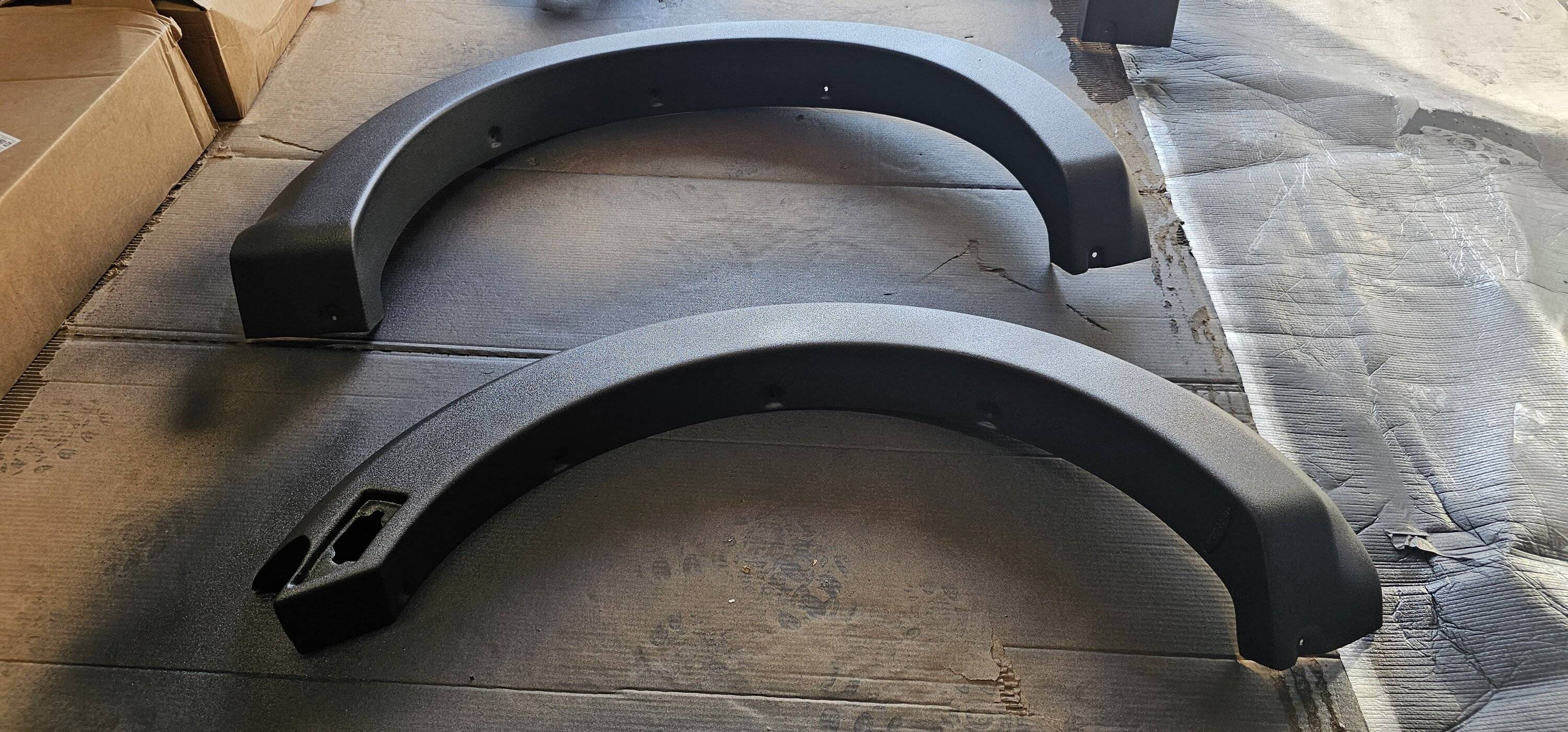

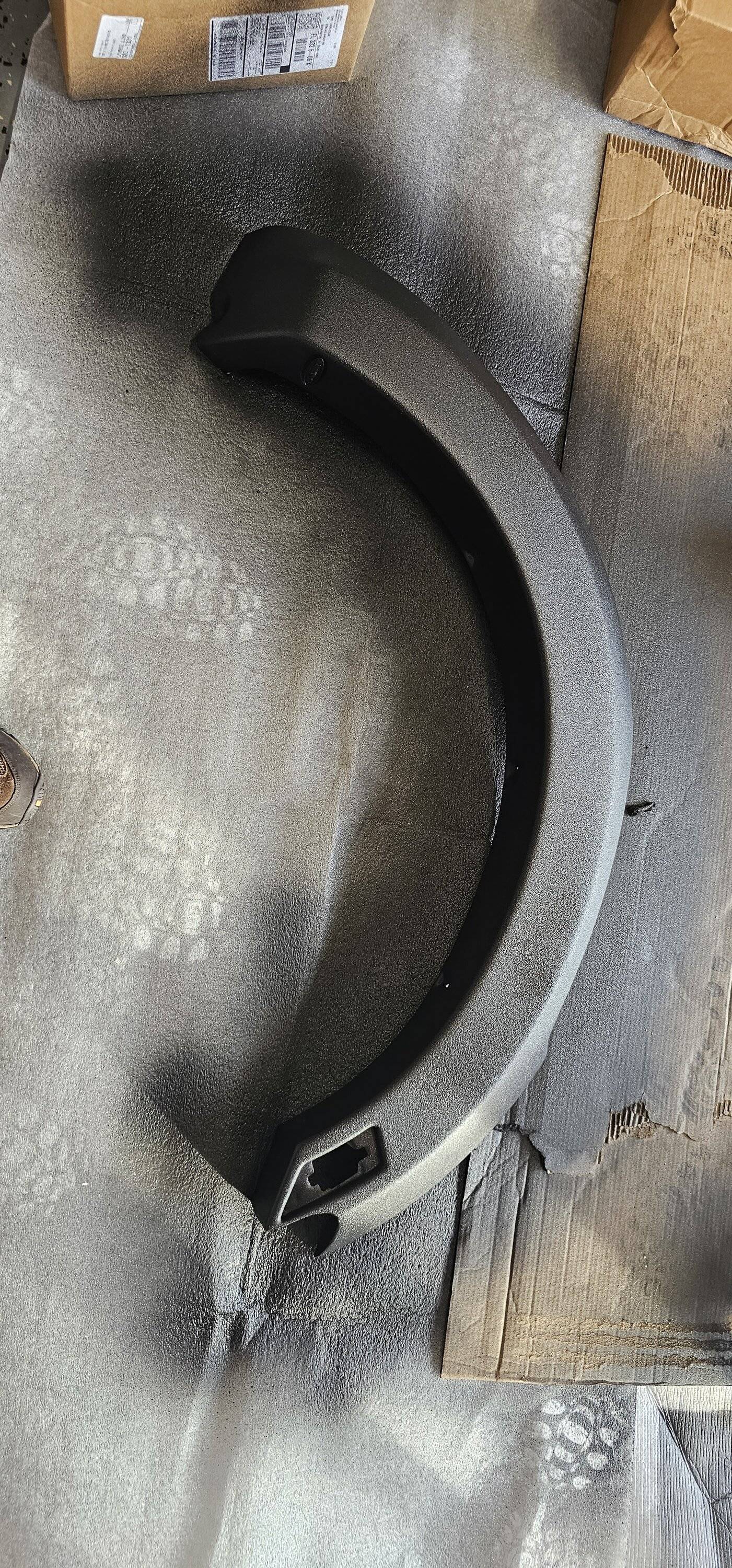

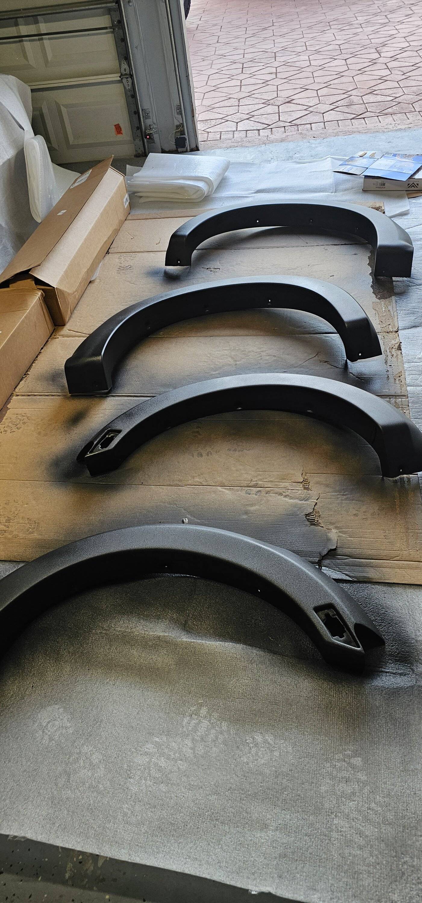

It's not perfect but I'm still happy with it (and that's unusual!). Starting two days ago, I sanded down and washed the fender flares that @OFC Ranger gifted to me (that I've been modifying to fit around my snorkel and front bumper). Last night I wiped them down with acetone, tacked them off, and then hit them with some adhesion promoter.
This morning I had to get up at 0500 to take my wife to the airport (?) so when I got home at 0640, I tacked them off again and got 'em with two coats of Raptor Liner.
Again, it's not perfect. My "body work" on where I bonded the plastic together leaves a little to be desired. I'm actually a little surprised that the Raptor liner actually accentuates my shoddy work rather than covering it. But I'm still happy with it.
Look good to me!

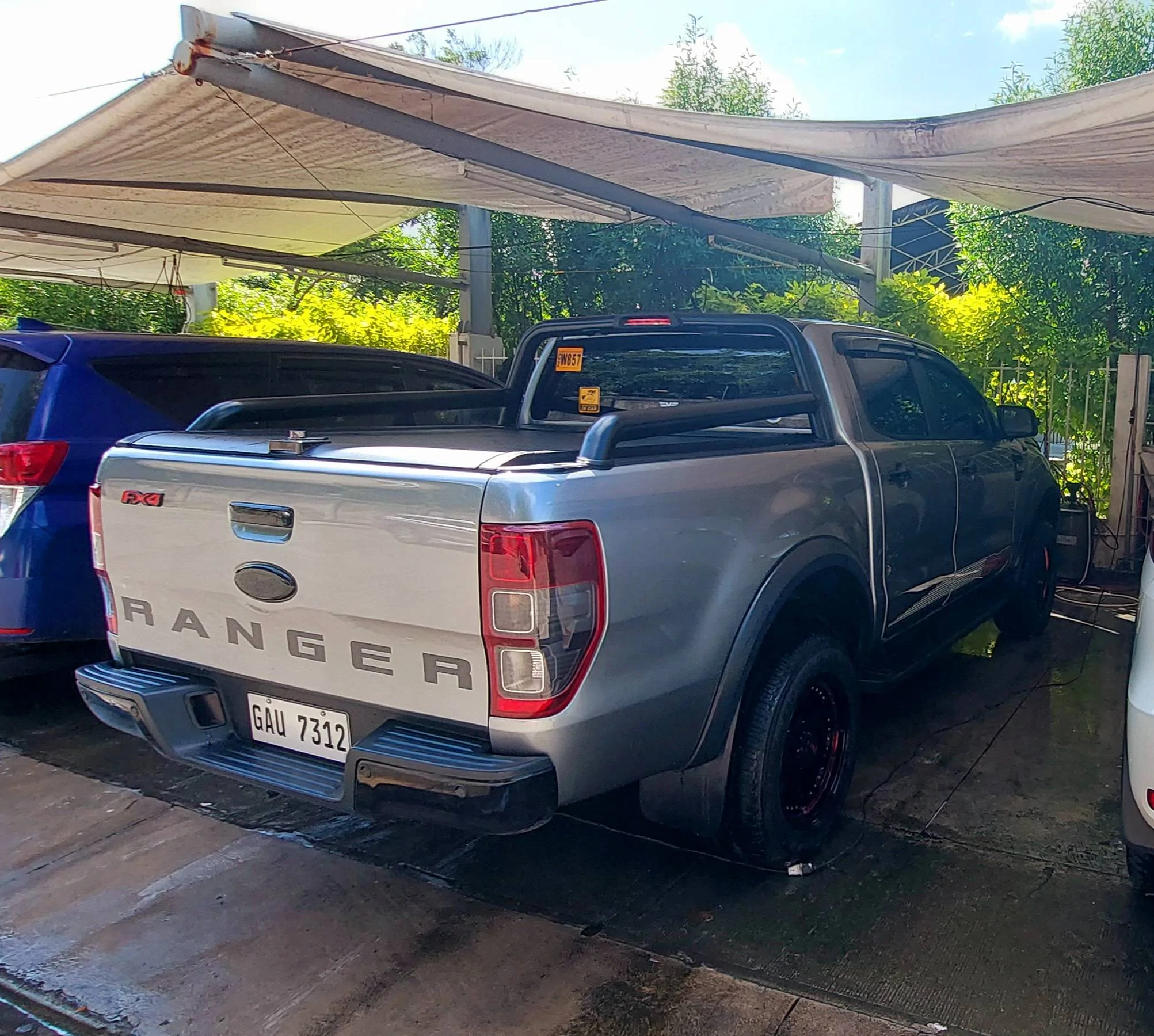

I still tired. So I let someone else clean my truck. It cost $4.?
Was that more or less than the massage while you waited?

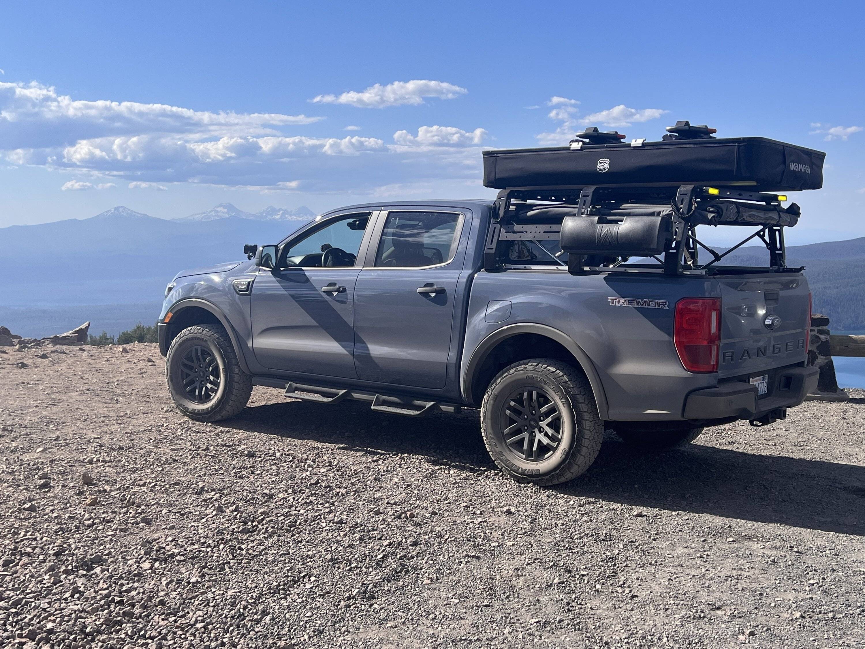

Yesterday I drove up to Paulette Peak in La Pine, OR. Saw another Ranger at the top.
