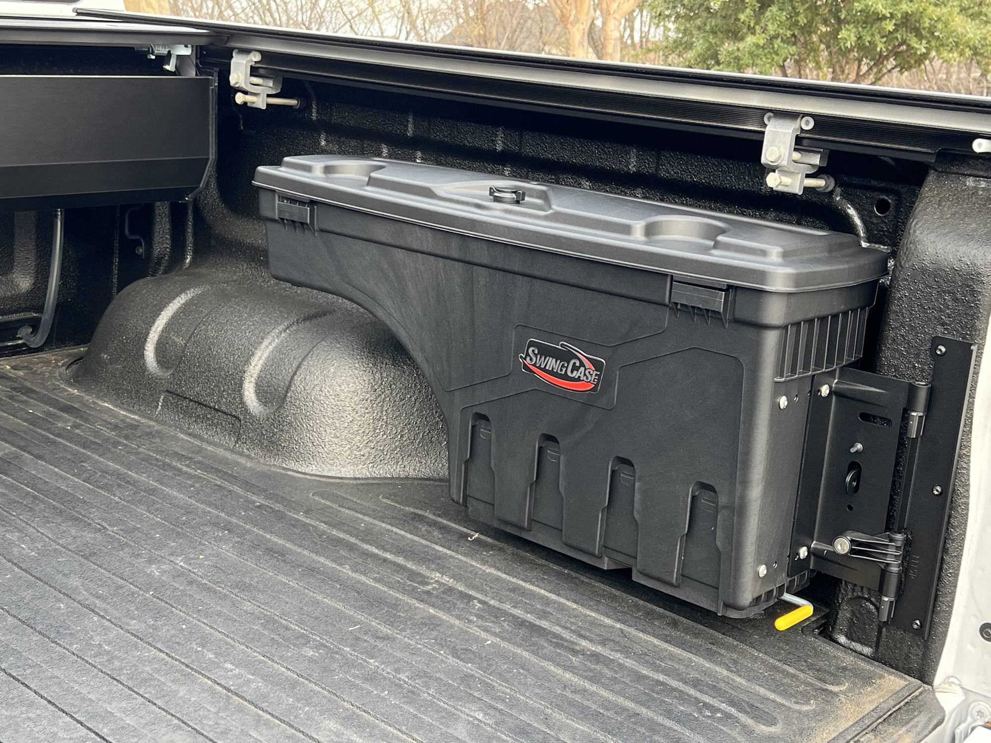

Installed a new SwingCase from @Stage3Motorsports which required me to make a trip to Lowe's to buy yet another tap to clean the holes that were filled with spray in bed liner.

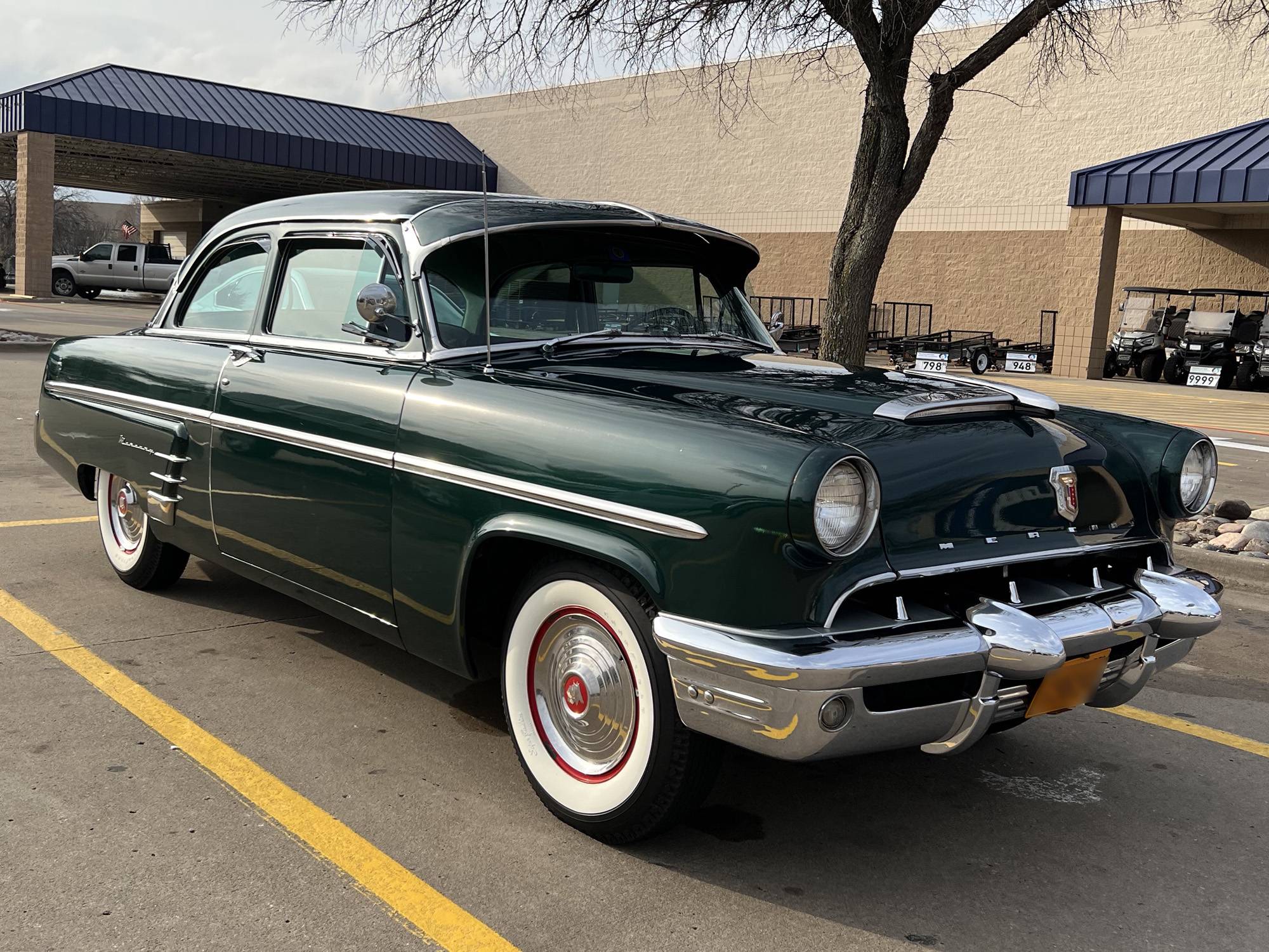

Saw a guy pull up in this beautiful '53 Merc. I complimented the guy on how nice his car was when asking him what year it was. He said, "It's a 53," and stormed off without even saying "Thank you." So I guess owners of '53 Mercs are either a$$holes or just hate talking about cars. Whatever. :wink:

Maybe he was just "An Old Grumpy SOB" like some around here !!!
Oh, wait, I resemble that !!!

Maybe a dumb question from new Ranger owner...is the Ranger pre-drilled for the swing out? There are predrilled spots in the rear bed of my pickup on both sides that look similar to where swingouts would mount. I bought it used so someone may have had something mounted previously.

Not a dumb question at all.
Yes, the SwingCase uses predrilled holes in your Ranger. There are a total of 7 holes. There are 3 holes in a vertical line at the end of the bed that you can see on the right side of my photo for the hinge mount. Those are 6mm x 1.0, and they were the ones I needed to clean out due to the spray in bed liner.
The bracket also uses the two pairs of tie down holes, the rear tie down and the middle tie down. You do not lose the tie down since you just install the bracket behind them, but you might have to remove the box to effectively use them.

Yes. Bed is predrilled and tapped to accept swing box hardware.
If you have spray in bed liner you have to work at cleaning out the threads.

Thanks. I need some storage for basics like a small tool kit, small shovel, and jumper cables, etc. May have to look into this a Stage3 box.

I think you will really like the SwingCase. They make them for either side, and you can get them from Ford with the Ford logo for $10 more if that is to your liking.
I chose the passenger's side since I have a WolfHaus 12V connection on the driver's side to which I wanted to maintain easy access. You could also do both if you need more storage.
I am keeping a small set of tools, mechanic's gloves, a headlamp and ratchet straps in mine for now, but I am certain to add more to it until it is full.
My only complaint is that I wish that the semicircles on the lid were full circles to better hold cold snacks.
