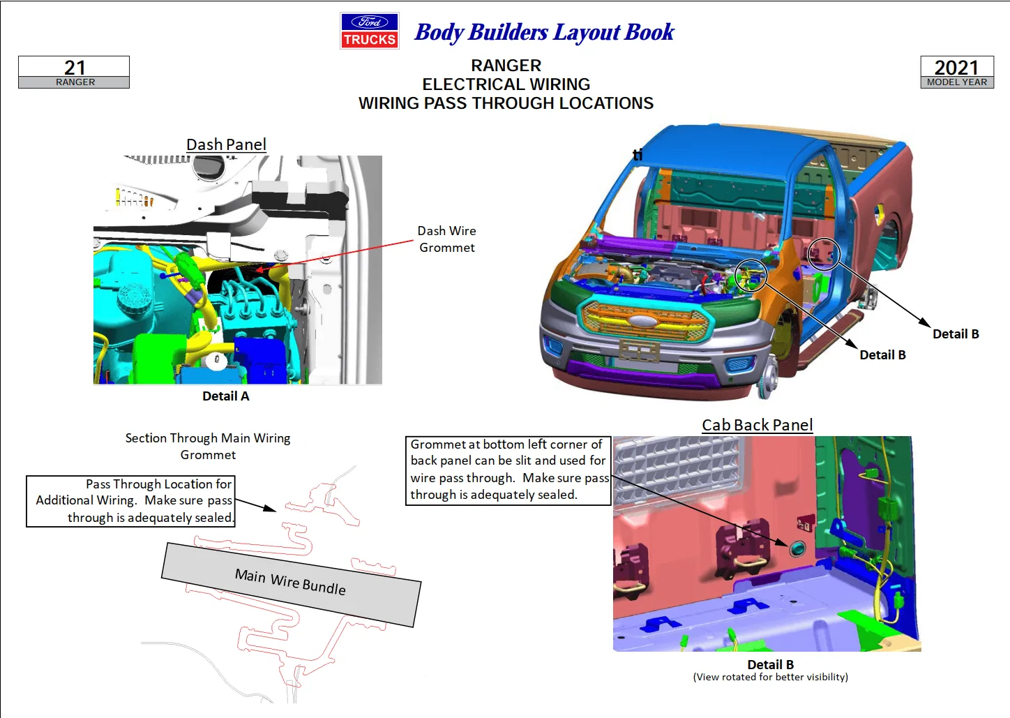

Installing Pods, and the AuxBeam switch today anyone have any tips on getting the wire through the firewall.
7,142
24,335
fish tape. upper fire wall on the driver side (usa model) is a small access hole. sort of look behind the brake stuff and under the wiper and you will see it. it has a plastic plug in place you can pop out or simply punch through. the inside cab position is up under dash behind brake and near the bundles of factory wire. its a pain in the ass to reach without a fish tape or coat hanger or something to get the wires through. once through its a great spot as it brings the wires in near the fuse panel in the cab, is close to the dash for a switch and under hood spot is near other factory wires in line to the battery.
tried to show a pic that makes it easier to find. if your trucks a bright color it will look like a black spot. if your trucks black good luck lol.
There is a grommet under the carpet on the passenger's front floorboard. Much easier than the firewall, but you have to run the cable down and secure it under the firewall.
