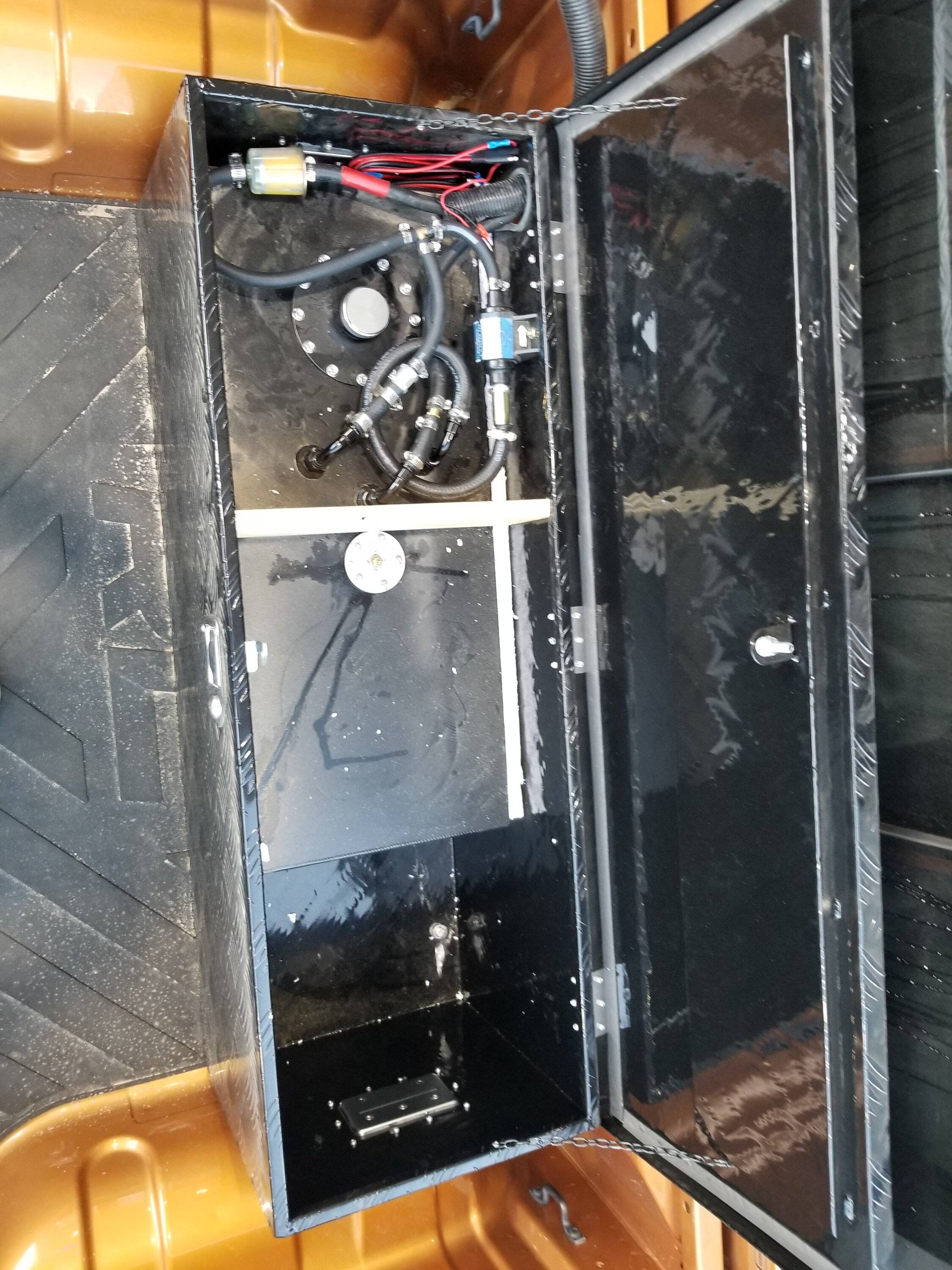

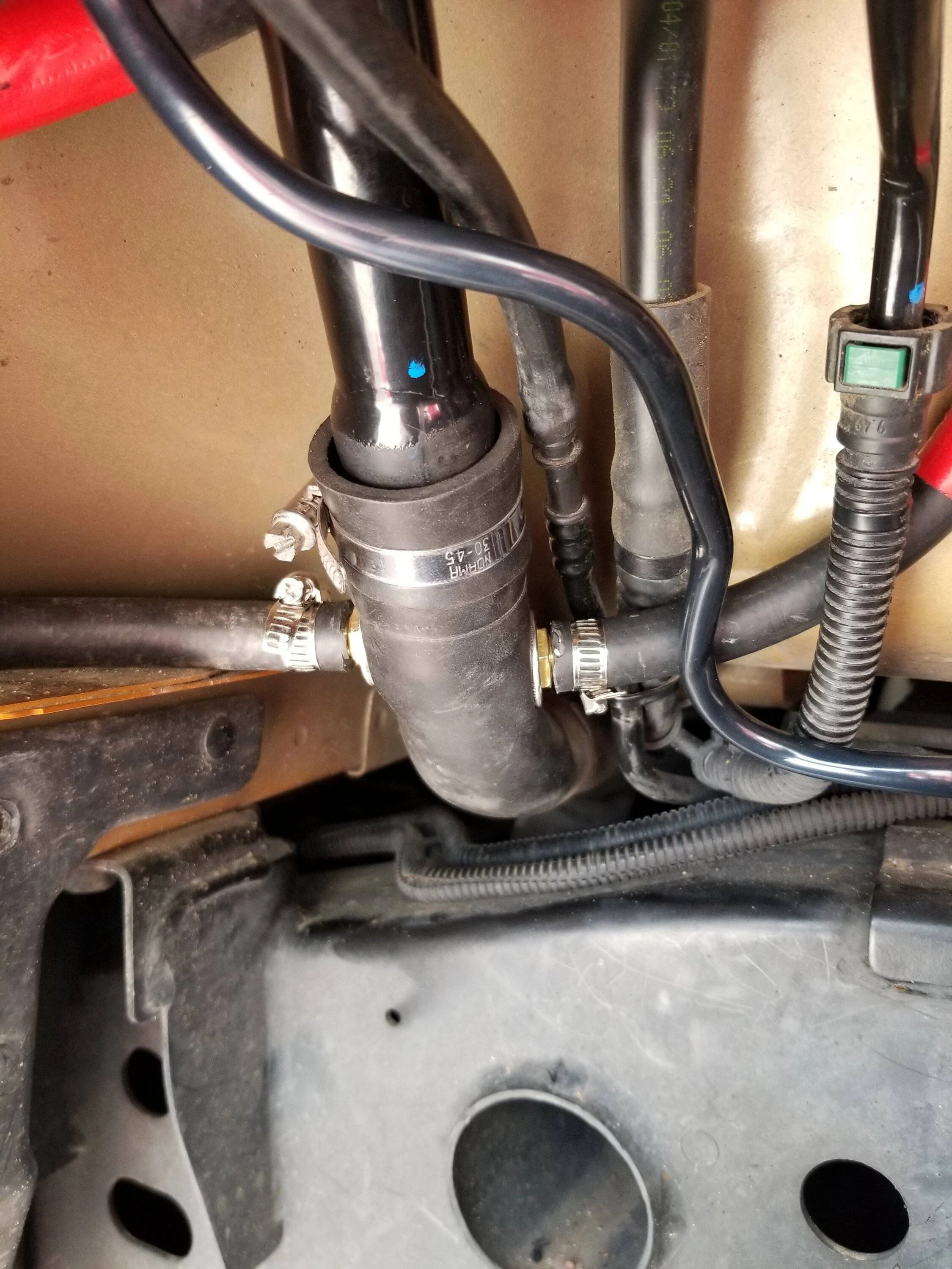

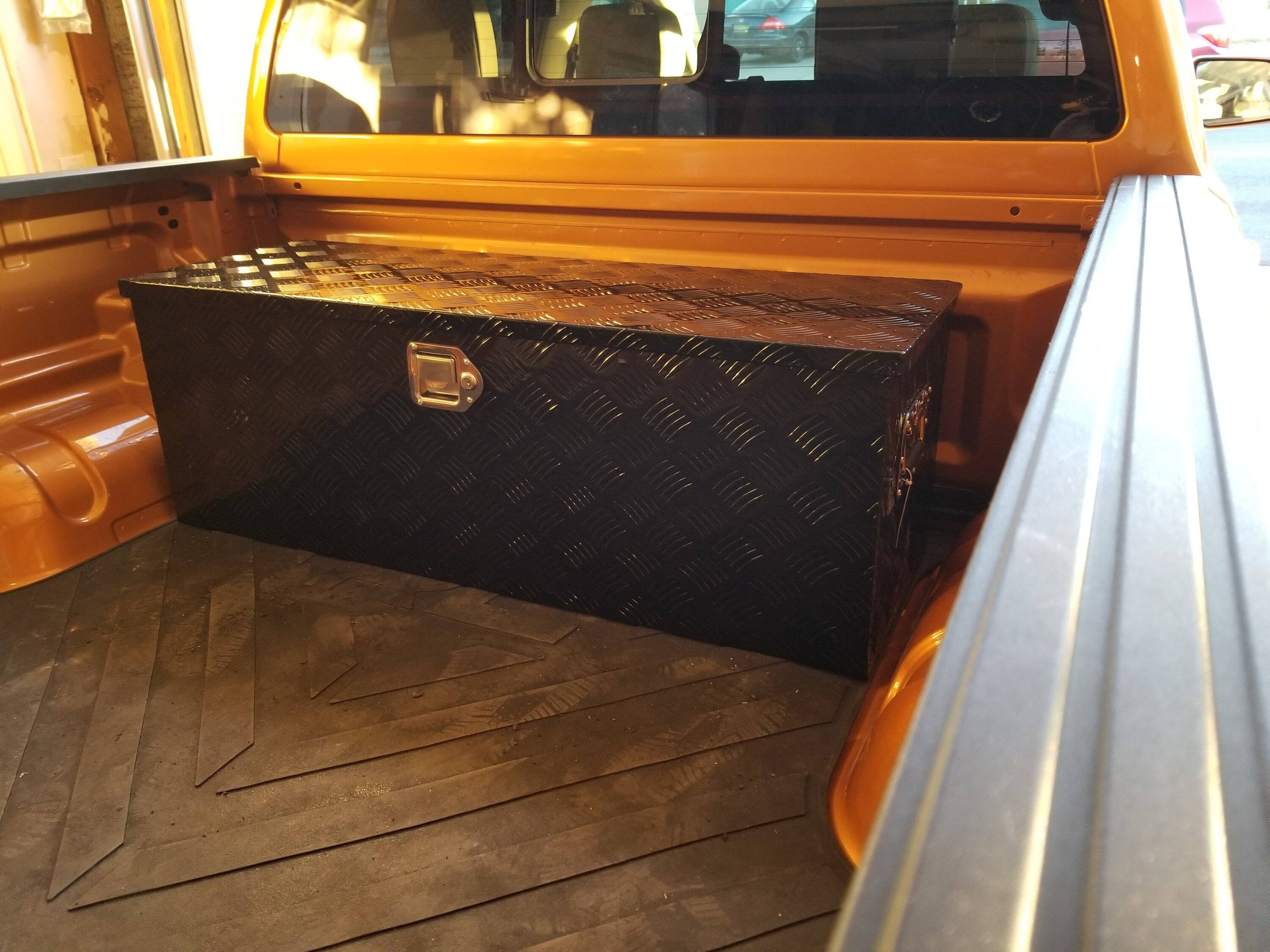

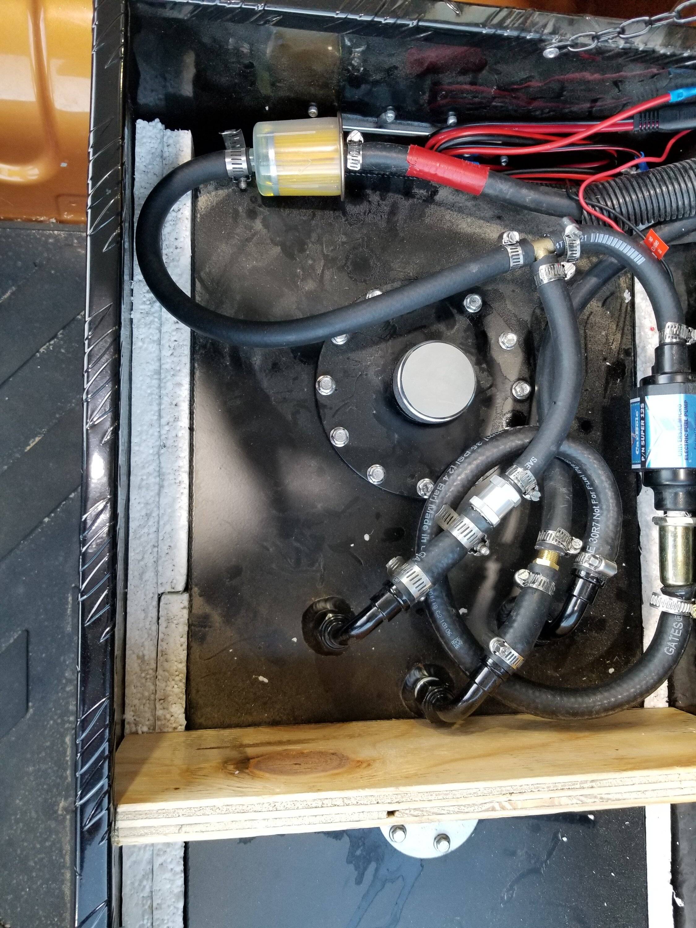

Finished plumbing in the aux fuel cell mounted in the tool box. Capacity is 13 gallons so gives me 31 total. Pumps into the filler neck and is vented there as well to keep the evap system happy. Last step will be wiring the fuel pump to a dash switch. I plugged it into my bed aux plug to test and check for leaks.
Looks very nice.
Any chance you will be doing a write up of the installation?
