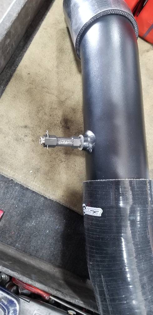

I am just starting my methanol journey; my setup will be a single AEM 500 cc nozzle with an 80/20 methanol ratio, I am inContact with ProMeth about the direct port setup for the ranger intake manifold and will keep you posted

When I was researching water/meth I read that a single port won't allow even detonation because each cylinder won't receive the same ratio of water/meth injection due to airflow. I believe it's very important to have 4 smaller nozzles as close as possible to the intake ports on the head when compared to a single larger nozzle before the intake manifold. The Boomba intake spacer is ideal. Food for thought.

Vitis I agree 100%, my personal plan is to get the system up and working then swap over to a direct port setup.

This is what I have come to conclude after much research. The Livernois guys talk about port injecting straight meth for inconsistent delivery. E30 might just be more convenient with similar results. I have run 24.5-25Lb of boost on the stock turbo with zero knock. 93 Top Tier fuel and e85 tested. just keeps eating boost.
Kit like this would be ideal. idk it it is a direct bolt for all models but I think it might work for the 2019 to mid 21's not 100 though

Without controlling the flow to each cylinder individually might the W/M mixture accumulate in the manifold and send the occasional slug into a cylinder?
That is the argument from some of the big tuners. I believe Livernois or Mount tune. The Manifold just don't flow well without direct to the port. Lets say you already have fouling and now run WMI and flow sludge into the cylinder even with proper port injection. That could be real bad. I agree. do the work right once.
Precision raceworks has a Spacer kit that looks legit. This is proper and should last a life time.
