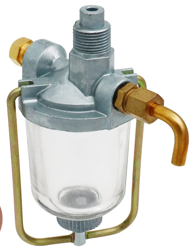

Looks like a solution born from pain meds lol. Replacement sensors are cheap enough. An inline filter might work for an air compressor. Not the paper ones, the ones that look like a pumice stone.
