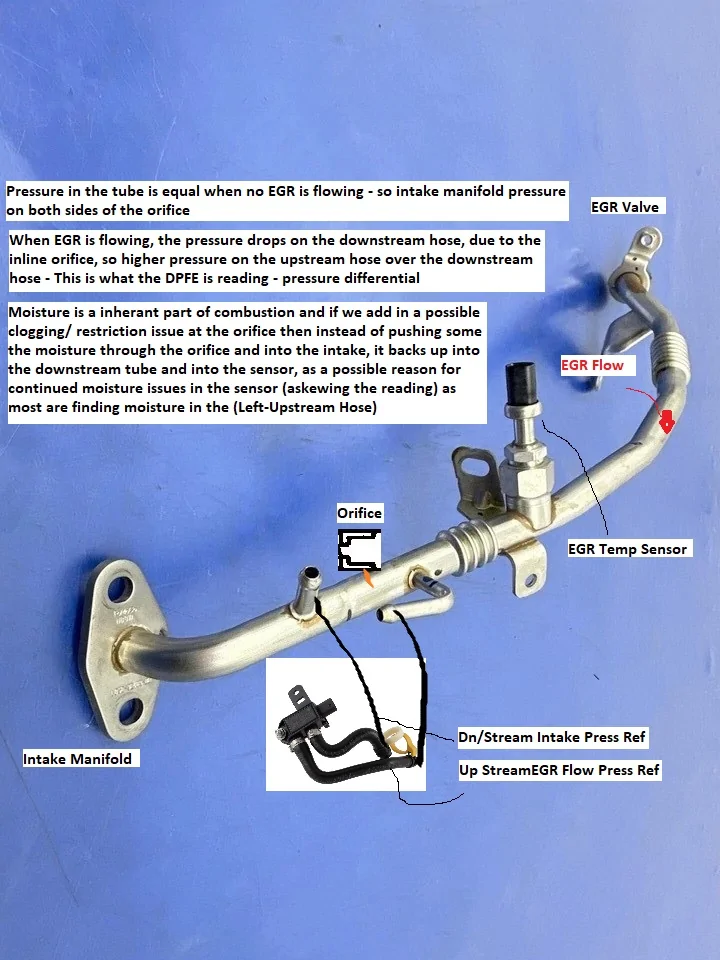

Interesting twist to this is Ford tech line is now telling techs to replace the egr tube with egr sensors for surging/bucking complaints before transmission repairs, finding condensation in egr tube giving part throttle misfires without code
Since I have never found a detailed pic of the EGR Tube Assy, I threw this together and (THINK) this may be why. IDK just playing with thoughts of operation as it has been asked more than once for repetitive issues after DPFE (Only) replacement, my thoughts have been the MAPT or this tube, but it does require a Live Data view to truly see what is happening.
I don't like Shot-Gunning parts but I have the proper tools to diagnose, most on here do not and only have Forscan, which lacks in this area.
So at this point - if Ford SSM ? (I believe) where the info came from then it appears they are finding a considerable amount of come backs with only the sensor replacement and a cobo of both is fixing the issue.
I am highly curios to see a cut open view of a (2.3 Tube), I know my past experience the carbon is very hard and hard to get broke down to remove it.
Side Note and a refresher: To understand the Tie in, Transmission (Shift Points) one input for that is engine load, One input of engine load comes from the MAPT sensor, when EGR is flowing the MAPT is seeing that flow, so if EGR is flowing at a greater amount than needed the shift points will also be thrown off.
A quick overview of the EGR Tube Assembly
9,603
45,988

Been thinking the same as for a filter of some sort inline. Kind of felt like if I did put some kind of filtration that it would affect the pressure readings, but I don't know. Everyone is obsessed with moisture in the system, when I replaced my sensor the third time I replaced the EGR tube as well. What i noticed is a lot of oil and a coked up tube. I didn't see any moisture. My thought it was oil that was fouling up the sensor not moisture. Who knows. just stating what I saw in my system.
