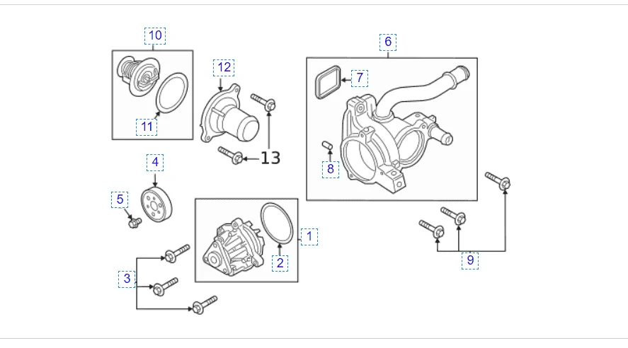

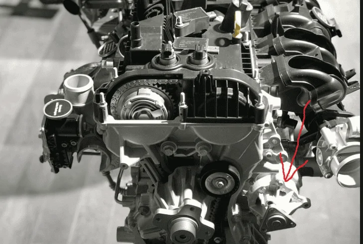

this is the parts breakdown, and if the photo is correct, its location on the motor
it's not internal.
Ok that's interesting it kinda off to the side. I would have guessed the water pump was in the center (4 hole pully mount) and I would have been wrong.
