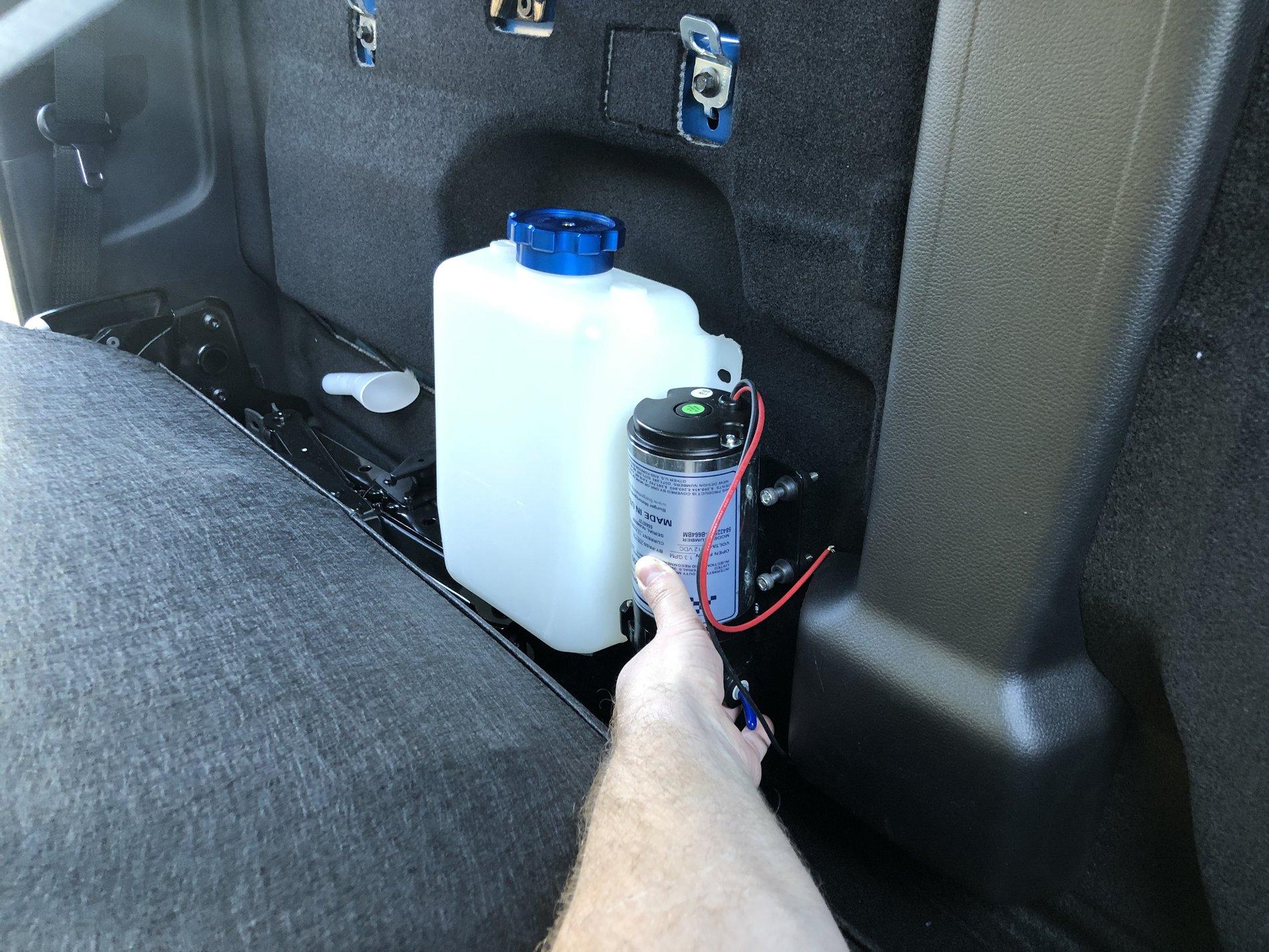

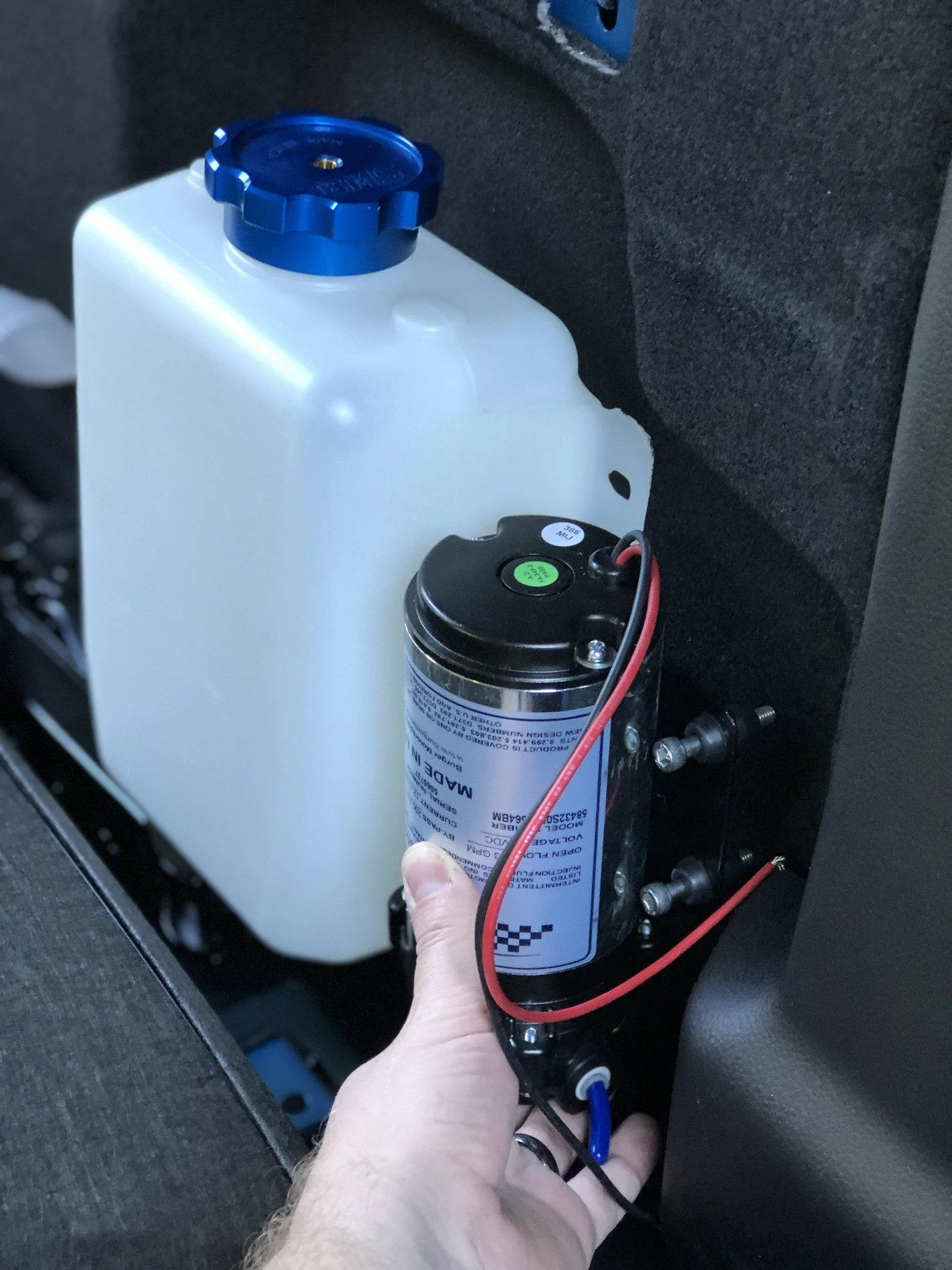

Op so what is your nozzle setup? I've been told port is the only way to go. Our intake manifold isn't the greatest design and reg nozzles around the throttle body would just cause pooling in Cyl 1 ?
