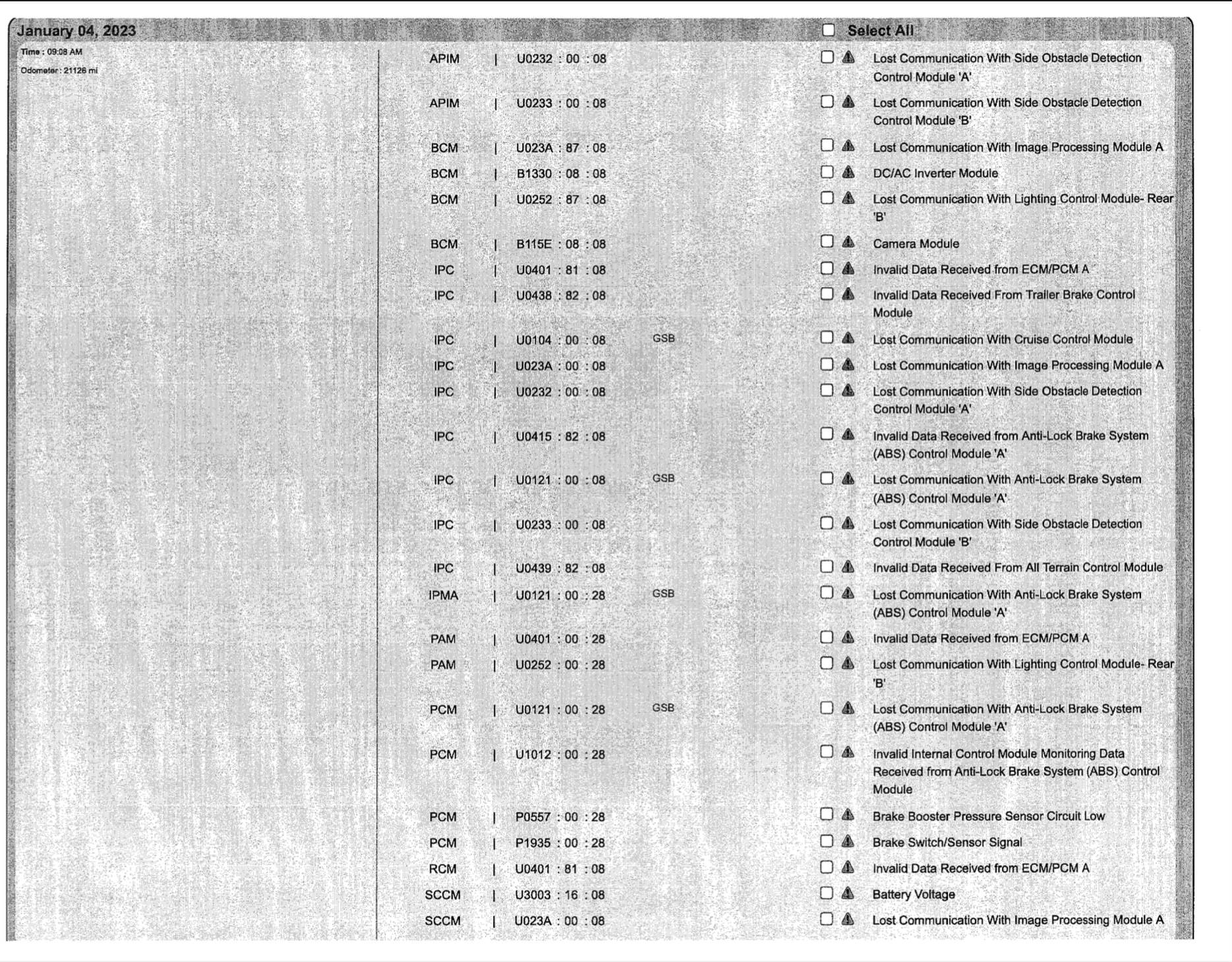

Just shooting from the hip here but when you replaced the battery, did you perform a BMS reset, to me it appears that since it all started with a low battery voltage, just maybe the BMS needs reset to tell the system that a new battery is installed.
Plus, when you have Forscan hooked up are you seeing any codes?
You may try a module reset of the BCM, PCM and TCU are any other modules that come to mind. Something appears stuck on stupid and needs a hard reset, unfortunately the modules have KAM (Keep Alive Memory) so a battery disconnect won't help, this is why the Sync Radio presets stayed intact.
If you have access to another Scanner other than Forscan, that can do a complete system scan will most likely cure your issues. (HOPEFULLY)

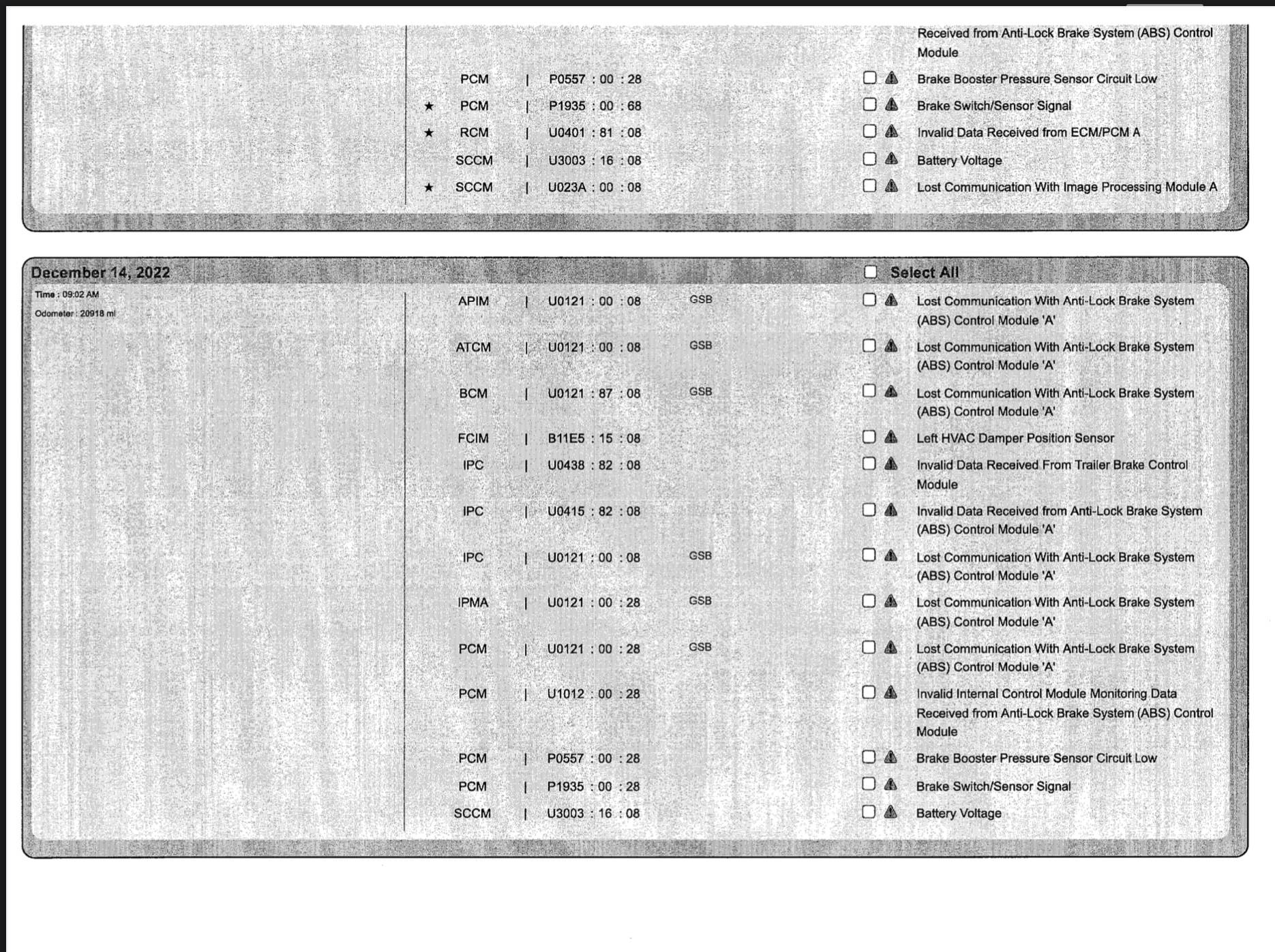

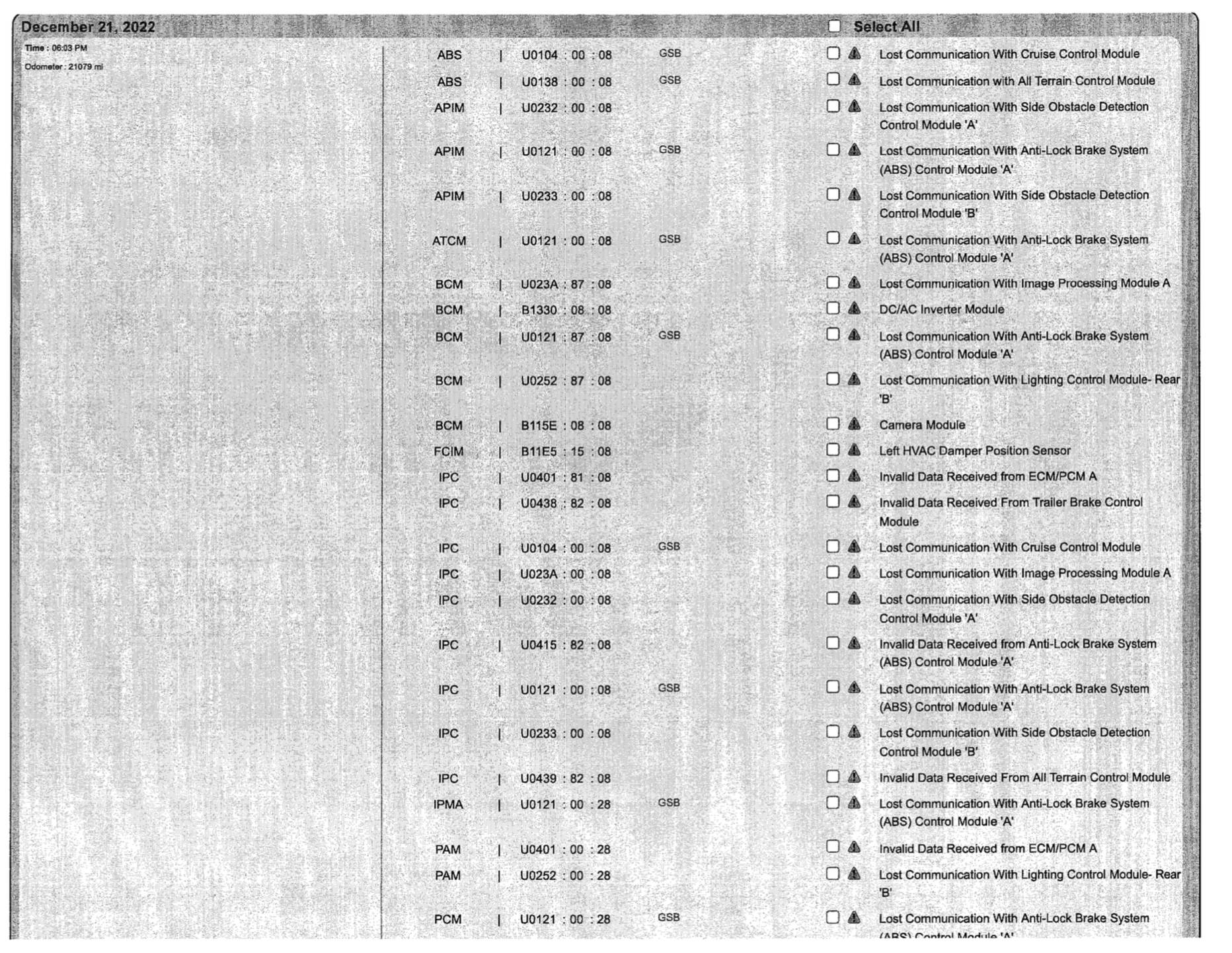

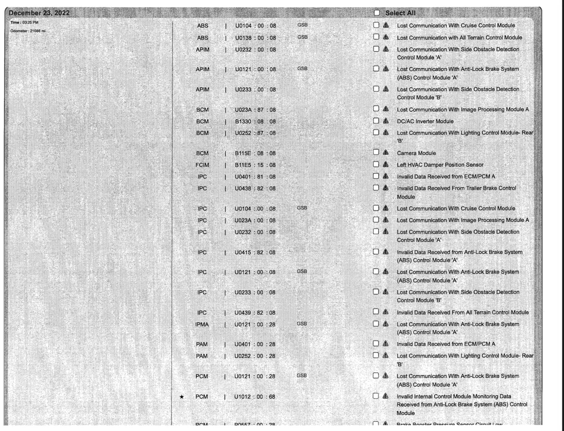

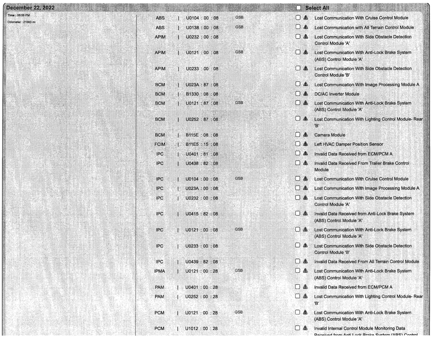

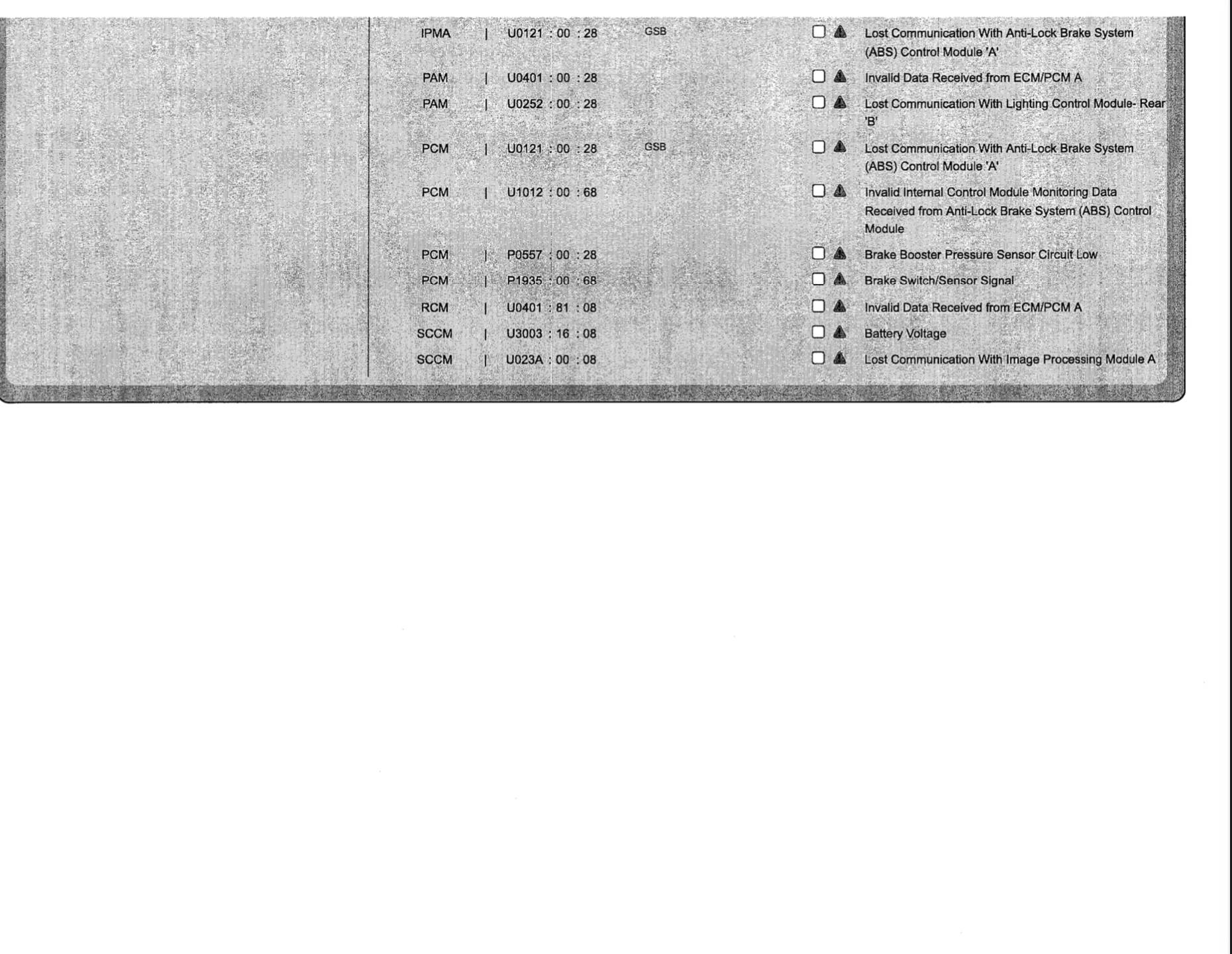

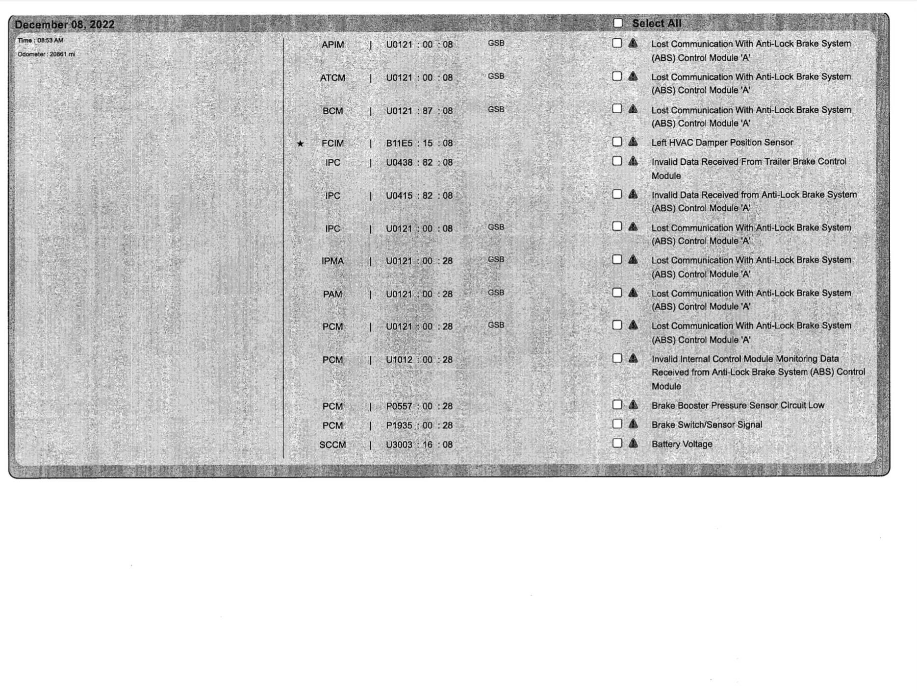

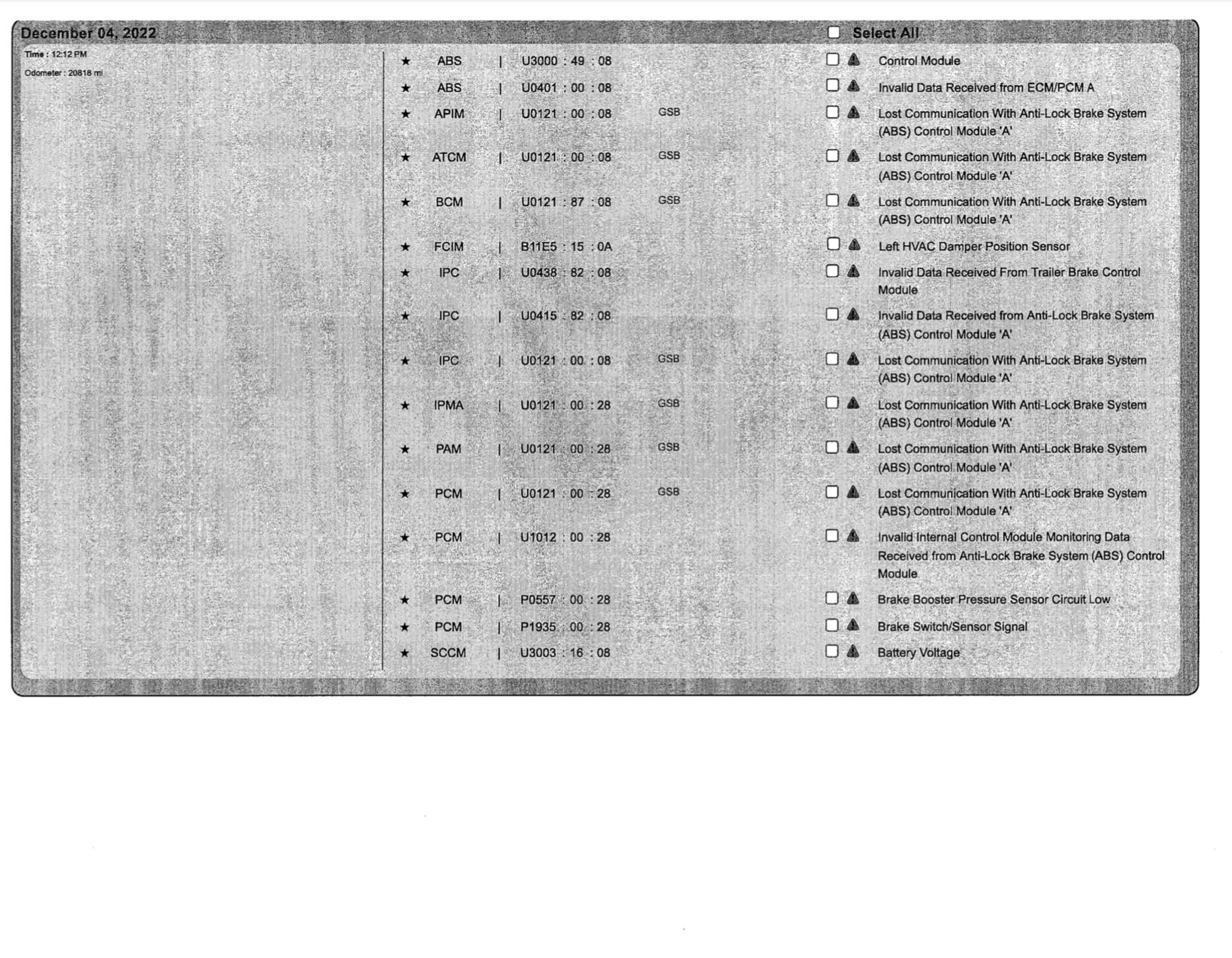

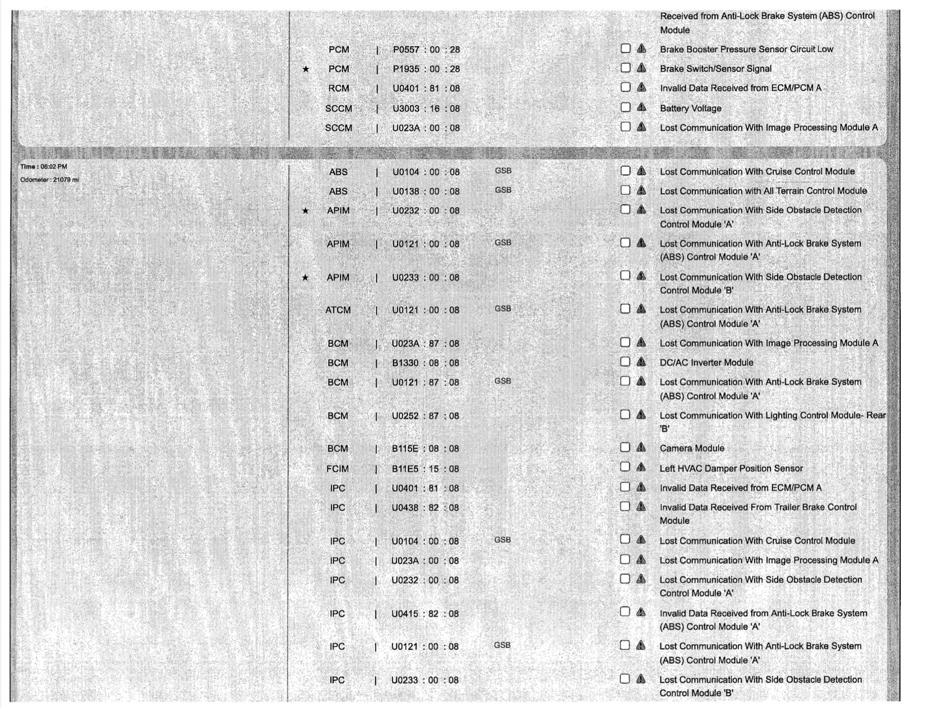

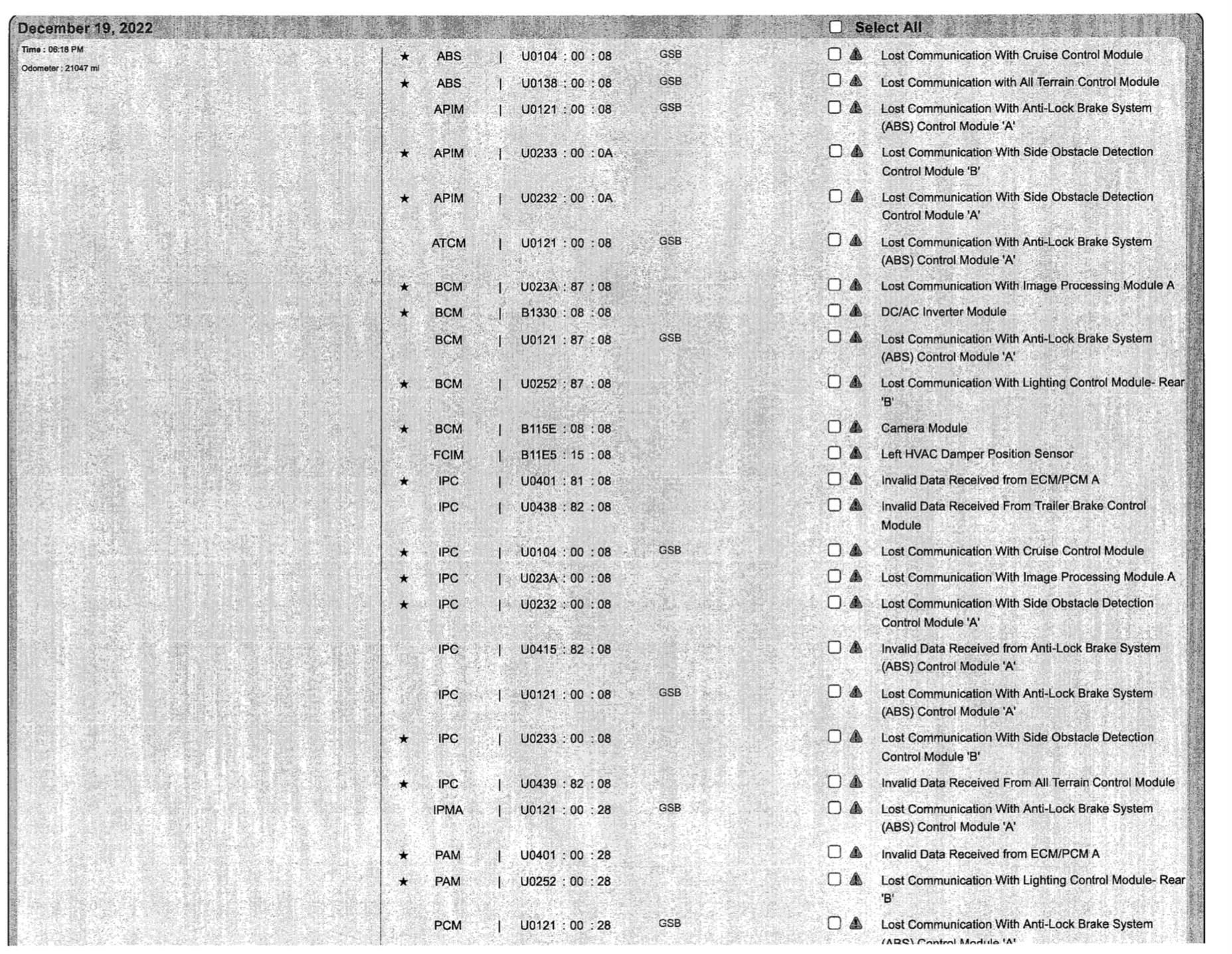

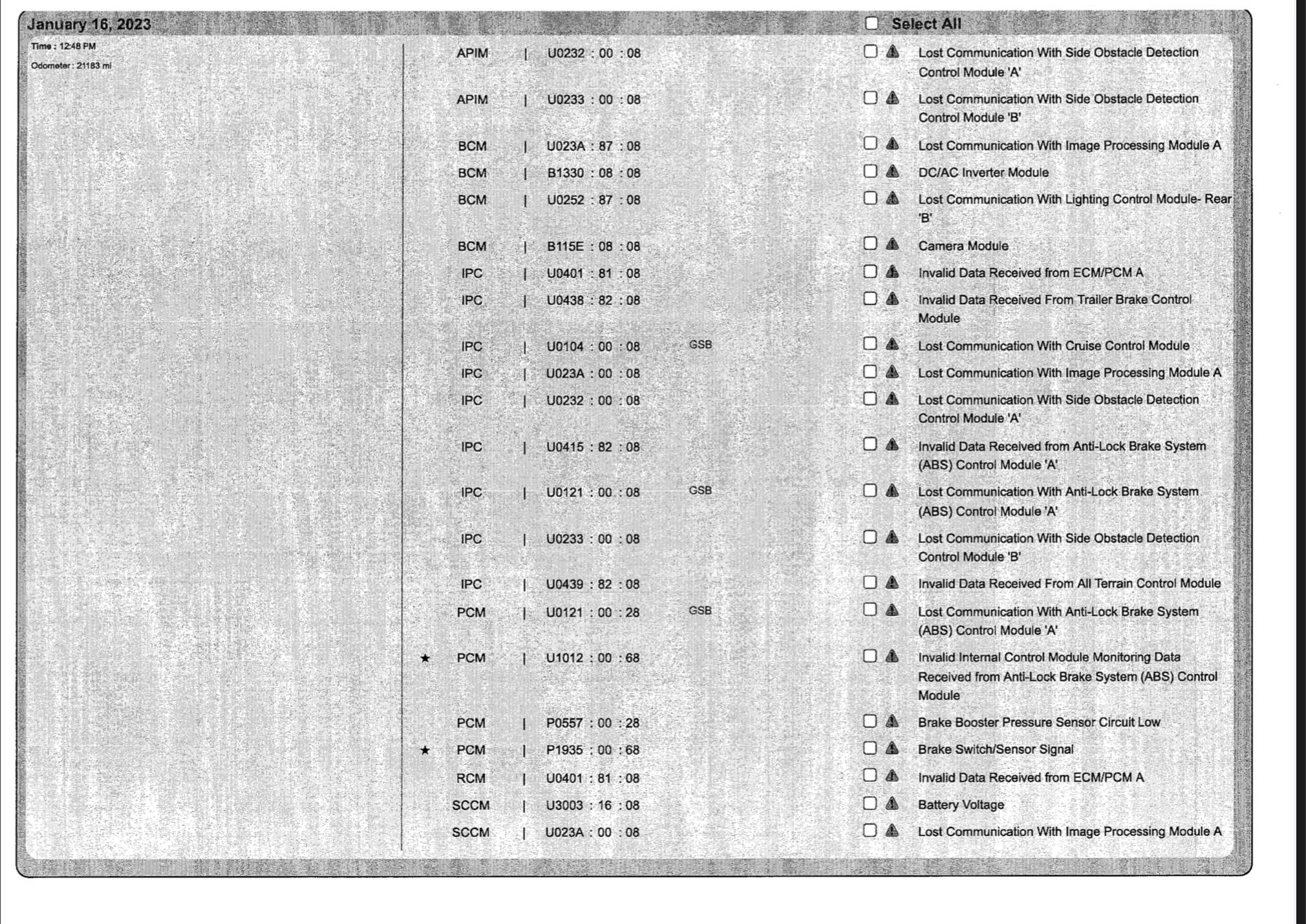

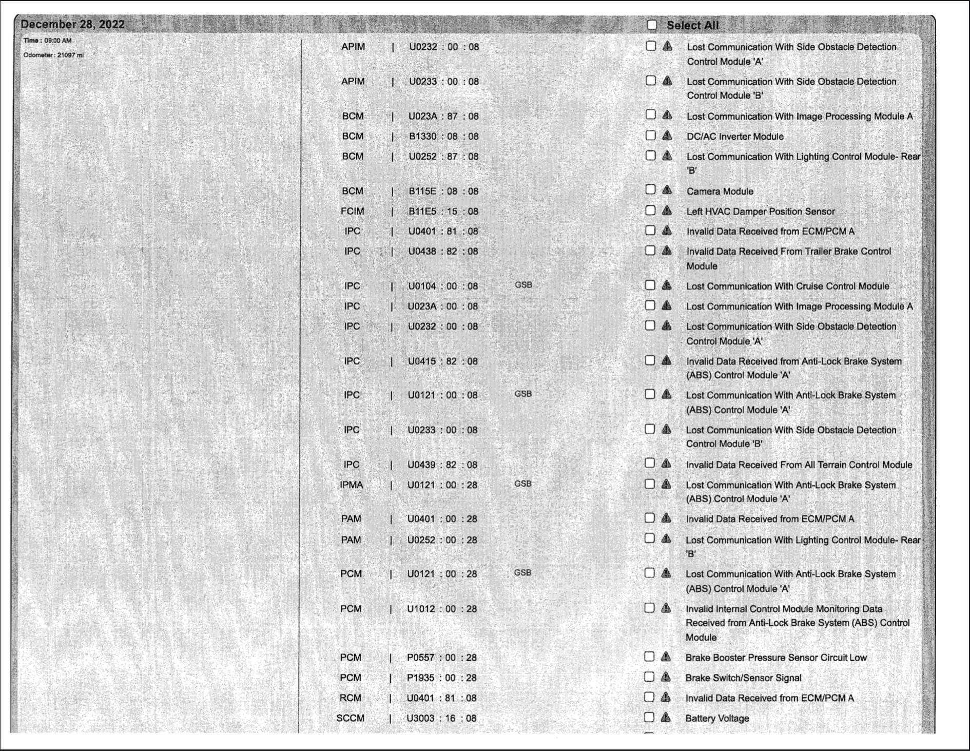

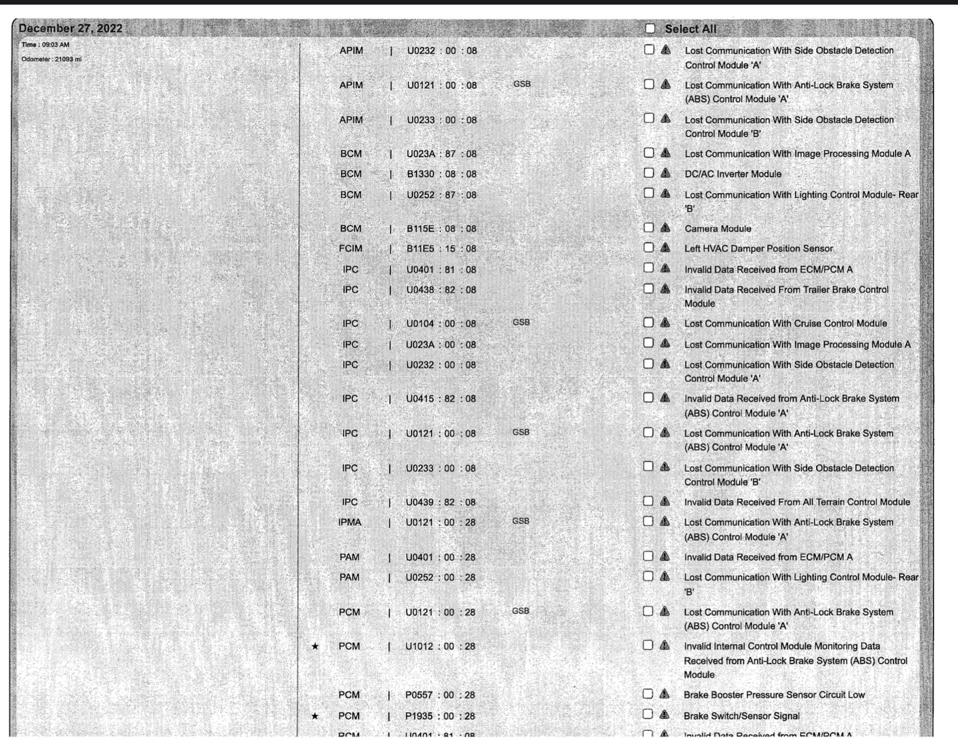

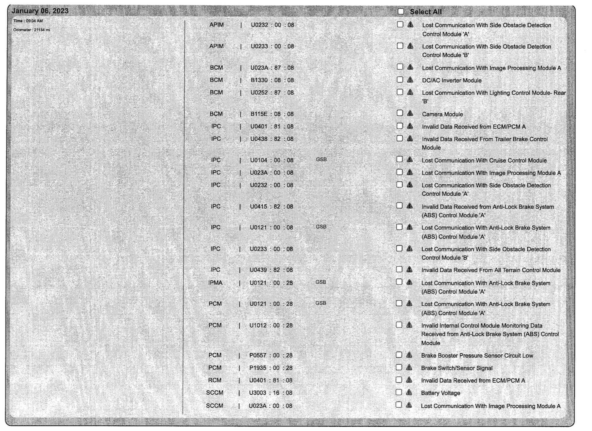

I did not perform a BMS reset, I probably should. There are no DTCs or anything showing up on forscan. I know there were a ton of them when the dealer pulled the data. I’ll try and upload the pdf they sent to me.
