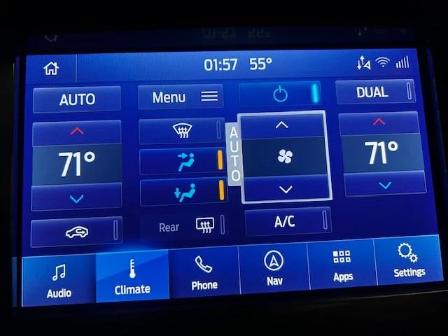

Which Temp? Is not displaying in this ref screen

It is the temperature (driver and passenger) on the top bar of the home screen. Not the screen you are showing. The drivers temperature setting normally shows just to the right of the home icon and the passengers temperature setting shows just to the left of the icons at the top right on the home screen.
