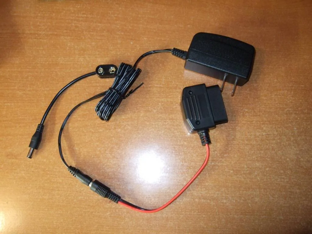

The second item was purchased quite a while back when I bought the truck. It is a small 12 volt adapter that is designed to keep your auto's computer settings when changing batteries. This means you must change the battery before a catastrophic battery failure occurs. You simply plug the device into a 12 volt port and plug it into a 110v wall outlet with a 12V wall wart PS. It keeps power to your systems while you switch out your battery. I bought it on a whim, and thought I'd never need it. I now need to find it and keep it in my 2020 Ranger. Here is a similar device available from Amazon.

The second item was purchased quite a while back when I bought the truck. It is a small 12 volt adapter that is designed to keep your auto's computer settings when changing batteries. This means you must change the battery before a catastrophic battery failure occurs. You simply plug the device into a 12 volt port and plug it into a 110v wall outlet. It keeps power to your systems while you switch out your battery. I bought it on a whim, and thought I'd never need it. I now need to find it and keep it in my 2020 Ranger. Here is a similar device available from Amazon

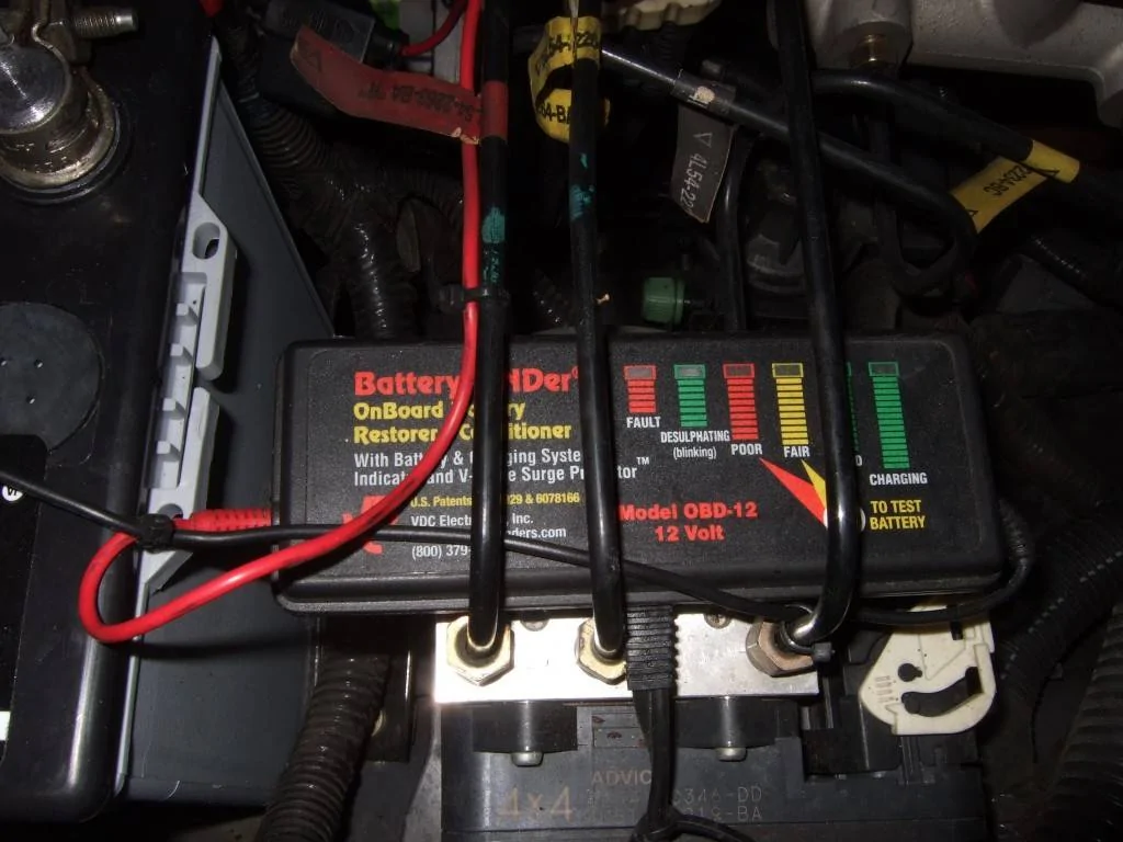

Yeah curious how this would connect. Maybe he’s got a pic? I’m used to a positive and negative terminal with nothing else attached. When I open the hood on this truck and looked at the battery I felt dump.

Here is a picture of the BM desulfator installed in my 2005 Ranger. It is sitting on the antilock brake module next to the battery. Nothing more than Velcro holding it in place. Been there for a very long time 10-15 years. I've lost track of when I purchased it. I just put battery #3 in the truck 3 months ago. So 2 batteries replaced in 17 years, and the first one went a few years without the desulfator installed.
